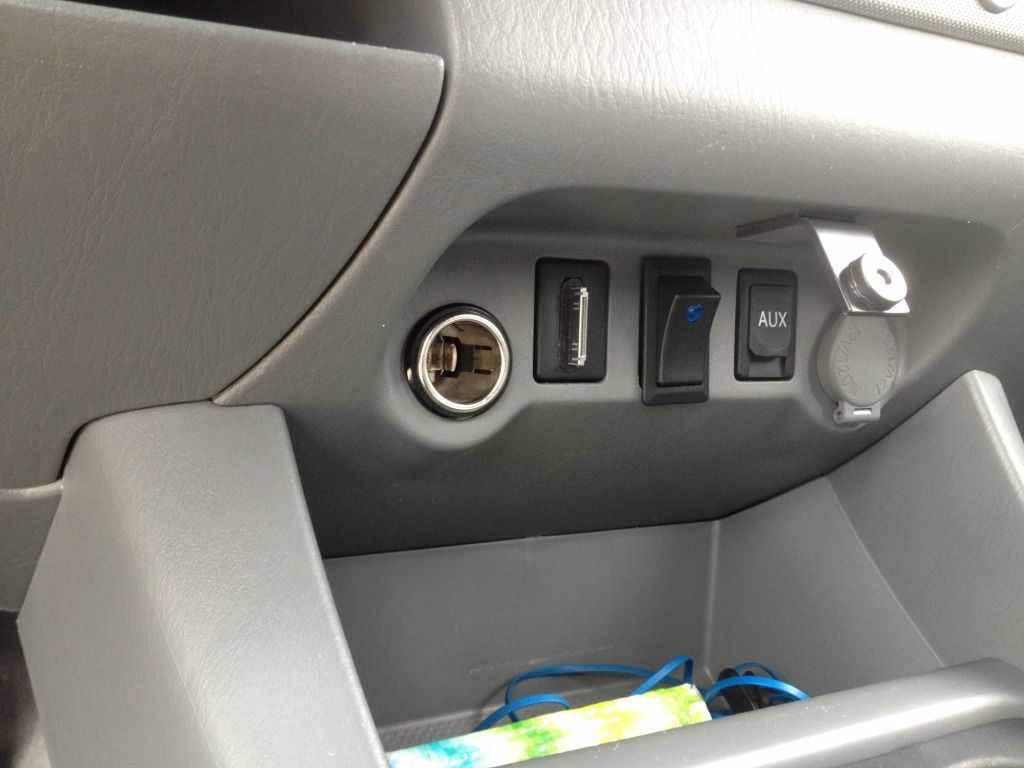

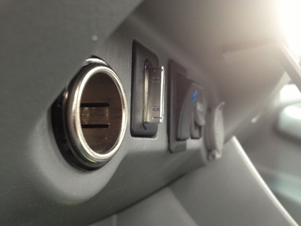

    I got board today and was tired of having to put my iphone in my glovebox where my headunits 30-pin connector is. Soo, i decided to make use of a empty switch cover and a Cablejive dockXtender

    So do you just stick your phone or ipod on there? Or is there a female to male 30 pin cord that you plug into it?

    yeah my cablejive dockXtender is 2ft long. so i just plug it into the port i made and i have 2ft to move my phone around. i just wanted a cleaner install than what i had before in my glovebox. My head unit only has a 30-pin connector, no lightning yet. I plan to take out the stock AUX jack in that same row and put a lighting plug just like how i installed the 30-pin once i decide to trade in the 4s.

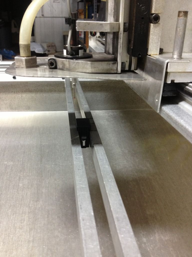

    ^+1 for you, that came out so clean. I wanted to do this months ago but i couldnt find that cord. I will probably attempt it by drilling two holes for the ends and cutting inbetween them with a dremel. I actually have a cnc, but its a poor mans DIY cnc made for carving wood.

    It makes everything much cleaner! And to be honest drilling and using a file would work just as well. My cnc didn't cut deep enough so I filed like crazy. It was a tight fit to make the male end of my cable fit. I just filled the back with plastic epoxy.
