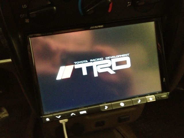

Finally got my splash screen changed from the boring blue Alpine screen to this (sorry for the crappy cell pic but you get the idea):
from this wallpaper:
to this on my truck:

That's nice!
Care to share with us on how you did it?

Yeah, wheres the link to the forum you used? I want to do the same to mine.

The Alpine rep at my local car audio shop installed mine for free but didn't give me a zip file.

Found this thread while googling how to change the splash screen on my Alpine INE-W927HD. I ended up finding the procedure at a Porsche forum. It worked perfectly. I used to have a Tacoma and was registered here, didn't wanna leave any of you guys still looking to do this hanging. Here's what I found:
"Here is the sequence:
1) Put the splash screen image on the root of a USB memory stick. The filename should be: apn_pa_opening.bmp (all lowercase)
Two things you need to know. First, make sure the image is 24 bit bitmap (BMP) format. The preferred size is 800x480; if you use a smaller size, it will center it as best as it can. Now if you want it to work, you should take your desired image and save it into 24-bit BMP using Microsoft Paint, the crummy Paint program that comes standard with Windows. MAKE SURE TO USE PAINT -- for some reason, the Alpine firmware is very touchy and needs the Paint format. I have a Mac and used a very good file conversion software utility to convert my PNG image into 24-bit BMP, and the Alpine didn't accept it and locked up with a "Please Wait" message. Windows Paint is the standard, so use that and make sure it actually reserves the image in that format. If you have a Mac like me, borrow a friend's Windows machine and use Paint to resave it into 24-bit BMP.
Second, make sure the USB stick is formatted as FAT32. If you format it in Mac format, for example, the Alpine won't recognize it. Same with older formats like FAT16. You can do a "properties" on the USB drive to see its current format; if it's wrong, reformat it as FAT32.
2) Turn on your Alpine, plug the USB memory device into your USB port. (There does not appear to be any desired order here; you can plug the USB in before powering up, doesn't seem to matter.)
3) As others have mentioned, press the BAND soft key (on the touch screen) for two or more seconds. You will find this by setting the current audio/music to either FM or AM band, and the "BAND" key will be on the screen.
4) Press the NAV/AUDIO split screen soft key (on the touch screen). This will move to a split screen mode, obviously.
5) Press the PHONE key (hard key); on my unit this is a physical key on the bottom.
6) Press the VOLUME DOWN key (hard key); again on my unit this is a physical key.
If it works, you should see a "Please Wait" message pop up on the screen a bar or other progress indicator. If the format is correct, it should keep that message up for three or four seconds, and then reboot the head unit, and you will see your desired splash screen upon startup. "
Hope this helps. Also, I saved my file using Paint Shop Pro 7 and had no issues. So, don't take his "Only us MS Paint" thing to heart.
