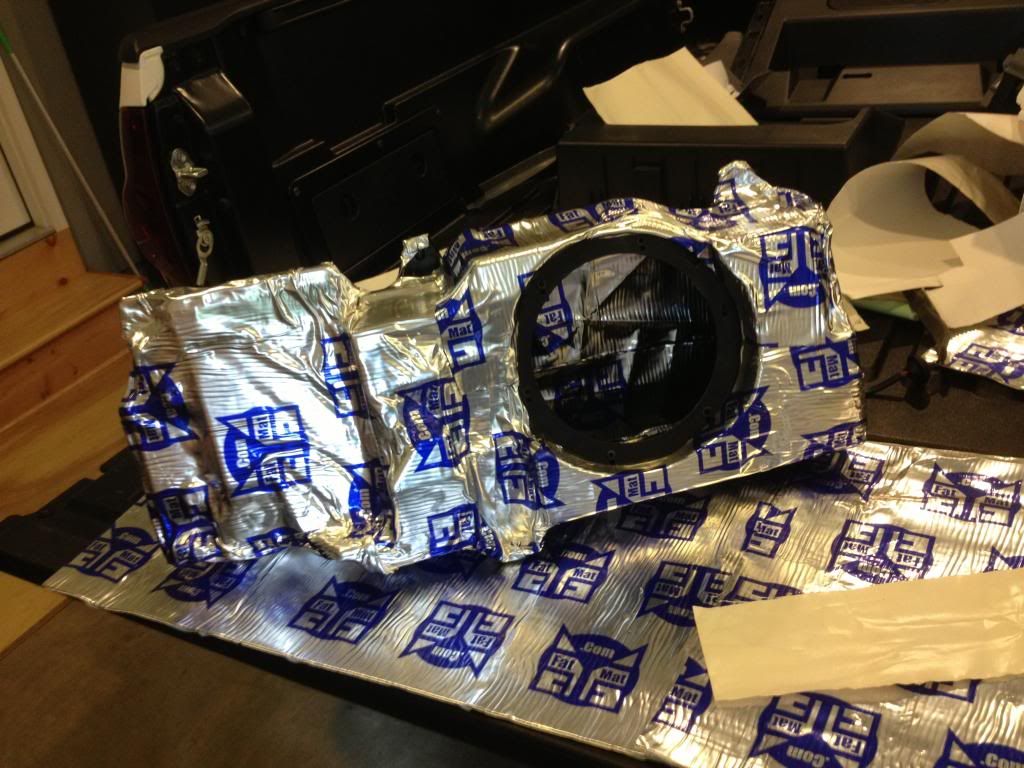

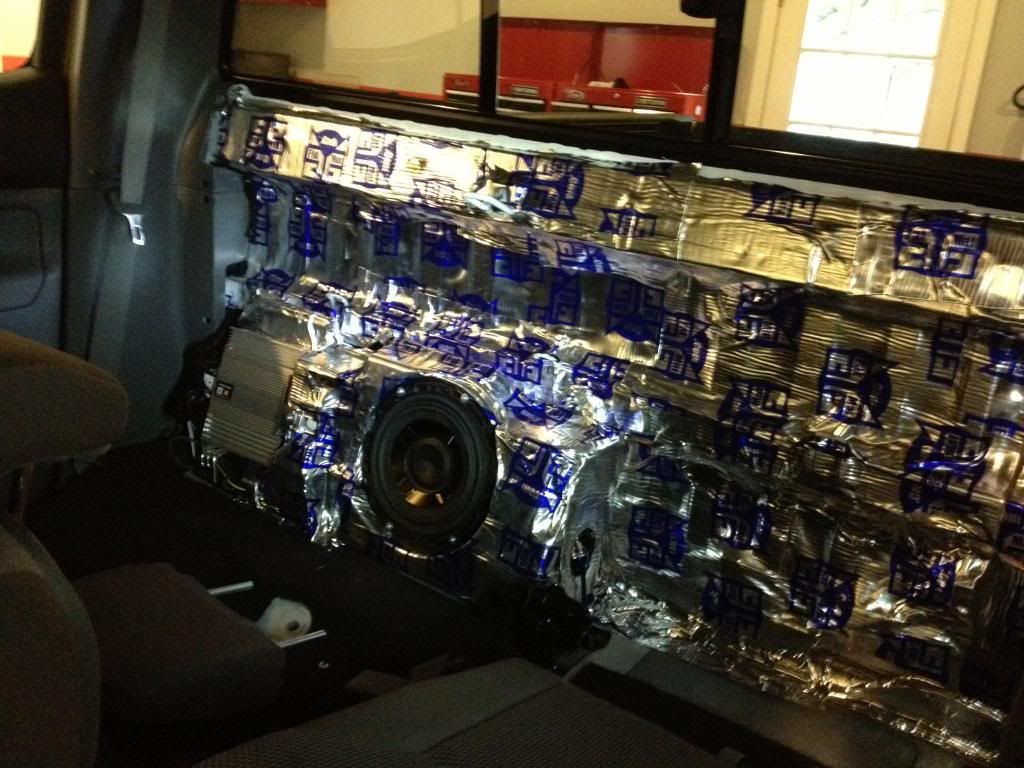

    So my first step was sound deadening. I just couldn't stand the rattle from the sub area at even half volume .

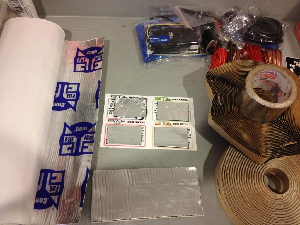

    I sampled GTMAT ( all 4 types) , Fatmat , and milla mat . I chose Fat mat because it was the stickiest out of them all and the easiest to work with and bend . Im really pleased with the fatmat.
    I also used thick rubber double sided tape and all of the plastics, and alittle clear RTV on the plastic clips . Even used the double sided tape inbetween the plastics that cover the rear of the back seats. ( I know some remove these but double side tape did the trick )

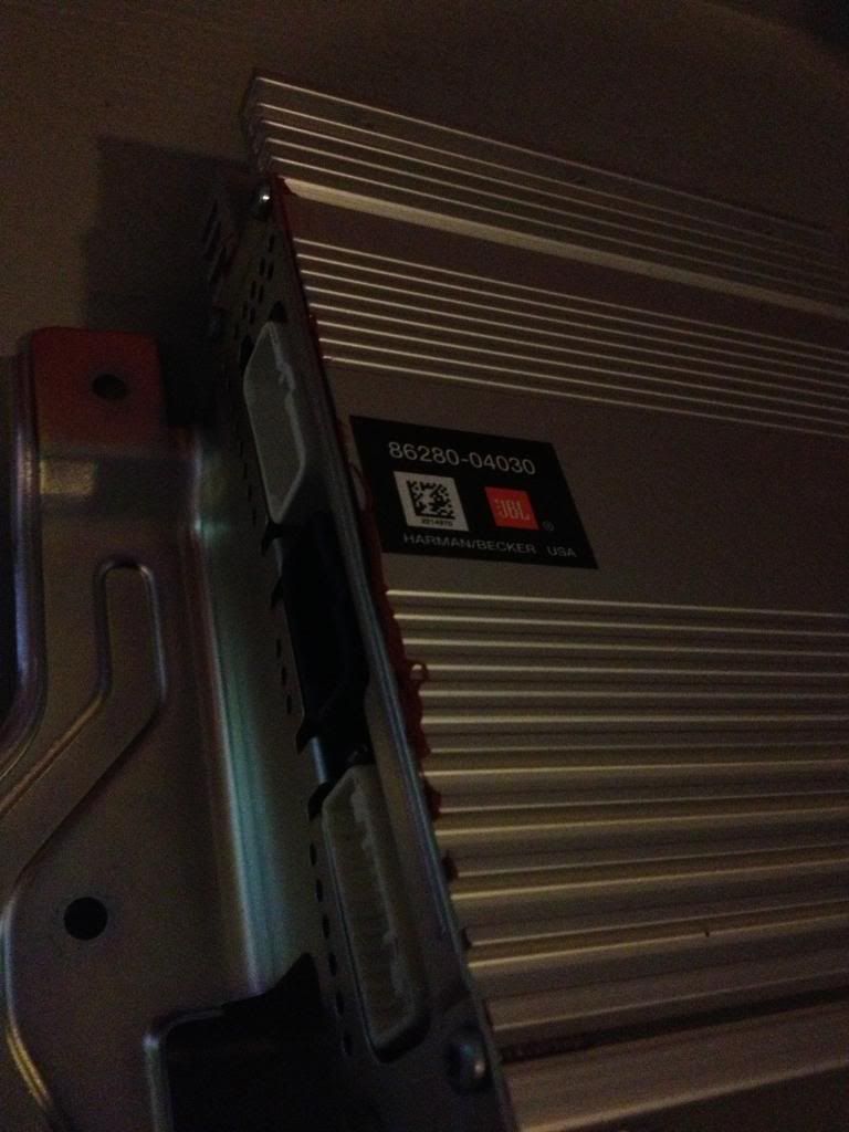

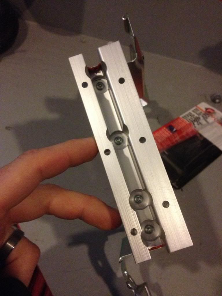

    The jbl amp brackets also rattle, I took it apart and used some high temp RTV. Theres a bracket that attaches at the top of the amp I determined is the cause of most of the rattle. Once you take it apart and see the bracket that attaches to the screws below you'll see what I mean .
    I also wrapped the JBL box.

    heres my amp , 2013-06-16162241_8fe180b99972f4ceafa6f3e2958120dd1e956715.jpg
    -Overall verdict, all rattles and gone and I get nice clean bass. Not much bass though considering all the work. Now this is very involved and time consuming process , But with all the rattles and lose plastics I didn't want to just add subs. That would add bass but Im also looking for quality bass. The other benefit to my setup is I now can turn the bass way down on the headunit and the door speaks sound 10x better, I havent gotten around to upgrading those yet.
