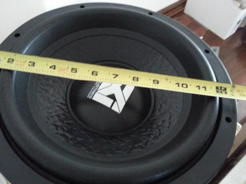

I tried to make a ported enclosure for my truck, and blew one of my 10" Sundowns. So, after shipping it back to Sundown, and getting a new one, because I'm sure they won't cover burnt VC's, I forgot to set the subsonic filter on my ported box. So I decided to go a different way.
This is going to be a sealed build, with .75" MDF, with a space in the middle to sink my amp into. It's also going to require some thinking on my part, how to get this to fit behind the seats of my DC. I'm thinking cutouts and fiberglass, and plenty of wood glue and screws. I'm probably going to build the box "in" the truck, piece by piece, carefully measuring and cutting as I go. Also probably countersink the sub in the box, to cover the Xmax of 20mm of the subs. 1500w and 2 12" subs, a beautiful combination.

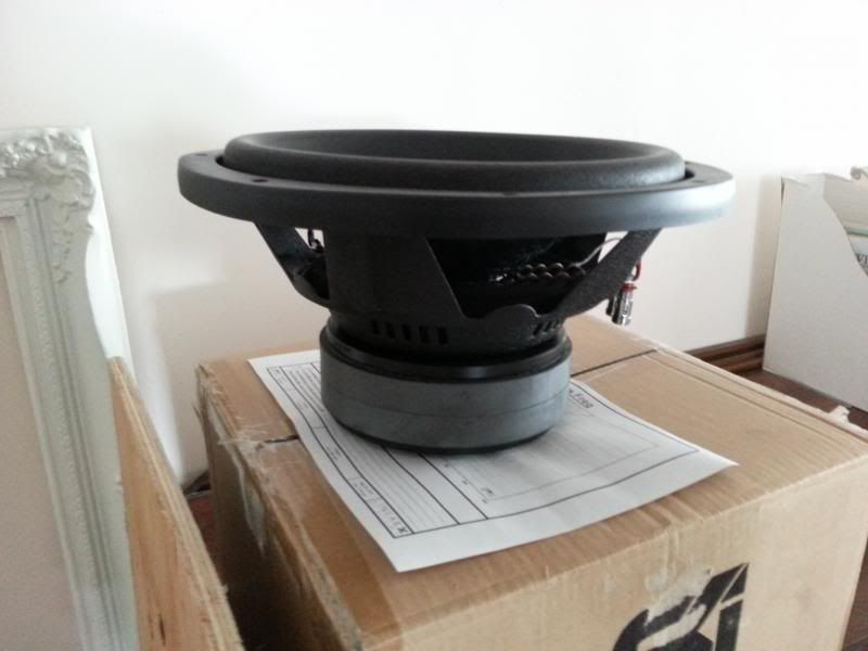

Not sure you can get anough cubic feet of space for 12" subs with the amp spot in the middle. I ordered a premade box off Ebay for 2 sealed 10" subs and I did not install the amp there because it would make adjusting it a pain in the ass.

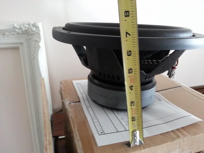

Also, I think you will need a shallow mount speaker as my 10" subs could not go deeper than just under 5". Here is my box (amp is under the passenger seat):

I test fit the woofer before purchase. The magnet will clear even with building around the brace, and I plan on countersinking the amp about .75". What my main concern is, is will I get the depth I need? I'm thinking about a cutout on the back of the box, and fiberglassing the hole. I'm actually planning on building the box IN the truck, to maximize my space, and if I have to, stuff the box a little, to get the 1cu.ft. that's recommended for each sub. Im still in the box design phase though, as I plan to add a more powerful amp to my front speakers, and need a place for the distro boxes to go. When I start, I plan to take many pics, and post them up, to give everyone the hope that 12's can be had, with a little effort.
I've had 6" subs before, 2 JL Audio 10w3v3's, in a premade box from Supercrewsounds. What they did is cut a hole in the back of the box, and cover it with .25" MDF. I'm thinking fiberglass, because these subs will see 1500w on a Sundown SAZ-1500D. The amp is 14" long, so I plan to mount it vertically, and use spacers on the locking hook for the seatback, to push it forward a little. That should give me space for the amp. I'm just deciding if I want to go with just the positive distro block, I have the Sundown grounded all the way back to the battery, or go with pos. and neg. on the back wall.

These aren't shallow mounts though. They are 6 1/8" deep. That's why I'm building the box in the truck. To maximize space for these things. I'm also considering an amp swap, to an Alpine PDX-M12. The space savings will be considerable.
