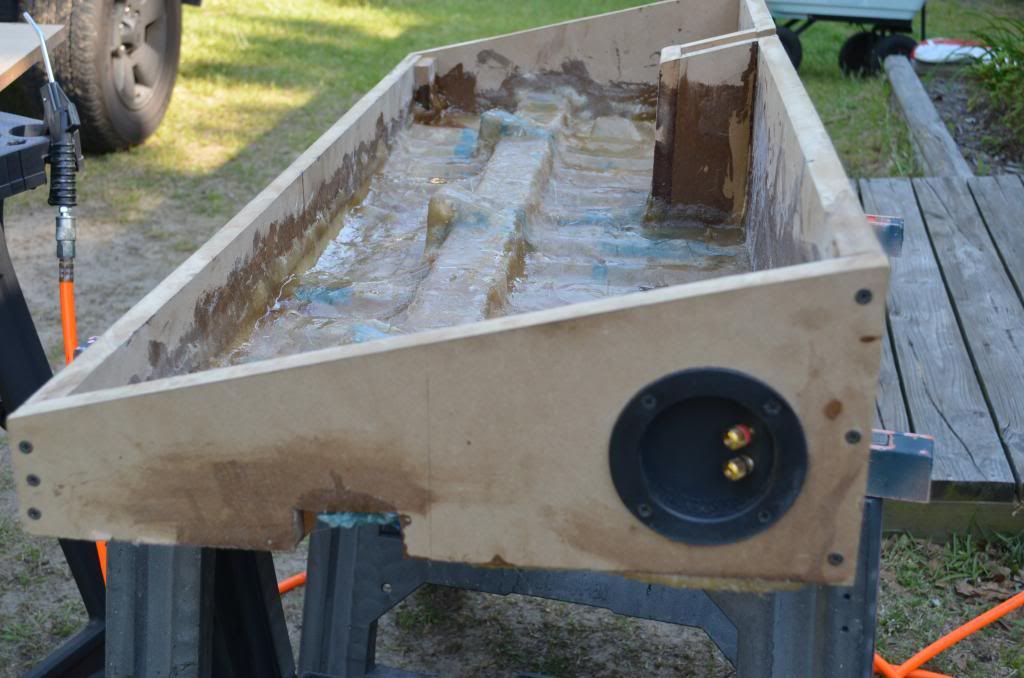

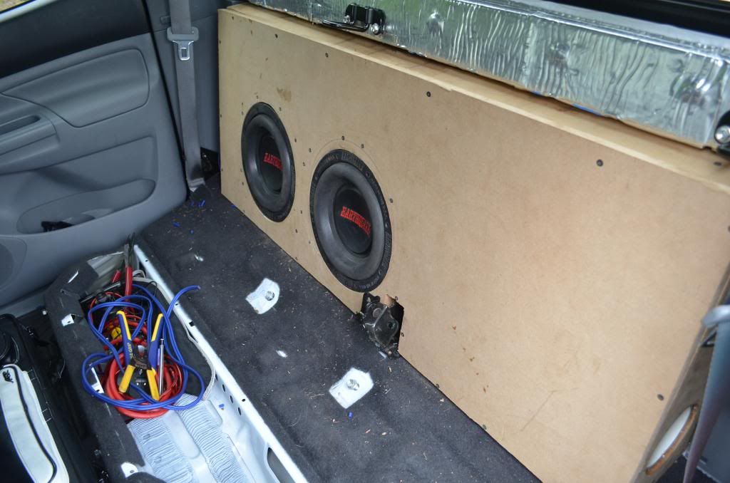

i had 2 10 inch earthquake dbxi dvc subs in my scion tc and when i traded it in for my tacoma. originally i had both subs in a sealed box on the back seat, finally got around to building an actual custom box for them..
first off what i have
2 earthquake dbxi-10d dvc 10s wired to 1-ohm
1 earthquake ph2000w-d1.1
kenwood ddx-419
true 4 awg power wire
knukoncepts krystal 2m RCAs
knukoncepts fuse holder
knukoncepts

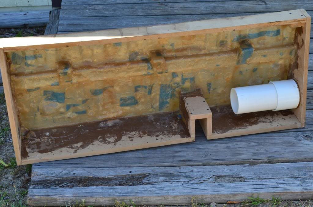

custom behind seat box with 4 in port tuned to between 37-40 hz (not sure what the exact volume is so its in there)
subs are flush to box still need to carpet but making sure everything's tuned properly before hand and i dont need to change anything....
sound dampener

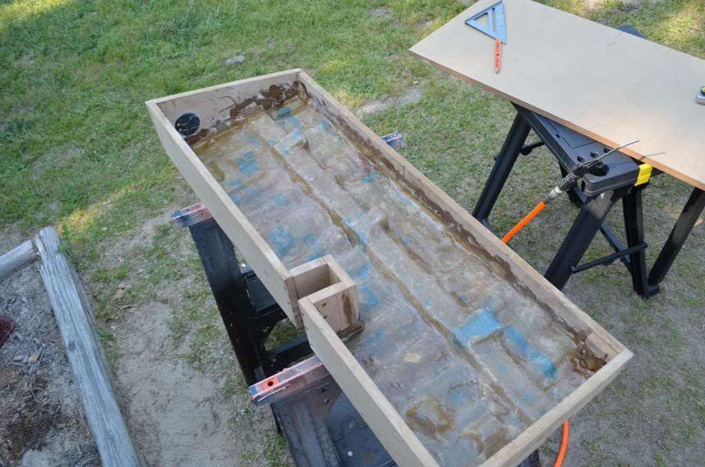

dont have any pics of the fiberglassing but heres the after
wire ports
with port
finished project

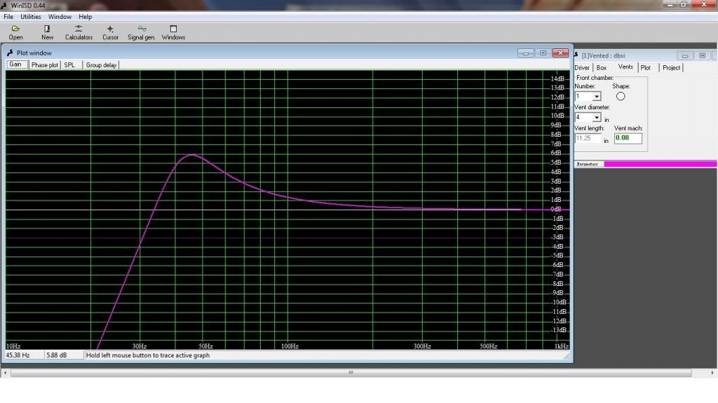

heres my graphs tuned to my box at the
gain
phase plot
spl

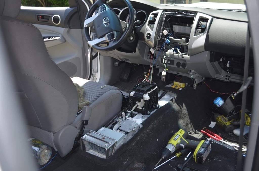

moved amp to under front seat barely fit ill post pics of the amp later but heres the car tore apart

how did you come up with your port area?

i used winisd you can use a preset sub or put your sub info in to get a better idea of what your going to get. you put number of subs, box volume, tuning frequency, and diameter of desired port. this will give you a vent mach and a port length... you want your vent mach to be less then .15 so you may have to play around with the port diameter and frequency heres an idea of the setting you will enter

plus forgot to mention at the start of this 4 weeks ago i was cutting my boards and hit a wet spot in the mdf board flew off ripping my pinky off and slamming my hand back on the blade cutting my medial nerve one of the two arteries so ive built this one handed

What is your actual mounting depth after all was said and done?

what mounting depth are you referring to the subs mounting depth or the depth of th box

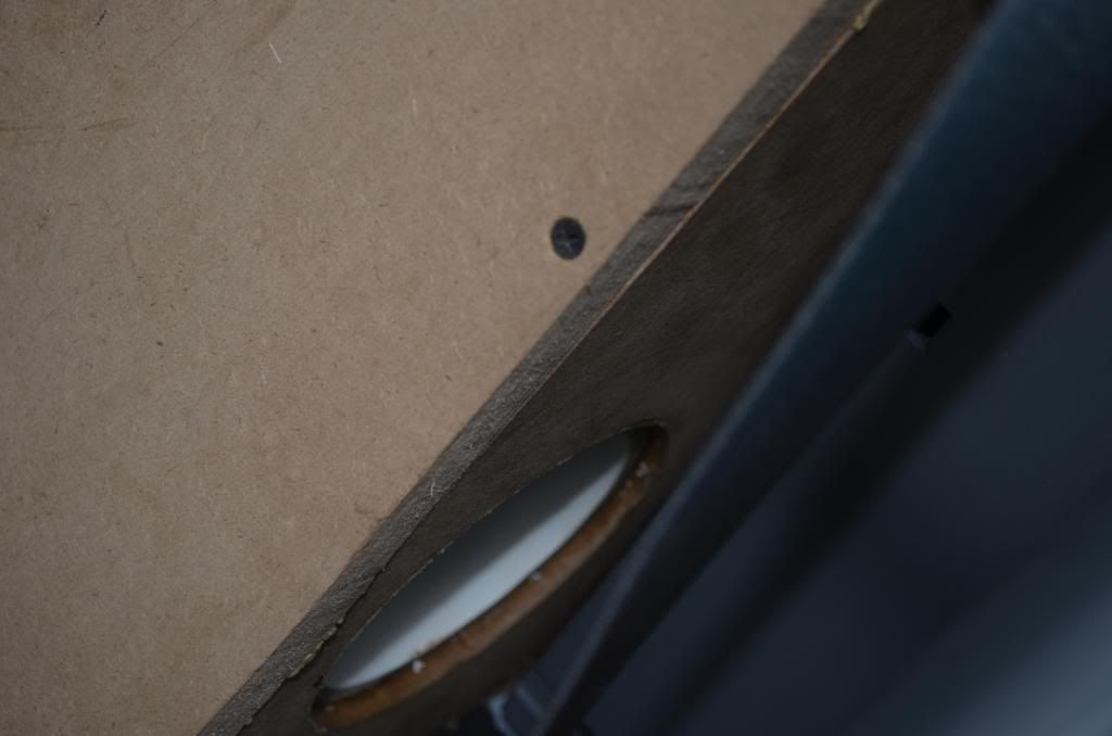

i love it the only problem i have is it flexes the piss out of the back wall/glass when its really hitting and it can get annoying but with the seats back in it has just enough pressure to help limit that
i put a nut on the inside of the bolt for the top clips on the seats to bring it out about 1/4" and had to remove the black plastic backing so the subs would not hit them i clear the back of the seat barely but with a 1.5-2" excursion thats expected sitting in the back seat is an amazing massage
