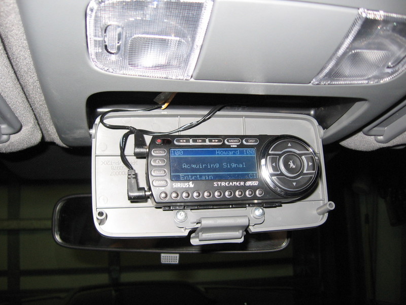

Here's where I mounted my reciever. Very sanitary install.

looks good, where did you mount your antenna? Did you use velcro or double sided tape?

If you look just above the rearview mirror you see the Ant'.
