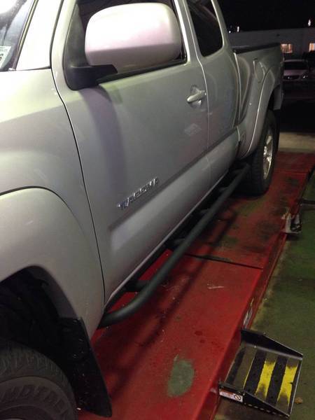

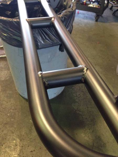

    Thanks to Avid Off Road. Just received my sliders this week. I painted and installed them today and they bolted up with no fitment issues.

    THIS! still nice but will be like other steps and bolt to the cab so not really the best for off roading.
    If you want them for off roading I’d advise you not to get these particular ones. They bolt to the cab and not the frame. They wont support the truck like ones that bolt to the frame. i’m not sure if avid dose or not. but i know other make true sliders that bolt to the frame and are strong enough that you can use a high lift jack and lift the whole side of the truck up off the ground.

    Avid made it clear that these are just steps. They only offer either a weld on slider or bolt on slider( that is what they call them) which gets bolted to the cab like the pictures show. Don't worry I don't intend to bash these against rocks just wanted to let everyone know my experience with avid. I actually thought it was a good idea since i dislike the look to side steps but think "sliders" look good.

    look very nice! I was not sure if they told people they where mostly just steps or not. nothing wrong with them, They will helps tons with stopping A-holes with no respect causing door dings.

    Yes they come with all the hardware 12 bolts 12 washers. The only thing that needs to be removed are the plastic clips that's are in the existing holes in the cab. They weight about 70lb. if you haven't done any research on these, like everyone keeps saying these are made for use as side steps.

    What kind of paint did you use?

    I used self etching primer then spray on bedliner. I think the primer was unneeded but they came out perfect so I'm happy with it. Btw I tried both regular rust oleum bedliner and rust oleum "professional" beliner. The reg can is more of black paint with sand. The "professional" can feels rubbery and grippy. I liked the finish after using the "professional" even though it was more $$ then the reg stuff.

    They offer protection from incoming shopping carts too
    look awesome! way better then most steps
