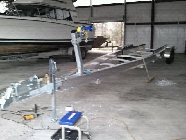

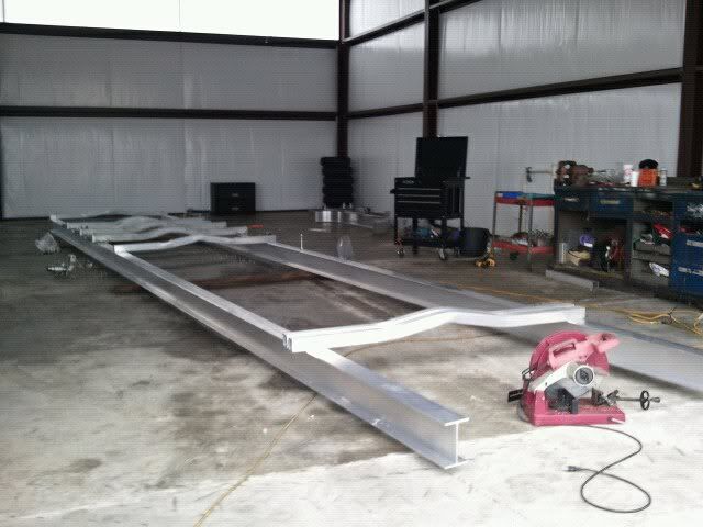

Built an BIG aluminum trailer for...
Building a trailer for a 35' center console boat. Took about 6hrs and have about 3 more to go. We build custom aluminum trailers so if you're in need of one let me know...
Start:
Almost done:

Dam nice...are you guys using tig or mig to weld those trailers up?

Its all bolt together with stainless steel hardware

did you have to cut reliefs in the i beams to bend them?

No we started by bolting the front axle, and the rear crossmember on. Then ratchet strapped the front and worked our way forward while tightening the straps... First one I built that way, but was a pretty cool way to do it. Just couldn't go to the front unless you were standing in the middle
