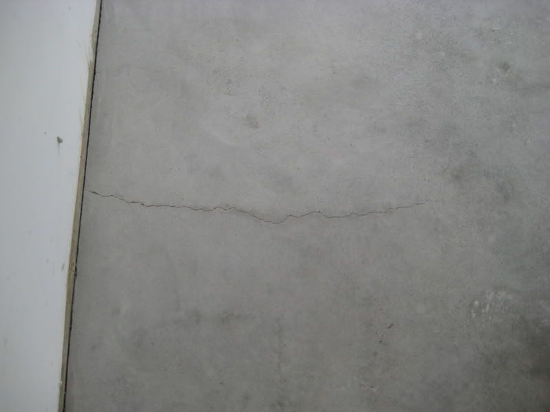

The drain was patched in with Rustoleum 100% solids epoxy patch (not shown here, sorry)
Washed
Ground
Cracks I filled with the Rustoleum epoxy (before pics)

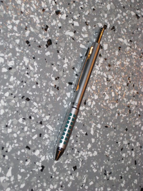

Finished
I'm very pleased so far, but it is early. I'll need to let it cure for a few days before I drive on it. It's ok though, because I now have to paint the walls and ceiling to match the motif:beer:
540 ft2, about 20 hours labor not counting cure time. If you're going to with Wolverine, I'd recommend buying more Bondtite (primer and clear coats) since I found this to be difficult to spread evenly. I had extra Liquatile (the gray), so that went on nice a smooth and cured to a smooth finish. Also, buy a spiked roller just in case. My primer coat had some bubbles, but they were hidden by the next two layers. So far :thumbup:
