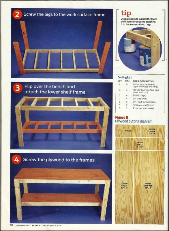

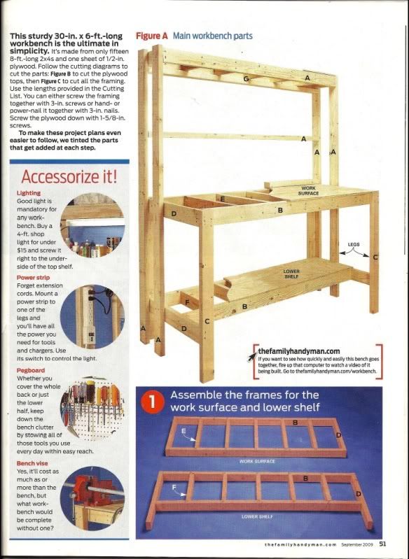

    I found this in a magazine and wanted to share it with everyone, its really easy to build, sturdy and a grreat addition to anyones garage/workshop. They lay the instruction and material list out really simply, very little wasted.

    I paid 56 with a box of 2.5in screws, make sure you read the directions. i got 2x4s 1/2 in to long and had to do 2x as many cuts, lol

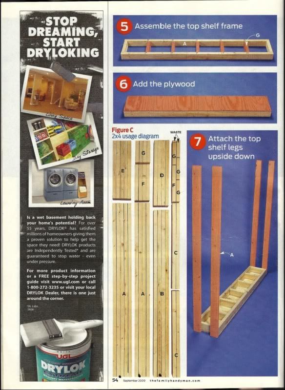

    So the PDF is missing the "Cutting List"
    The photos in the original post are a little fuzzy but I reckon I can decipher the list there:
    A 9 71 7/8" (Backer Boards, Upper Shelf Legs and rims)
    B 4 68 7/8" (work surface and lower shelf rim)
    C 4 35 1/2" (legs)
    D 4 27" (end rims)
    E 5 24" (work surface joists)
    F 5 15" (lower shelf joists)
    G 7 9" (upper shelf joists)
    Does this look right?

    Cut list is on the right side of page three, ill email u a good pdf
