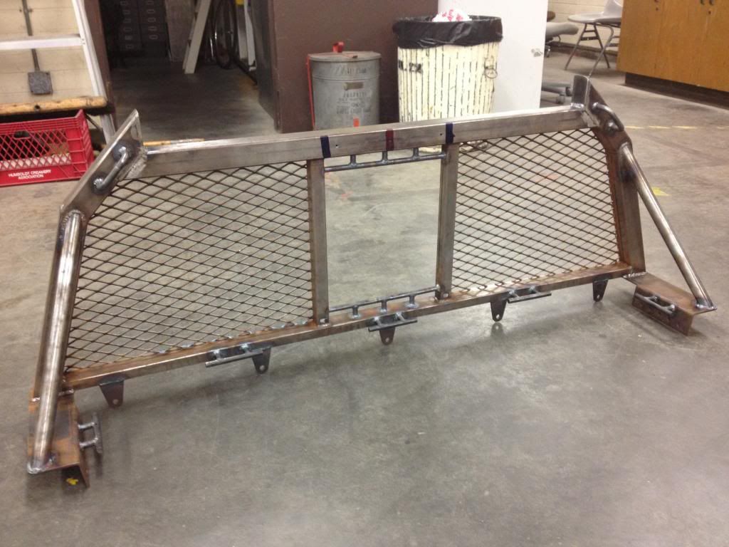

I posted this on the TW facebook page, but I thought I'd post a few more pictures of the build here. I can't take credit for all of the welds, my friend did most of the welding for me
Getting the mounting plates water-jetted:
Main frame:
Grating, mounting plates, and one of the diagonal bracing:
Test fits:
Fab work done:
Back from the powder-coaters:
Now I gotta lift it and get some bigger shoes so the rest of the truck can match the beefy rack haha

That's a good looking rack! What gauge and size is the expanded metal mesh? I am thinking about making somthing very close to what you have. Very good looking.
Thank you. It's 3/4" expanded, not sure about the gauge
