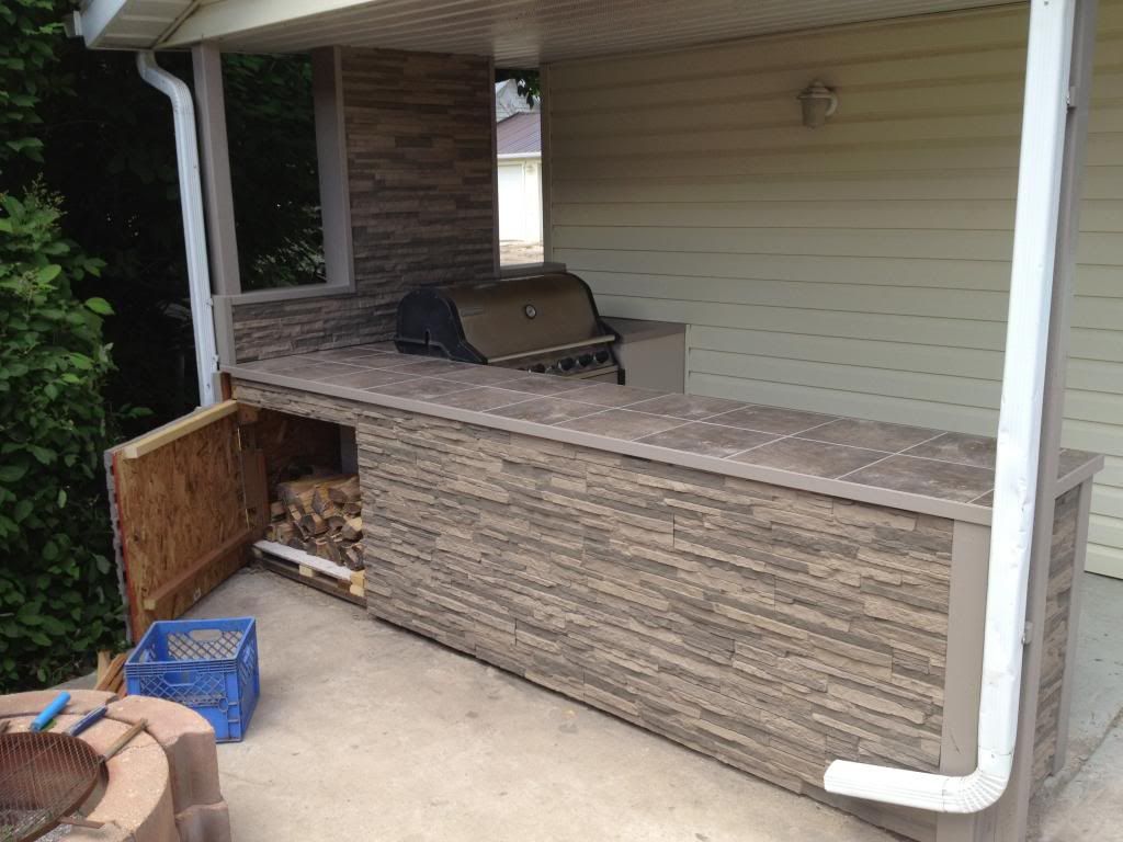

looks good you'll love it when your done, my buddy loved his when we were done

Man that looks really good!
