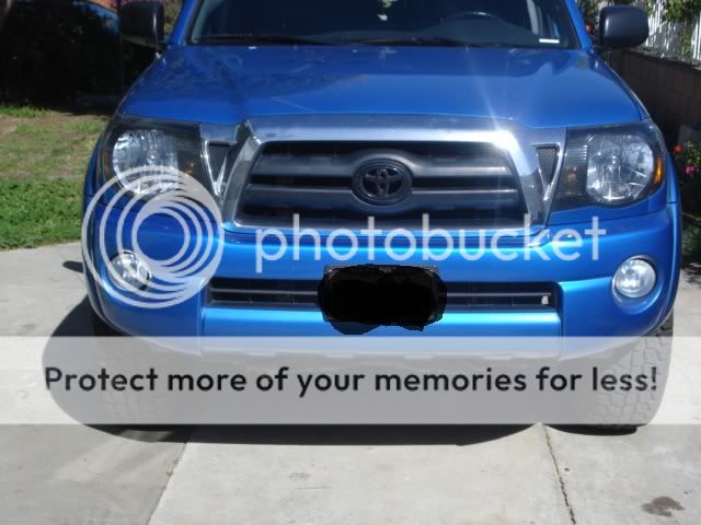

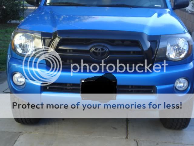

    I was not to happy with the way the chrome looked on my truck, so i painted all my emblems and my grill Black.. Here is how it came out! :D
    BEFORE
    AFTER

    Looks great man. What did you use to paint it? Are you worried about it chipping?

    To Paint:
    First i sanded all the chrome off with 3M 400 Sand paper, Then i cleaned it really well, I did a light spray of Adhesion Promoter, Then a light coat of Primer. Once that dried i sprayed it with Krylon Fusion black paint. SPrayed light to heavy coats until i got the texture i desired. After that dried i sprayed it with some clear coat. I let it sit for about 5 hours then put the grill back on. THat same night i ran it through a gas station carwash and no chipping, nothing. nice smooth finish. :p
