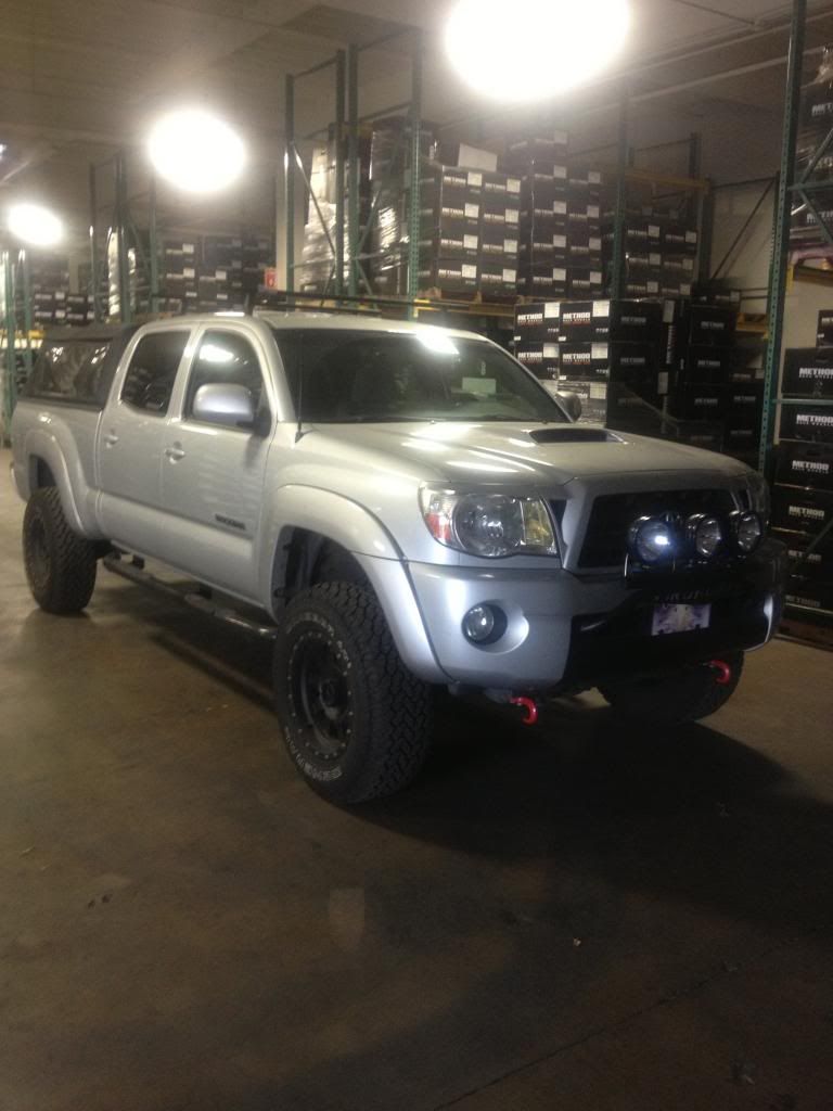

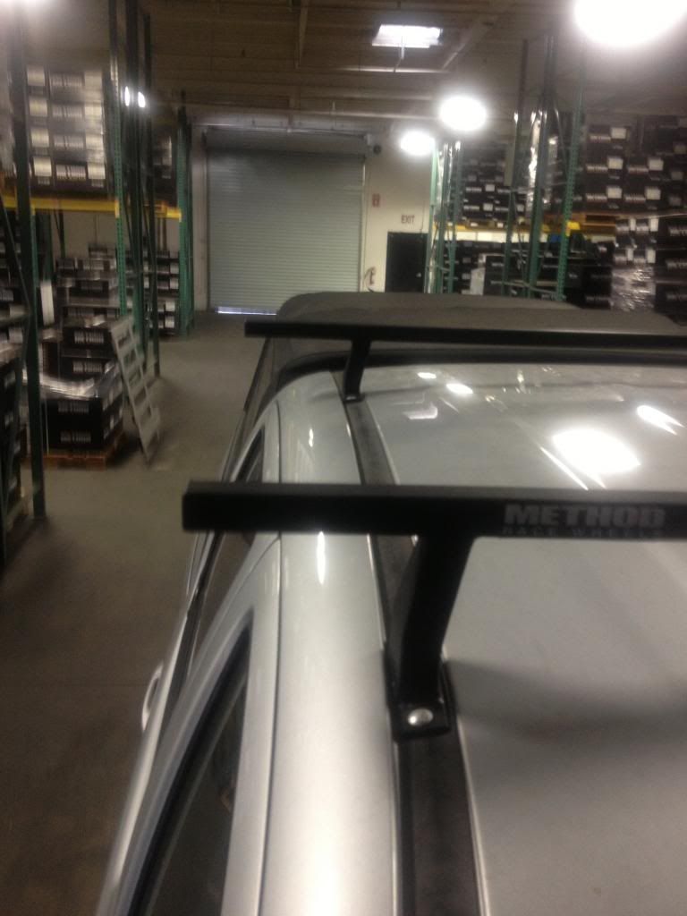

My Roof Rack Attempt

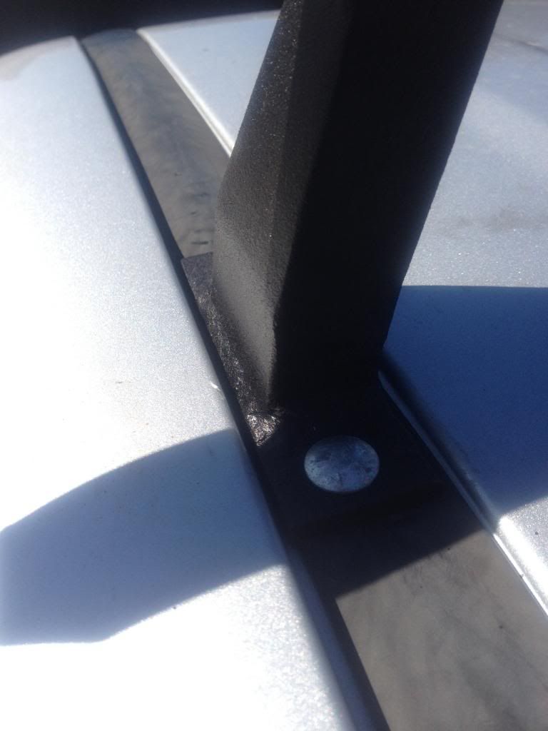

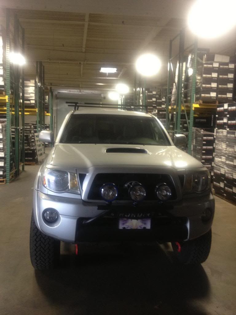

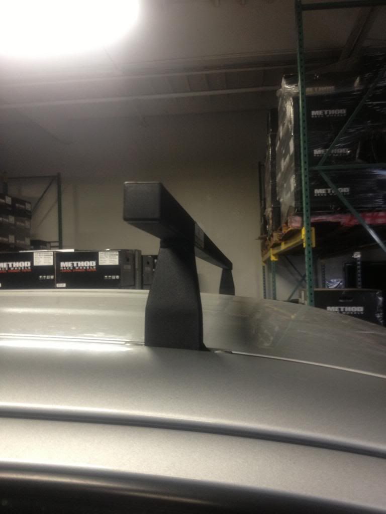

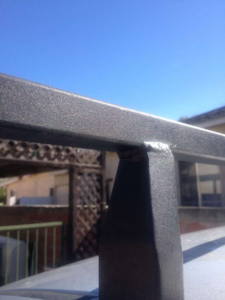

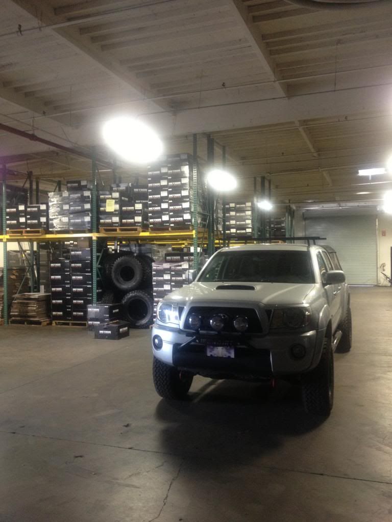

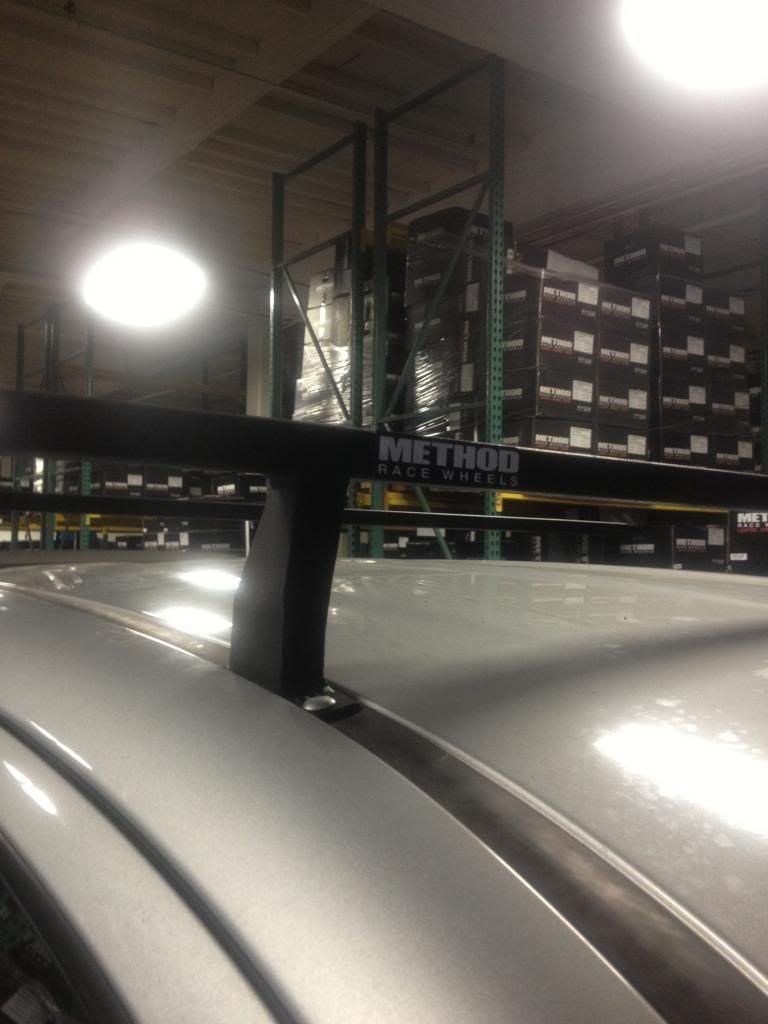

Why, you ask? Because I'm poor All said and done these ended up costing less than $50, a couple weekends, and a LOT of planning, measuring, measuring, measuring and fitting..
The feet are made of 3/16" plate steel
Load bars are 1"x1" 3/16" wall
Botled on with 1/4" x 1 1/2" carriage bolts (2 per foot)
Cut with a harbor freight grinder
Welded up with a harbor freight welder
Undercoated and bedlined
I'm really happy with the end result but I also had a blast building it! I think next I'm gonna try to muster up something a little more challenging like a tire swingout
Tell me what you think
Thanks for lookin

How did you tighten up the carriage bolts ?

Quote:
Pliers!!
Just kidding
I removed the head liner and cut out a tiny bit if the plastic reinforcement put on a washer and a nut on each one(theyre not threaded into the factory rack nuts) I know Its a little tedious but I live and work in the ghetto and dont want to get jacked

Quote:
Originally Posted by alexretama View Post
Pliers!!
Just kidding
How is that connection waterproofed ?
Bolt goes down through the stock weatherstriping.... tighten it down enough and it should be fine. If obcessed with it, throw in some sealant as you slip the bolts through.
Looks better than my attempt, which is still in MDF form since I know nothing about working with metal. Since I started that project, I've had stainless steel M6 bolts tightened down through the factory foam cover... and no problems.
