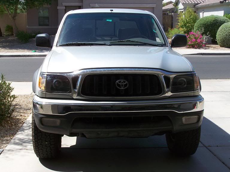

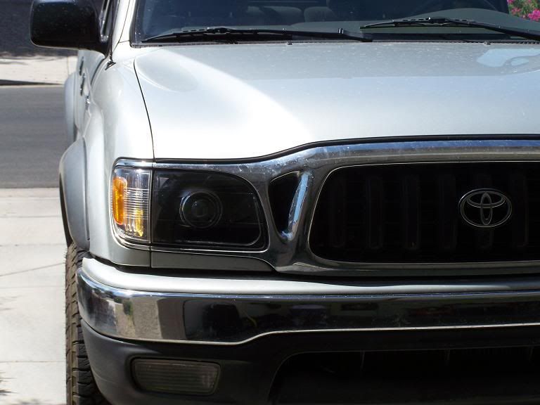

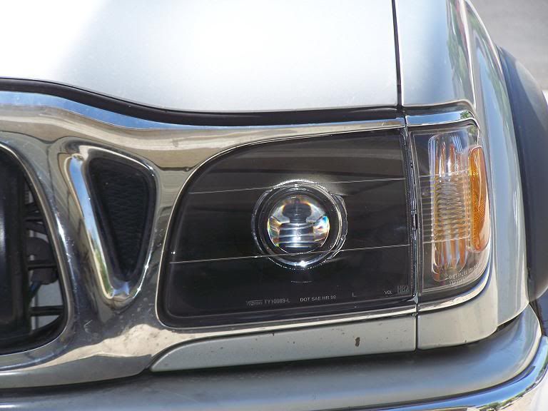

i picked up set of projectors from http://www.theretrofitsource.com and these are hands down better than any drop in kit. no cutting is necessary as long as you have a H4 bulb. here are some pics from my retro. the light output was taking from another member of hidplanet.com, but my light output is identical

Are those Morimoto Minis?

Nice! Looks like the aiming is perfect!

it needed a slight adjustment on the driver side only. it can only rotate a few degrees in either direction. i'll try to get more output pics later when i'm not working
the output pics are not from my truck, but that is exactly how mine look. just want that as a disclaimer. i haven't had any time to get pics of my own up yet.

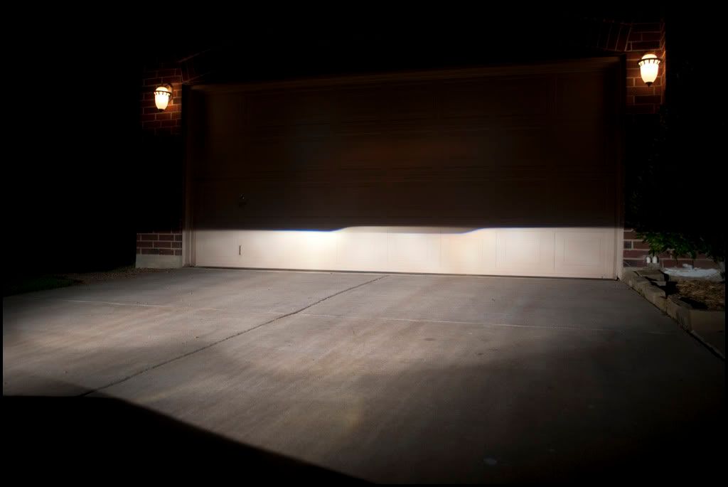

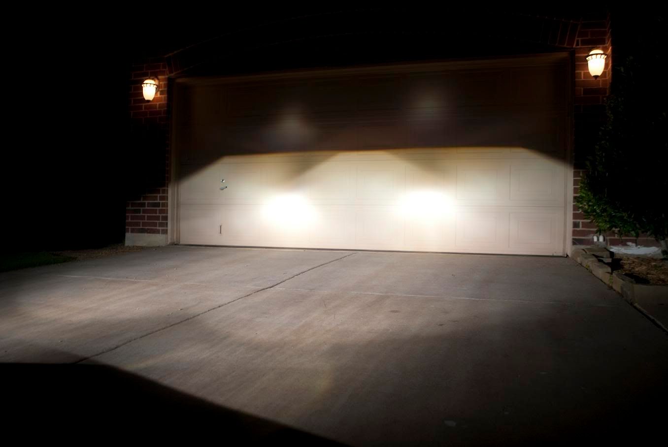

here are some output shots on mine. you can kinda see some hot spots on the wall, but they are practically invisible while driving. you can judge how "bad" these really are

He's way off. The G3 projectors need to be modified if you want the step cutoff like that. He has probably never had the Morimoto minis. I thought they were the shit, too. Until the angel eyes started looking lame, and the sorry excuse for a solenoid started failing and getting stuck. On top of that, good luck finding an H1 replacement bulb that has the notch.

So, those beam shots are minis not G3s with modded cut offs right?

this beam shot is from the morimoto d2s projector. not the g3
