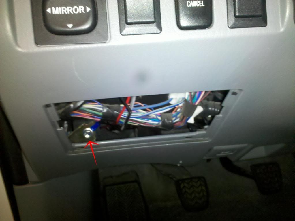

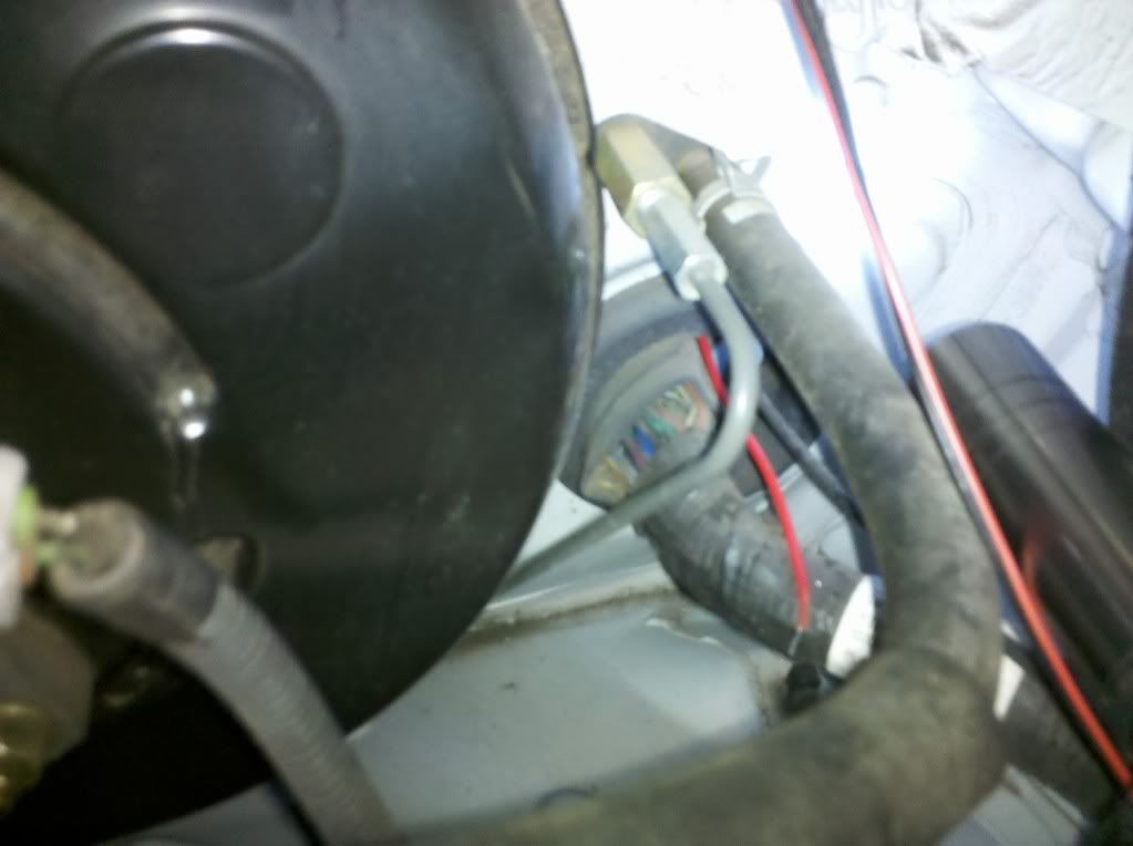

    To find an opening without cutting or poking, I put an LED flashlight in the engine bay pointed at the boot, then I got inside the truck and saw the light shining thru a small opening. I pushed the wire thru and it was perfect! I taped other wires to the red power wire and drug them thru with no problems or hangups.
    Ran wires from hoodscoop thru the hood down into some wireloom:
    Excellent ground for all this shit:
    Bought 2 of these http://www.oznium.com/scion-switch-led
    1 for the scanner and the other one for the LED's under my foot wells and under both seats.
    They are for a Scion but they fit AMAZING and look factory. I had to take a razor blade and shave off the left side plastic in the hole. Then they went in perfect.
