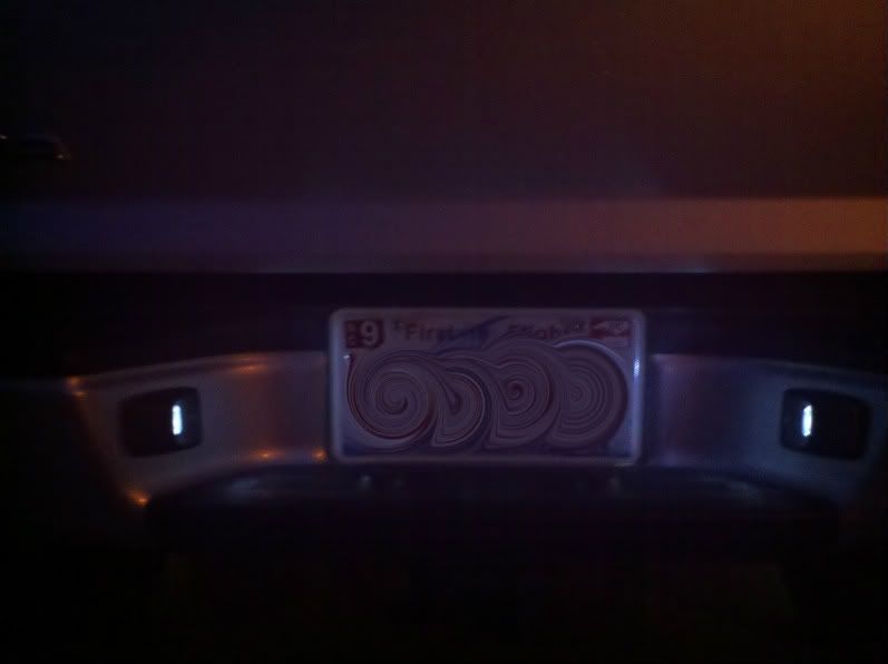

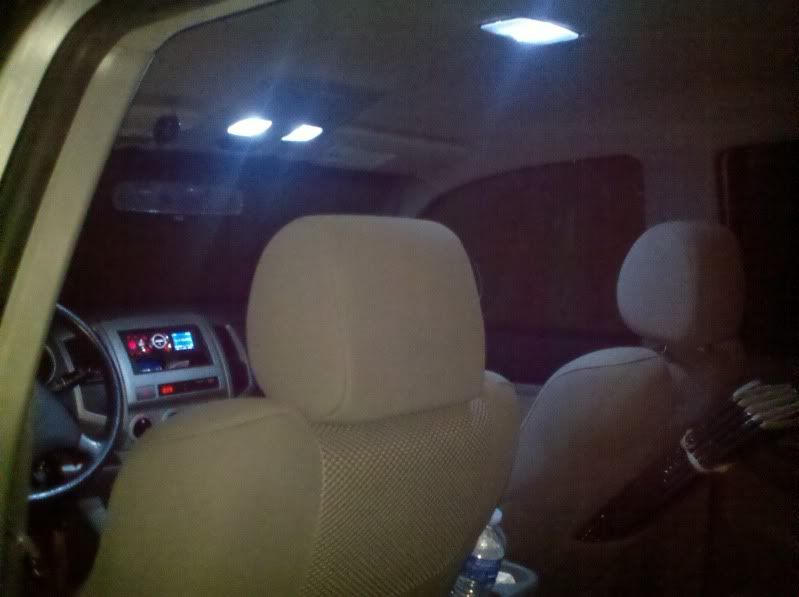

Installed LEDs in the dome, map, and license plate lights. Turned out pretty good I'd say. Ordered them from superbrightleds.com

The license plate lights don't seem to be throwing out a lot of light. But the interior ones look crazy bright.

Map Lights - 168 style - WLED-x5 LED Wide Angle LED bulb (need 2 bulbs)
Dome Light - 4410-x9 LED Festoon bulb (need 1 bulb)
License Plate - 168 style - WLED-x-x LED bulb (120 degrees viewing) (need 2 bulbs)
Install was simple:
Pop off the dome light cover and just snap in the bulb. Replace cover.
Map Lights - Pop off the lens covers and pry out the bulbs using a flat head screw driver. Push new bulbs into place, Replace lens covers
License Plate - Unscrew the black housings and twist out the old bulb. twist in the new bulb. Replace housings.

The led I have in my dome light have had some of them go out how do u like urs

I havnt had any trouble with mine. You must have a panel of leds in your dome light. The kind I have is just a bulb with leds inside of it. It looks almost identical to the stock bulb.

ya thats what i have right now. i think im gana change to the style that you have soon. i have had mine for like 2 yrs and its just now starting to lose lows of lights in the panel.

I just got my bulbs in. The dome light doesnt really fit evenly into the prongs, are yours like that too? Also, the license lights arent as bright as the stock, is yours that way too?

I also had a question on the map lights, how did you fit the metal housing around the bulb? The hole in mine wasnt big enough to use that metal reflector.

Thats odd about the dome light, mine fit perfectly. It was the same size bulb as the stock one if I remember correctly. And yes the license plate lights dont appear to be as bright as stock, but they've since grown on me and seem suitable to me. My map lights pushed right up into the housings though. I dont know why your bulbs are causing you so much trouble.
