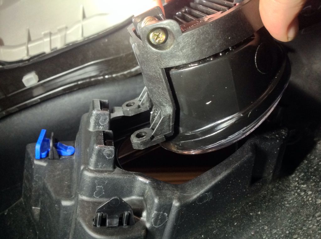

To start, you need to remove these two screws. You can either use a P2 Phillips screwdriver or a 10MM socket to remove them.

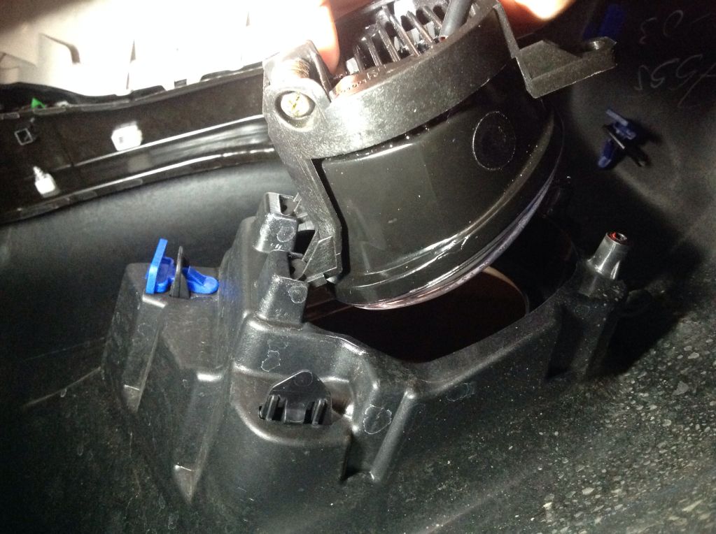

Once the plastic inner fender is pushed out of the way, this is what you’ll see. The two screws on the one side are what secure the fogs. You’ll need a stubby P2 Phillips head screwdriver to remove them.
They simply tilt out.

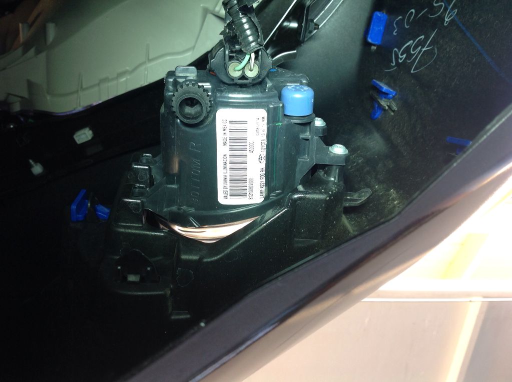

Putting the new XB LED Fog lights in is exactly the opposite of pulling the factory ones out

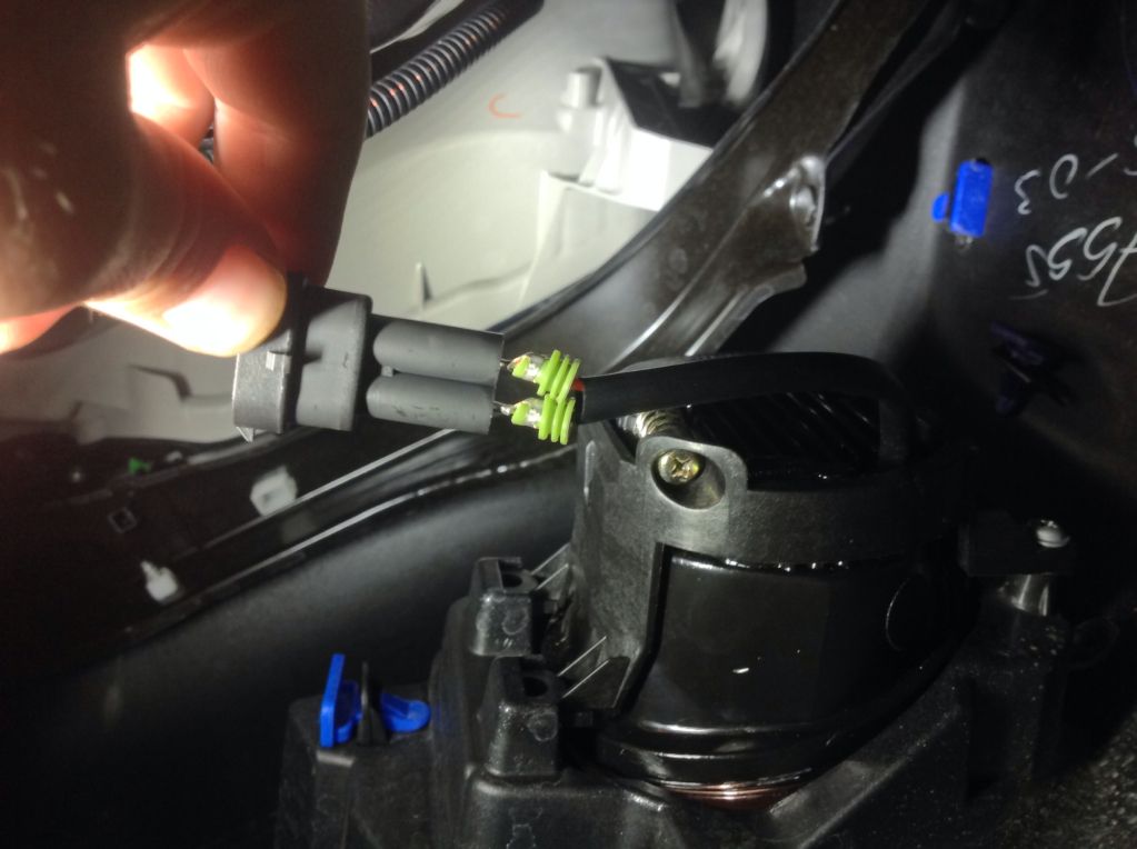

Now, to hook up the wires, you will want to double check which lead goes in which slot of the factory connector. Simply turn your fog lights on and plug the connectors in to find out which is the positive and which is negative. LEDs will only work one way, so if it works, then you win! If not, simply reverse the two leads and THEN you will win!
Now that you’ve discovered which wire goes where, you need to plug them into the connector that TRS provides.
Once you have the connectors together, you can safely zip tie the excess wire up and out of the way.

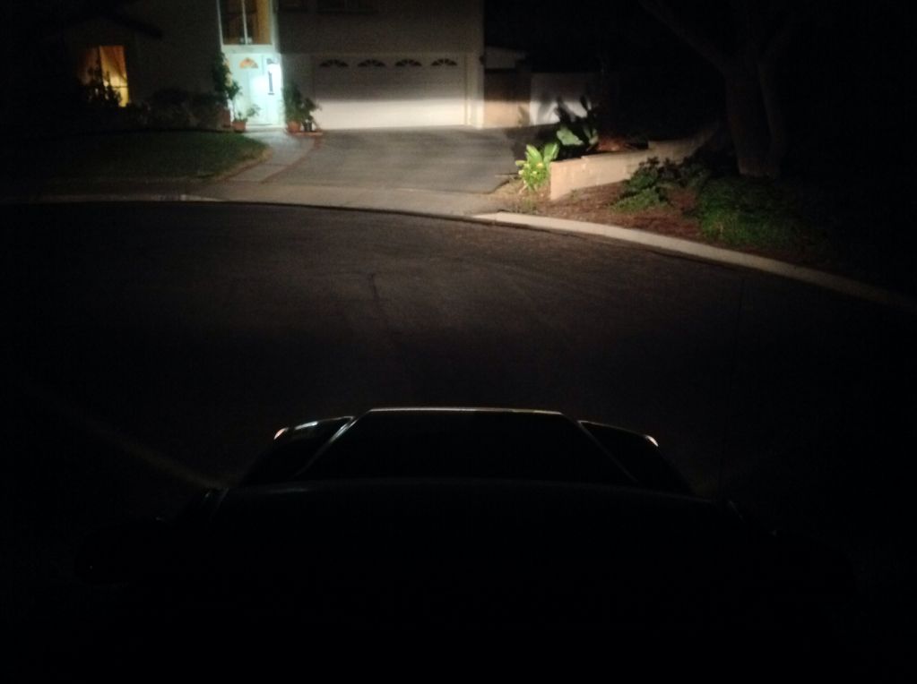

Low Beam Halogen headlights and no fogs.
Low Beam Halogen headlights plus XB LED fog lights.
To adjust the XBs for up and down level-ness, use a P2 Phillips head. Just like the factory fogs.
First impressions is that they’re awesome. However, I’ll admit to not really driving around with them yet. I’ll update later on how I like them as time goes on. Also, forgive me if this was a rather lengthy or not that informative of a write up. It's my first time. So be gentle! Also, all pictures are from my iPad.

XB LED Fog lights from The Retrofit Source
Adding my XBs today... So easy!!!!
(Oh yeah that's just my new Miller Elite Welding helmet that arrived when my lights did.)
So bright... Even more so than the stock headlights! Only took about 15 minutes total install time. Not 2 hours like the box quotes you. Thanks The Retrofit Source!
