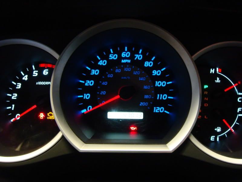

Did My Dash Mod Today Was Easier Than I Anticipated And Only Took About 1 Hour From Start To Finish. Waaaayyyyyyy Better Than The Amber Crap. If You Know How To Solder This Should Be Your Next Mod.
LED's From http://www.oznium.com/ -
- Tach = 2
- Tach Needle = 2
- Speedo = 3
- Speedo Needle = 3
- Temp = 1
- Temp Needle = 1
- Fuel = 1
- Fuel Needle = 1
- Odometer = 3
- Turn Signals = 2 per side
- Additional indicators (ie CEL, Batt, Cruise etc..) = 1 per light
Shipped Fast And Was About 17 Bucks Total (0.49 a piece).
These Are The LED's Used -PLCC2 Surface mount Top
And Here It Is
So Whatcha Think?
Oh, And Here Is The Link That Guided Me - http://www.toyotanation.com/forum/sh...d.php?t=180314
A few of the ones done here...
so who's next?
