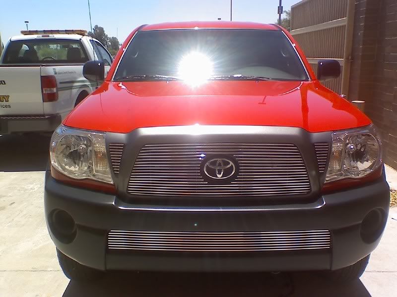

As you can see below... I have no fog lamps on my truck. I was wondering if anyone has advice on a good set of fog lights, that might have nice "close to OEM" switch that will fit in the switch panel? Some pics would be nice if you have them. And maybe a rough estimate on price.

Your truck looks like it has a Homer Simpson stubble beard.
HMM? Thanks?
Ahh I see now, you're right! Never noticed that! haha
