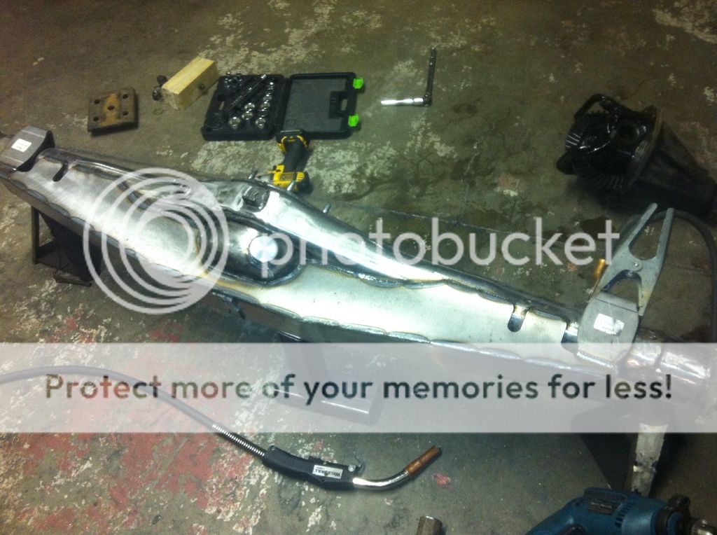

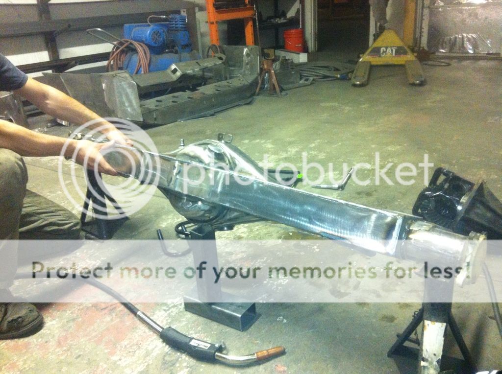

Do tell
Like mine.
Truss is wide so that it extends to very top and bottom of the axle tubes. The heat you add will be 180* apart and pull opposite of eachother. Do a few stitches on all sides and burn everything in.
