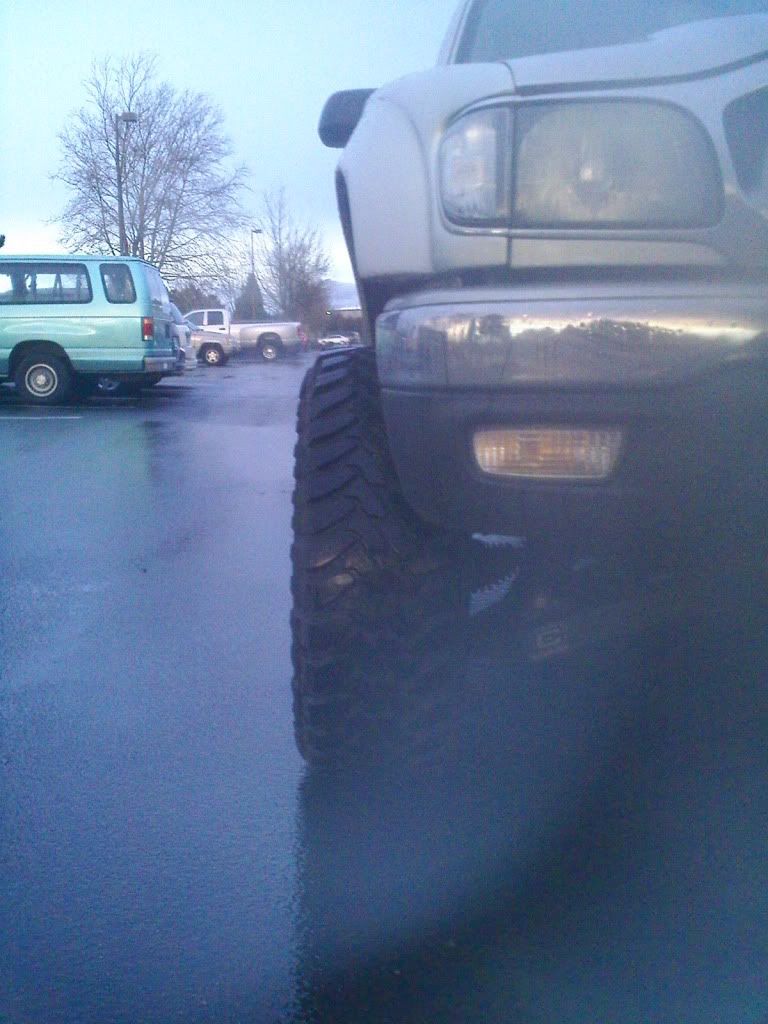

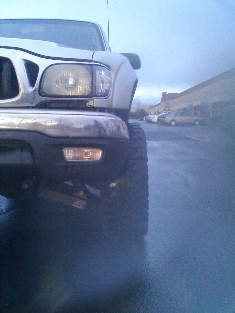

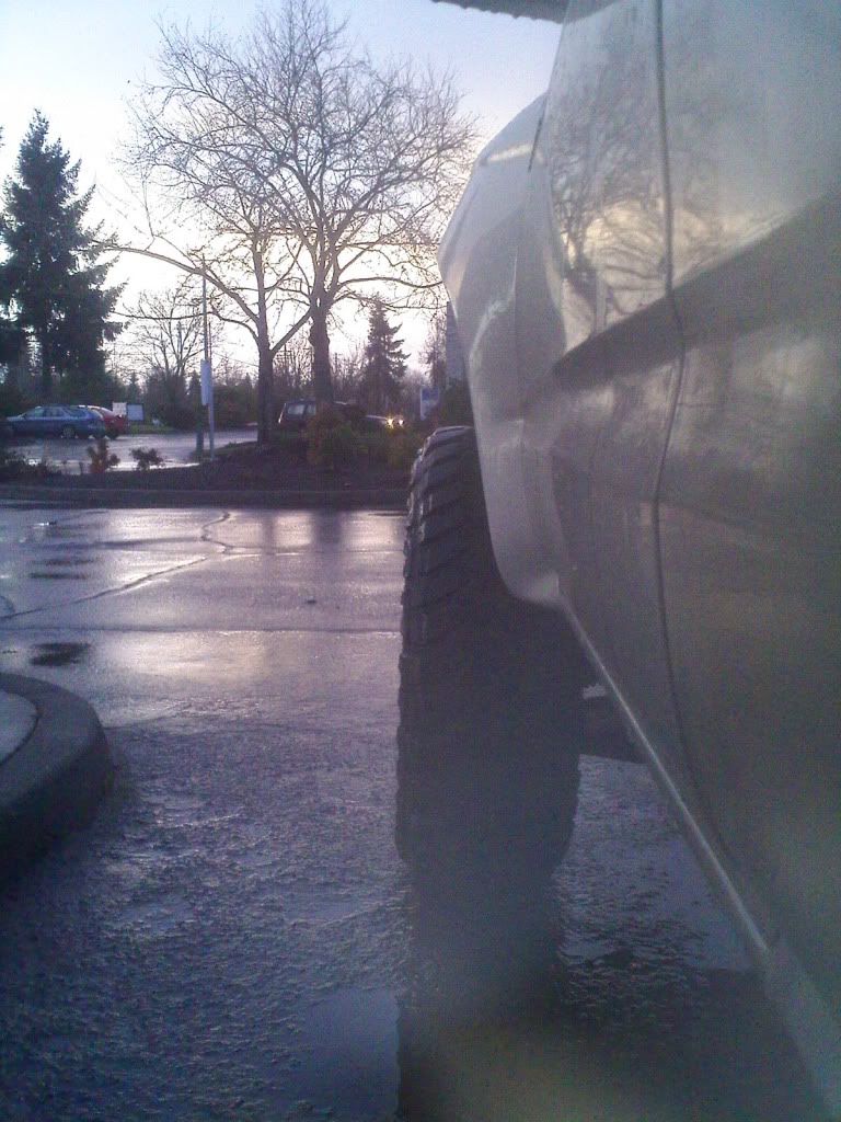

So I have noticed that my front tires tilt inward. I am not sure if this is an alignment problem or my upper ball joints might be busted... I have had several alignments done on the vehicle, but I can't eliminate the tires from tilting inward like these pictures. Could it be a upper ball joints? I noticed when i was replacing lower ball joints and a front drive axle the underside of the upper ball joint had a small chunk of metal missing. I am not sure which side it was though. I have jumped the truck several times before. Here is the pics.

Are the UCA's stock?

Yeah, I might have bent my UCA's and no the UCA's are not stock... This isn't good! Haha

Spindles are the first place to look after you get alignment specs. Looks like you might have just hit it out of camber. How long has it been like this?

For a month or so. Alignment only helps with toe not camber. That is it I will get another alignment done and see what happens.

I dont see how you could have bent the UCA's. THe Spindles, but not the UCA's.

okay... Spindles are hard to find at junk yards. Brand new is going to cost me an arm and leg. This sucks! lol Those TC gussets didn't do anything for the truck.
TC spindle gussets or the uca gussets?

I have the TC gussets. They were welded on to mu stock spindles.
