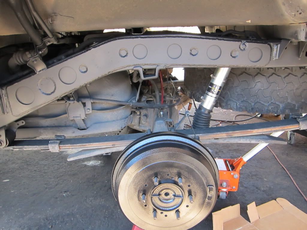

Who trigger welded your spindle gussets on?

Quote:
Jason Speed Freak did almost all of my Fabrication work.

The frame plates look a lot better but it still looks like he trigger welded it. Why not just run a bead? Did you see him weld any of it?
