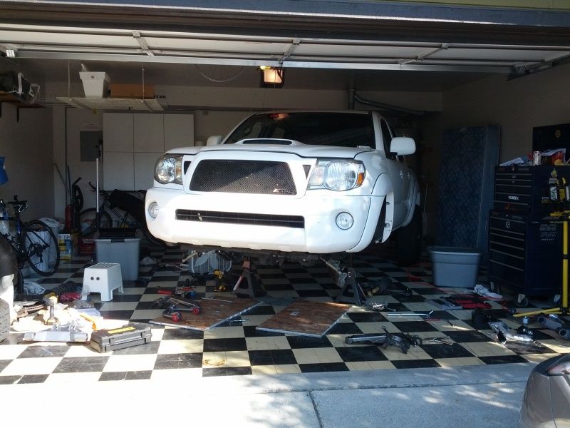

    Well freezing the bushings over night really did nothing for es of installation. But I was able to get everything out last night before calling it a night.

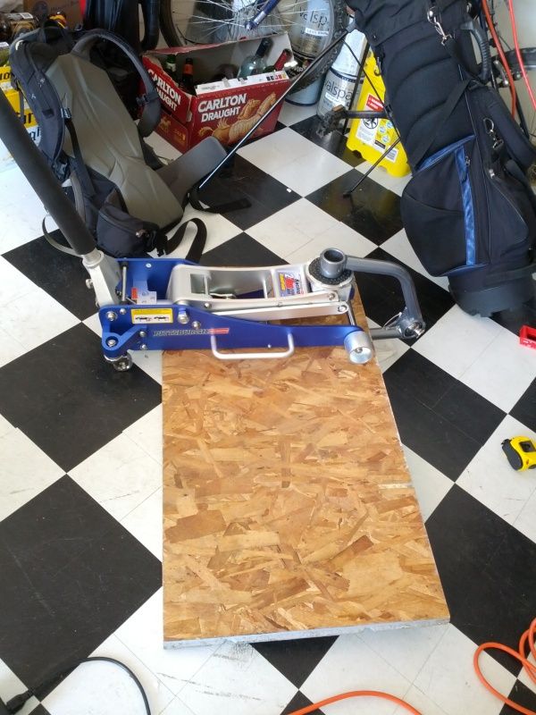

    Sooooo I talked to the guy that welded up my spindles last night and he said to either try spreading the UCA or grind a little off the coil bucket side of things. So I improvised.
    The wood started to bend and crack but I was able to spread the UCA just about 3/32" and tried it on for size
    OOOOH THAT'S A BINGO!!!!
    So now that I have a solution to the problem on to the rest of the install, I dropped the spindles off last night with Jeff (one of the fabricators) from Red Label Off-road in Vacaville. Never heard of anything about them but had been by their shop before and they had some pretty nice projects going on inside so it seemed legit enough for me. The guy I dropped the spindles off with ended up taking them home last night to weld them up and had the ready for pick up this morning at 9!!!!

    YOU BENT YOUR UPPERS!?!?!?!
    that wasnt a very smart move, that bushing is rubber, the washer will fit.

    I talked it over with a shop first. We decided it was just when they manufactured them. Since they were in a jig they probably tweaked a little from heat and when they were pulled out came in a little. THERE WAS NO OTHER WAY THE WASHER WAS GOING TO GO IN:facepalm: (next to grinding metal), trust me I'm not new when it comes to automobiles, plus it was so extremely minuet it shouldn't do anything.
    And in retrospect a big pry bar and force is really the exact same thing.
