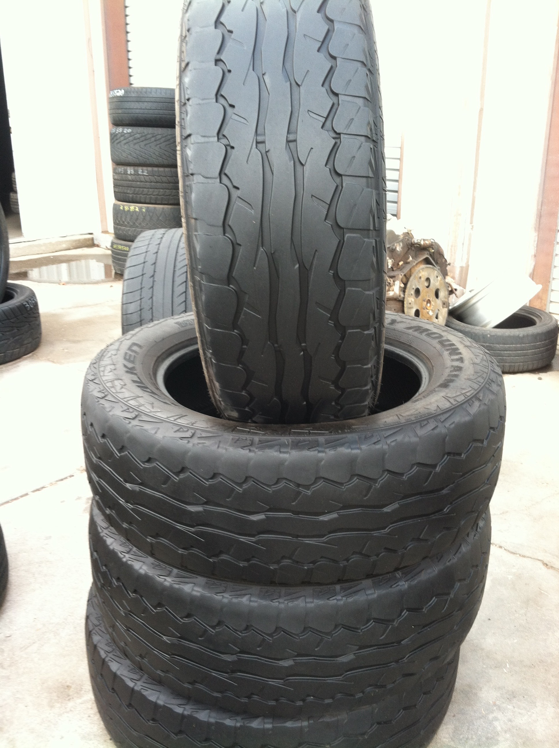

I just came across a set Falken Rocky Mountain AT tires. From all the reviews and videos I've seen they are a pretty good tire. However, I have one issue with them.
If you look at the center tread depth versus the shoulder tread depth youíll notice that the shoulder tread depth isnít as deep as the center. Therefore, as the tire starts to wear it will look more like a traditional street tire versus and AT tire. BFG ATís have full tread depth through out the entire tire which makes sense.
My solution to this would be a sipe/groove out the shoulder to make it match the center tread depth. If you look at the pictures below youíll see what Iím talking about. Since LT guys tend to sipe/groove their tires more than non LT guys I figured I would post this in the section so guys with experience can chime in.
Moreover, instead of buying a tire groover or tire siper I was thinking of using a Dremel with a grinding wheel to achieve this. It sounds like a redneck idea but I think it would work. Any suggestions?
In this picture you can see the center is deaper than the should tread.
Another angle of the tread depths
Worn tires look like street tires

In my opinion, don't waste your time siping them. You sipe tires so they perform better in the wet and snow. Tires that worn are going to suck in foul weather, just slow down, wear your last few thousand miles out of them and toss 'em. Also, don't use a dremel, use a knife if you really feel the need. The high speed dremel will just melt the rubber and it's not strong enough to cut at slow speeds. A rotary tool would be a good option but it needs to be a slow speed tool.

I wouldn't use a dremel since there are several things that could go wrong. (Slipping and accidently grooving the sidewall for one!! ) Also, I think it would make rougher cuts in the rubber (rather than a conventional grooving/siping tool) that could leave the possibility for future deterioration from the stress put on the rubbber.
I would definately groove and maybe sipe (with the proper tools) those falkens since they do have one of the most retarded wear bars I've ever seen on an all-terrain tire.
PS I work for Discount Tire, and imho those are the worst quality all-terrain tires we carry. Take it fwiw...

Using a dremel to sipe a tire isn't the best idea. But from what I read, it looks like you know that.
if anything, use a heated knife. But be careful not to cut too deep into the tread.

If you are looking for aesthetics then get a tire that has the look you want. You will waste time and potentially ruin the tire if not done right.

It didn't cross my mind that I can melt the rubber with a Dremel. Maybe I'll just use an angle grinder.
Why do you think they're the worst AT tire you guys carry? I know they don't have the big name like BFG, GY, General, etc. but from everything I've read and seen they seem to be a pretty good tire. My only concern is long term wear and tear.
I'm in the same boat as Silas over there. It's one of the worst AT tire's we have IMHO. The lack of full depth siping for one thing. From working at discount in Texas, I've seen quite a few different AT tires. If you look at almost all the other AT tires, even when they wear down, they still are able to get traction because of the siping and tread pattern. With those Rocky Mountains, once they get past about 8/32's you get 5 long blocks with no depth to them.
Another thing, rubber compound. There's a reason Michelin and BFG and Goodyear are high up there. The rubber compound they have come up with is better than Falken's. Not saying all falken's are bad. But for the most part, the other's are better.
And just letting you know, a cut off wheel would be your best bet

Which is why I suggested siping or grooving.
In this picture we can see the end result. Regardless, we'll see how I do with them.

Like Silas said, if you're going to get close to the shoulder with that thing you'll be using, be very very VERY careful you don't damage the shoulder or sidewall of the tire.
Post up pics when you've finished!
