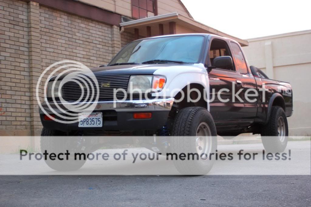

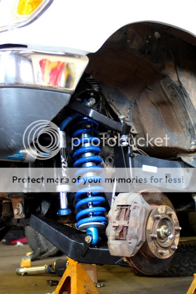

Truck went out before i left for BAP, but i didnt have time to upload pics......so here ya go
Hopefully he'll get some larger tires soon

One issue is no one wants to make a heavy enough spring. He doesnt want to loose much travel by changing the motion ratio.....sooooo why not go TT on it? hahah Yep..

If i can get an order of 5 people i can do a small run of kits at $3k ea.
Included in the kit:
-boxed upper arms with 1"uni and delrin bushings
-boxed lower arms with 1"uni and rubber bushings
*lower delrin is an option, but takes special alignment conditions
-uniball adapter for the stock uprights
*Includes double shear steering tabs with corrected steering
-outer heim steering (tierods+heims)
*This will be threaded into the stock inner tierod
-extended stainless brakelines
-limit straps + upper weld on frame tab
-upper shock mount
-grade 8 bolts
SOOOOO whos interested?
