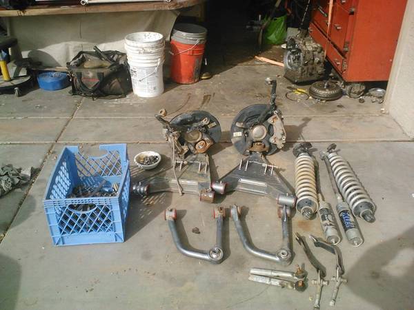

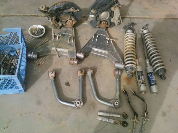

hey guys, found a great deal that i just don't think i can pass up. Total chaos 3.5 kit (2005+) and i want it! My concerns are as follows...

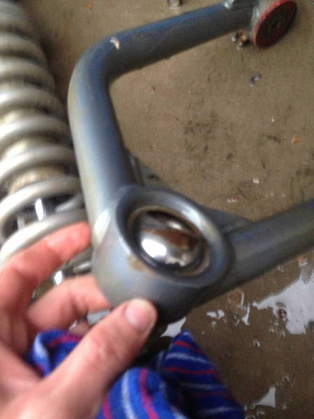

1. Uniballs have a small amount of rust, will i have to replace these?
2. The piece that the lower uniball sits in and connect to the spindle has surface rust.

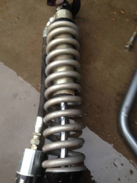

Other than these issues, everything is a little dirty but straight, and all welds look good! Shocks are also included, and I'm thinking i should rebuild them. Price for everything... $2500!!!!
What do you guys think? Thanks in advance!
(the arms are dirty, that is not rust)

doo it, for that price it's really good. uniballs are cheap and easy to replace when arms are off the truck. and uniball adapters will clean easy then, you can paint them to protect them too. just a lil maintenance and it'll be like a brand new kit again. rebuild, uniballs, a lil paint

thats what I'm thinking any suggestion on uniballs????

Fk uniballs....get it
