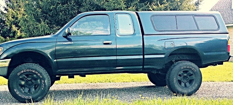

First Tacoma
Project MPG Work Tacoma
Truck: 1997 Toyota Tacoma 3.4L V6 4x4 DLX with 3.53 gears
Goals: 32+mpg (100% over EPA) year round and maintain towing/hauling capability.
Current Mods:
- UltraGauge (0-10mpg in the way it aids my driving technique)
- 245/75/16 Tires at 55PSI (1mpg over 40PSI)
- Front Grill Block (1mpg)
- Air Dam (2-3mpg)
- Removed Wipers (have them in the cab for rain) (.5mpg)
- Folded Side Mirrors (.5mpg)
- Flush Fiberglass Cap (2mpg)
- Synthetic Motor Oil (0w30 Mobil1 High Mileage) (.3mpg)
- Differential Fluid: Amsoil Severe Gear Synthetic Extreme Pressure Gear Lube 75W-90 (1-2mpg)
- Removed Spare Tire (70lbs) (.2mpg)
- Full Coroplast Under Panels (2-3mpg)
- Mudflap Delete (.3mpg)
- Radiator Clutch Fan Delete (1-2mpg)
- Power Steering Belt Removal (1mpg)
- 3 Inch Spacers + Add A Leaf (minus 1-2mpg)
- Side Skirts (.5mpg)
- Rear Wheel Skirts (.5mpg)
Total Completed= 12.8-26.8 mpg over EPA 16mpg
Planned Mods:
- Smooth Wheel Covers (.5mpg)
- Kill Switch (.5mpg)
- Synthetic Transmission Fluid (1mpg)
- 2000 W circulating heater (1mpg)
- Tranny, Differential heaters (1mpg)
- Alternator Switch (1-2mpg)
- Led Lights (.2mpg)
- Deep Cycle Battery (1-2mpg combined with Alternator Disable)
Potential Future Improvement= 6.2-8.2mpg
Driving Technique:
- Pulse & glide
- Engine off coasting
- Generally keeping it under 60mph (2,000 rpm)
- Timing traffic lights
- Shifting as low as possible
- Route planning
History:
1st owner had it and put 117,000 miles on it before it through a rod after he overheated it. It sat in his garage from 2002-2011, when he sold it to the 2nd owner, who happened to be a Toyota dealership mechanic. He purchased the truck and immediately had the frame inspected to see if he could get in on the 1st gen frame rot recall. The inspection came back as a really great solid frame so he decided to put a rebuilt engine in it. He also did the timing kit with a water pump, along with a new starter and alternator and a new suspension system. He also redid the rustproofing. He had paid $6,000 for it and put another $2,500 into it doing most of the work himself. He drove it for 18,000 miles mostly from Florida to Michigan and back on road trips before selling it to a friend of his for $7,000, when he bought a new one. His friend already had a Ranger when he had bought the Tacoma off him and decided he preferred the ranger because of gas mileage. So he list's the Tacoma for $5,000... after only a year and putting like 3,000 miles on the thing. I offered him $4,000 as a hopeless lowball offer and he came back at $4,200 and I came to pick it up the next day Needless to say I feel that given the current state of the truck and all the work that was done it's probably worth almost double what I paid for it. I love it so far, and feel very blessed to be owning such a quality piece of equipment. Cheers~
Basline Tank:
2014-03-05
272.8 mi
13.653 gal (US)
19.98 mpg (US)
11.77 L/100 km

I need a new pic as I already put a new Add a leaf helper spring in I might put longer headers on it and I'm also considering several mpg mods.
