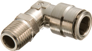

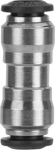

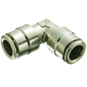

Mike "Wuzzy121". Rest in peace, brother
Go Back   Tacoma World Forums > Tacoma Discussion > Off-Roading & Trails
Notices
ARB 5mm Push-to-fit fittings sources
Reply
Thread Tools Search this Thread
Old 02-26-2014, 08:55 AM   #1
SMKYTXN [OP] SMKYTXN is online now
If it can't be overdone it's not worth doing
SMKYTXN is one of the sharper tools in the shedSMKYTXN is one of the sharper tools in the shedSMKYTXN is one of the sharper tools in the shedSMKYTXN is one of the sharper tools in the shedSMKYTXN is one of the sharper tools in the shedSMKYTXN is one of the sharper tools in the shedSMKYTXN is one of the sharper tools in the shedSMKYTXN is one of the sharper tools in the shedSMKYTXN is one of the sharper tools in the shedSMKYTXN is one of the sharper tools in the shedSMKYTXN is one of the sharper tools in the shed
SMKYTXN's Avatar
Name: Nathan
Joined: Mar 2011, #52810
Location: Houston
Age: 34
Gender: Male
Posts: 6,344
SMKYTXN's Tacoma Gallery
ARB 5mm Push-to-fit fittings sources
I'm in the process of completing my diff install and found that finding fittings for the 5mm air line is a pain. I've come across a source for 5mm push-to-fit fittings and figured I'd share.
Fastenal
If you want to run an airline right out of the ARB compressor without the solenoid you'll need these.
5mm Tube x 1/8" Male BSPT 90[DEG] Nickel Plated Brass Push-to-Connect Swivel Elbow
If you want to make a 90 degree turn and don't have the space required for the large bend in the plastic air line you'll want one of these.
5mm x 5mm Tube 90[DEG] Nickel Plated Brass Push-to-Connect Union Elbow
And if you need to make a quick repair to a cut air line you'll definitely want some of these.
5mm Push-to-Connect union
If you come across other fittings please post them.
  Reply With Quote
Old 02-26-2014, 09:27 AM   #2
SMKYTXN [OP] SMKYTXN is online now
If it can't be overdone it's not worth doing
SMKYTXN is one of the sharper tools in the shedSMKYTXN is one of the sharper tools in the shedSMKYTXN is one of the sharper tools in the shedSMKYTXN is one of the sharper tools in the shedSMKYTXN is one of the sharper tools in the shedSMKYTXN is one of the sharper tools in the shedSMKYTXN is one of the sharper tools in the shedSMKYTXN is one of the sharper tools in the shedSMKYTXN is one of the sharper tools in the shedSMKYTXN is one of the sharper tools in the shedSMKYTXN is one of the sharper tools in the shed
SMKYTXN's Avatar
Name: Nathan
Joined: Mar 2011, #52810
Location: Houston
Age: 34
Gender: Male
Posts: 6,344
SMKYTXN's Tacoma Gallery
4x4 Connection
This site has a good selection of fittings as well as replacement parts.
IPOR-Firewall Connection
  Reply With Quote
Old 02-26-2014, 09:37 AM   #3
Senior Member
paranoid56 is one of the sharper tools in the shedparanoid56 is one of the sharper tools in the shedparanoid56 is one of the sharper tools in the shedparanoid56 is one of the sharper tools in the shedparanoid56 is one of the sharper tools in the shedparanoid56 is one of the sharper tools in the shedparanoid56 is one of the sharper tools in the shedparanoid56 is one of the sharper tools in the shedparanoid56 is one of the sharper tools in the shedparanoid56 is one of the sharper tools in the shedparanoid56 is one of the sharper tools in the shed
paranoid56's Avatar
Joined: Jul 2012, #83443
Location: San Diego
Gender: Male
Posts: 897
paranoid56's Tacoma Gallery
Thanks, these should come in handy when swapping from the normal switch to a manual air switch
  Reply With Quote
Old 02-26-2014, 09:40 AM   #4
SMKYTXN [OP] SMKYTXN is online now
If it can't be overdone it's not worth doing
SMKYTXN is one of the sharper tools in the shedSMKYTXN is one of the sharper tools in the shedSMKYTXN is one of the sharper tools in the shedSMKYTXN is one of the sharper tools in the shedSMKYTXN is one of the sharper tools in the shedSMKYTXN is one of the sharper tools in the shedSMKYTXN is one of the sharper tools in the shedSMKYTXN is one of the sharper tools in the shedSMKYTXN is one of the sharper tools in the shedSMKYTXN is one of the sharper tools in the shedSMKYTXN is one of the sharper tools in the shed
SMKYTXN's Avatar
Name: Nathan
Joined: Mar 2011, #52810
Location: Houston
Age: 34
Gender: Male
Posts: 6,344
SMKYTXN's Tacoma Gallery
Quote:
Originally Posted by paranoid56 View Post
Thanks, these should come in handy when swapping from the normal switch to a manual air switch
No problem, glad to help.
On the subject of switching to a full pneumatic system you'll want to check out powertanks website.
Powertank
I have a set of these ordered for my setup. I'll post pictures and maybe a video when they show up.
Air Toggle Vale Kit - Fr + Rr ARBs
  Reply With Quote
Old 02-26-2014, 10:15 AM   #5
Senior Member
paranoid56 is one of the sharper tools in the shedparanoid56 is one of the sharper tools in the shedparanoid56 is one of the sharper tools in the shedparanoid56 is one of the sharper tools in the shedparanoid56 is one of the sharper tools in the shedparanoid56 is one of the sharper tools in the shedparanoid56 is one of the sharper tools in the shedparanoid56 is one of the sharper tools in the shedparanoid56 is one of the sharper tools in the shedparanoid56 is one of the sharper tools in the shedparanoid56 is one of the sharper tools in the shed
paranoid56's Avatar
Joined: Jul 2012, #83443
Location: San Diego
Gender: Male
Posts: 897
paranoid56's Tacoma Gallery
yep, already have those Steve at powertank is a great guy. Have one of the original power tanks too
  Reply With Quote
Old 03-05-2014, 11:16 AM   #6
SMKYTXN [OP] SMKYTXN is online now
If it can't be overdone it's not worth doing
SMKYTXN is one of the sharper tools in the shedSMKYTXN is one of the sharper tools in the shedSMKYTXN is one of the sharper tools in the shedSMKYTXN is one of the sharper tools in the shedSMKYTXN is one of the sharper tools in the shedSMKYTXN is one of the sharper tools in the shedSMKYTXN is one of the sharper tools in the shedSMKYTXN is one of the sharper tools in the shedSMKYTXN is one of the sharper tools in the shedSMKYTXN is one of the sharper tools in the shedSMKYTXN is one of the sharper tools in the shed
SMKYTXN's Avatar
Name: Nathan
Joined: Mar 2011, #52810
Location: Houston
Age: 34
Gender: Male
Posts: 6,344
SMKYTXN's Tacoma Gallery
  Reply With Quote
Reply
Thread Tools Search this Thread
Search this Thread:
Advanced Search
Similar Threads
Thread Thread Starter Forum Replies Last Post
Will 12000 Badlands winch fit on ARB bumper? IanN Off-Roading & Trails 12 05-09-2014 01:46 PM
4Runner ARB fit Tacoma? xaqori 2nd Gen. Tacomas 10 12-18-2012 06:56 AM
MY NEW KRAGEN DONT FIT MY PUSH BAR?? freezb Lighting 11 12-22-2011 04:45 PM
Push Bar - NOT BULL, NOT LIGHT, PUSH j4x4ar3 2nd Gen. Tacomas 9 08-26-2011 08:35 PM
Would an ARB Snorkel fit 94' pickup? bacobits24 1st Gen. Tacomas 2 08-02-2008 08:27 PM
Copyright © 2015 Tacoma Forum. Tacoma World is not owned by, or affiliated with Toyota Motor Corporation.
