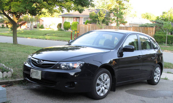

The Other Black Sheep - Subaru Impreza 2.5 NA
2011 Subaru Impreza 2.5i naturally-aspirated base model.
Just a few functional mods for now. Prefer one money pit (Taco) rather than two.
Weathertech Floorliner
Subaru OEM Cargoliner
RallyArmor Flaps
Family Picture
Other stuff not shown:
eBay 35W 5100K HID kit in stock projector housing
AFE drop-in Dry-S air filter
  Reply With Quote
