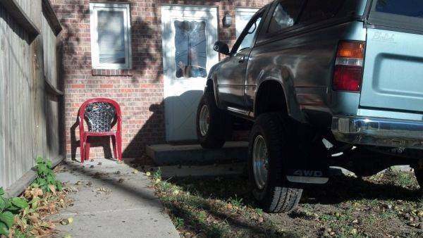

More South Dakota Parking, something in the water me thinks. . .
My girl said to meet her at the door
Major flex on IFS, NBD^^^

Vibrant Ultra Quiet Resonator is in
Had to kind of hack job it all to make it fit haha the cat was where the resonator is. Had to swap them positions because the resonator wouldn't fit up by the t'bar
Mucho quieter, still a bit of cackle from the super powerful engine but it was like that even before the header and everything.
