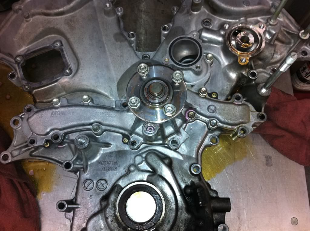

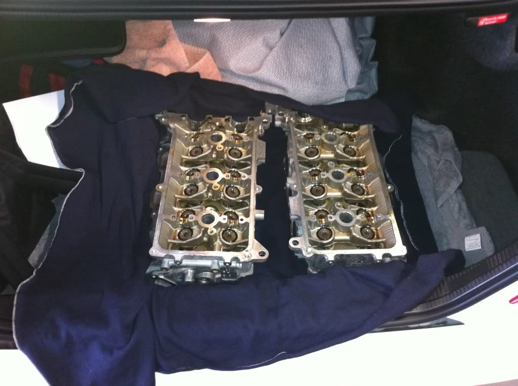

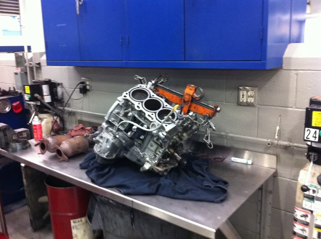

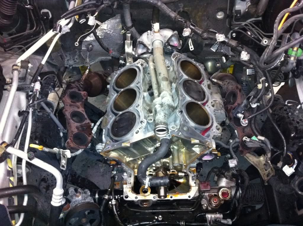

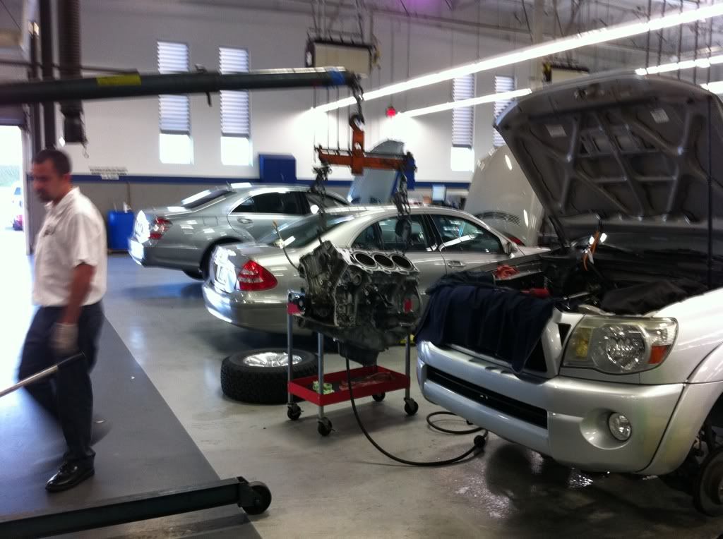

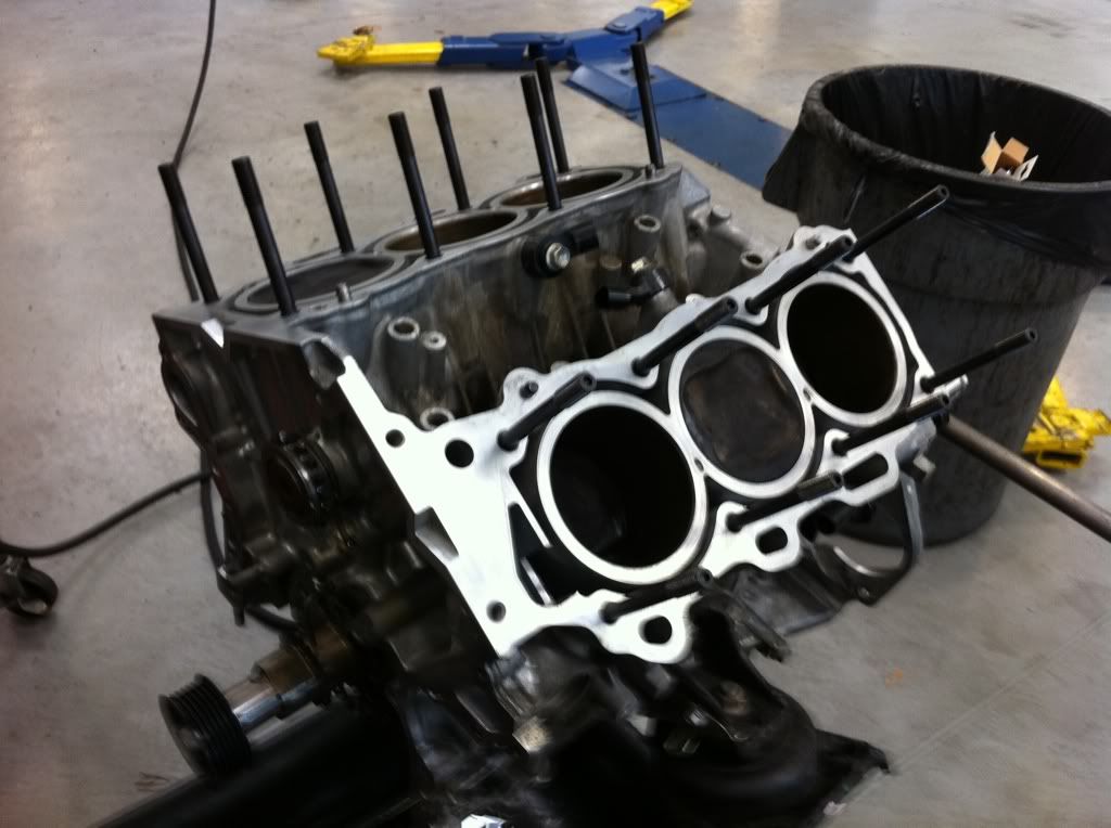

    as of today truck is all done here are some pics of the process. the only thing not factory is the arp headstuds i installed in the block. truck runs great.... i had the cylinder heads resurfaced and pressure tested. everything checked out ok..... glad truck is going again
    I have a 2005 tacoma 2wd 4 door auto. Ok my truck has 105k miles on it and its been supercharged for about 50k miles. It is the TRD kit. I have had not problems at all with the supercharger. About 30k miles ago i noticed a slight coolant smell. I popped the hood and found that coolant had come out of the overflow and if you have seen how it is designed when it overflows the fan hits it then it goes everywere. Not the greatest design. At this point i had not seen the tempature rise above the normal level at all. I didnt think much of it and just cleaned the mess up. Didnt have another problem for awhile. I made a trip out the the river and found that when i was headed there the same thing happened. The truck was really being worked i had my stand up jetski in the bed and towing a boat. Pretty much constantly in boost with the ac on. Anyways i took it easy the rest of the trip and found that on the way home the temp did rise above normal levels but when i would stay out of boost the temp would stay at normal levels but would still make the coolant overflow. When i got home i replaced waterpump, thermostat and radiator cap and obiously all the seals and replaced coolant. it seems ok now... has anyone had a similar problem. Not really sure if the problem is fixed because of the fact that i really havent driven it in the same conditions.

    the heads are off the truck definitly more involved than i thought due to the fact that the front cover of the engine has to come off to take the heads off either way it is torn apart and heads are going to the machine shop tomorrow to check for cracks....

    ok so i am going to try to load some pics right now..... I pulled the motor apart and sent the heads out. today i decided that pulling the motor would be best to allow the assembly of the motor alittle easier.... im working on loading pics right now

    well i took the pics with my phone and have no idea how to get them on here when i try and load them to web hosting page it says invalid file type.... anyways i got the heads back from the machine shop today and they were not cracked so that is good and i recieve the gaskets tomorrow.... the arp headstuds came in so i think tomorrow i will start the assembly of the motor. ill try and figure this picture thing out....
