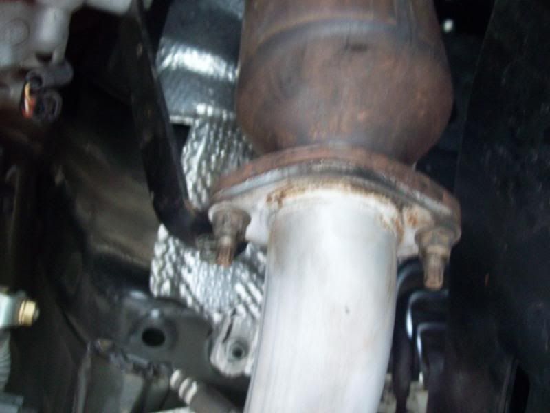

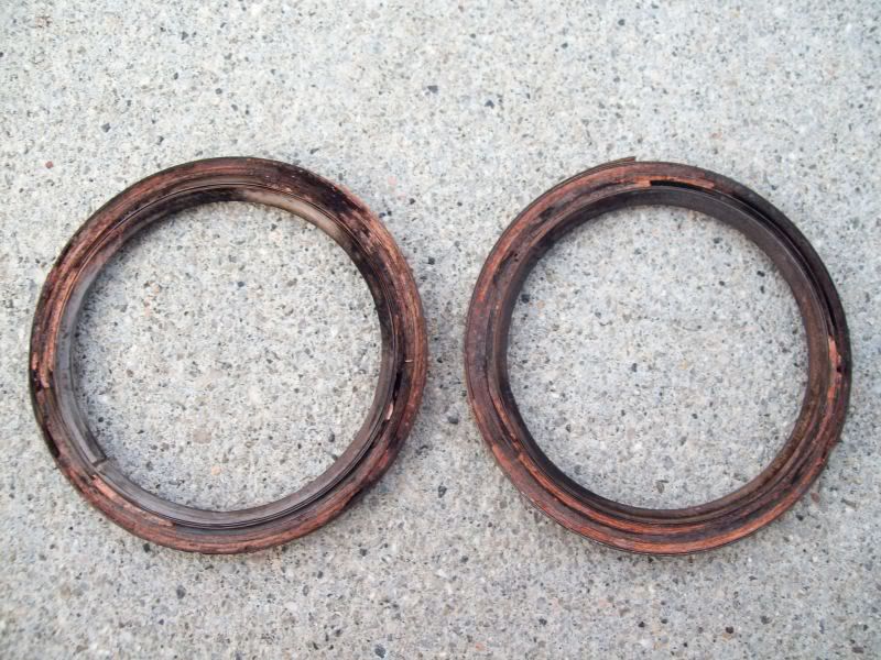

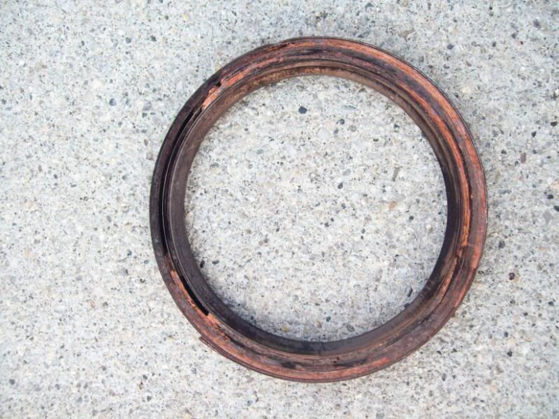

    So the other day i was under my truck checkin for leaks and saw some black where the y-pipe meets the first pair of cats, the driver side had more than the passenger side. this morning i replaced the crush gaskets with new OEM ones. it was tough getting the gasket to fit well since its an aftermarket y-pipe but finally got it to fit right

    Are you leak free now?

    I am now leak free :D
