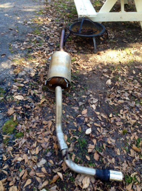

Removal:
1) Spray all the rubber hangers with PB Blaster. Let 'em drip a bit & soak.
2) Moved the truck to warm, sunny spot. Lay down tarp & some cardboard so as not to ding up anything during removal. (flat, dry surface, parking brake ON)
3) Remove spare tire (you'll need the room when snaking the stock pipe around)
4) Grab 15mm socket, loosen spring bolts.
5) Loosen rear hanger. Just work it a bit, it will come loose. Do the same for the most forward hanger. Slide under truck, parallel to stock exhaust, place legs on rear hangers, grab pipe and basically hump it until the hangers slip out of the rubber bits.
6) Snake it all out towards the front of the truck. This is where you need the tarp/cardboard whatever to keep from scratching stuff up. Probably a good idea to tape some cardboard or bubble rap over stock tip if it's polished.

Bye Felisha:
