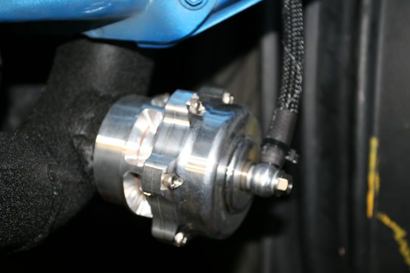

heres a lil update, I had about 2 hrs free today. the wg pipe has a mount, that bolts it to the transmission as extra support. You can barely see it in the picture
I got the muffler location, and my pipes came in a day late so I could finish the exhaust

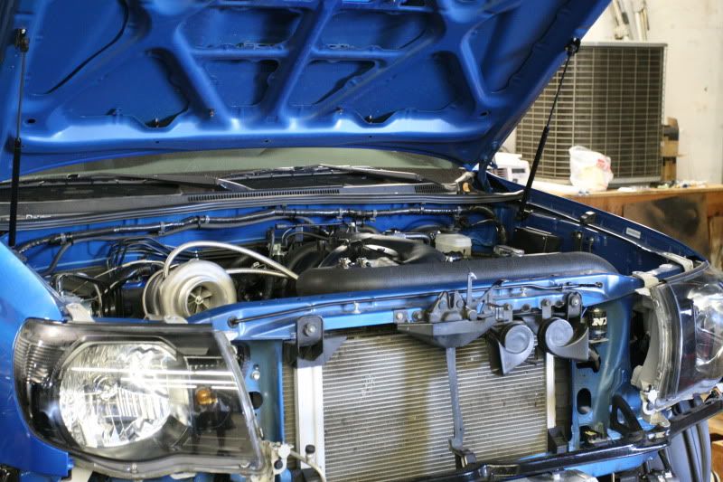

Is this all a part of a kit or how was the whole project planned out? How is the waste gate, ignition, and fueling controlled? Needs a new computer to manage the above variables?
I loved the turbocharging on the Cummins diesels I owned. In fact it would be awesome if Toyota put a small diesel (turbocharged) in the Tacoma as an option.

Are you driveing the compressor with only one side of the exhaust?

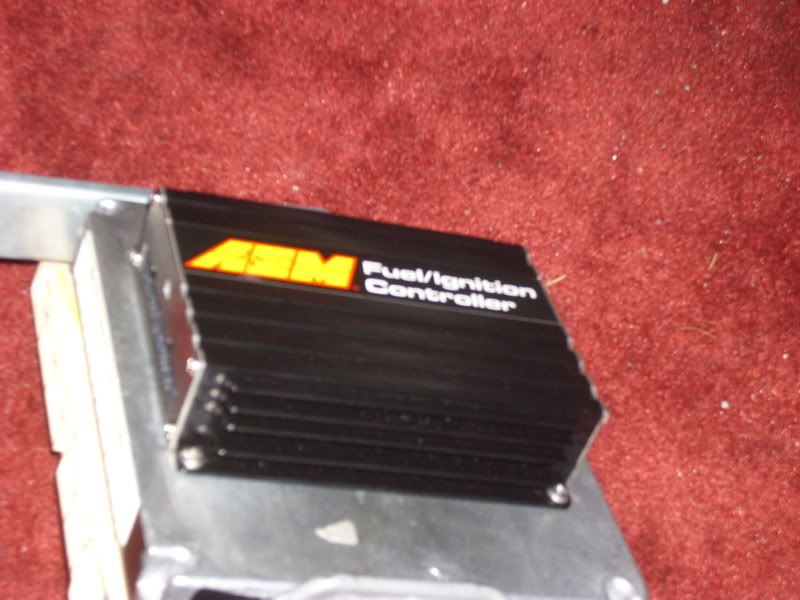

wastegate being used is a tial 38mm, 5 psi spring, Im using the apexi avc-r boost controller.
The fueling and ignition is being controlled/modified with the aem fic piggyback. The computer was installed approx 6 months prior to starting project.
Both sides are "spooling" the turbo. if you look on the manifold, you will see a 2" pipe that comes down, Thats from the crossover pipe. I will try to get more pics weds for you to help explain
