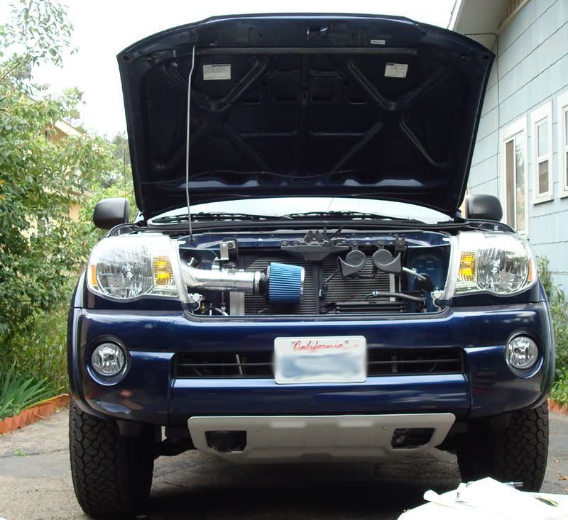

I finally got some time to install my TCAI. Its been here for about 2 weeks, just sitting in the box. The install was relatively uneventful. I really diddnt like the idea of messing with the MAF wiring, but it went smooth as well. Funny how much crap you have to tear out of the engine compartment. Anyway, i have the stock pipes and no MAF calibrator as of yet (its on order), but the engine sounds awesome anyway. Well worth the $$.

looks good i guess the rain wont hurt it

I live in Los Angeles. I cant remember the last time it rained. Regardless, I washed my truck last sunday and sprayed the hose directly through the grill. The truck ran fine right after.
The install was easy. Yeah I put the heat shrink on.
I was really surprised at the improvement in acceleration. This thing really moves now. My first thoughts upon accelerating onto the freeway was "this is how this truck should feel". Its very responsive, i love it. (My MPG is down cause i keep getting on the gas).
Im not worried about cal laws. Laws are for sissy la la's.

Nice install man. I've seen this before somewhere awhile back. You have anymore pics detailing the installation process?
Its really not that hard. It took me around 2 hrs at a relaxed pace. You basically rip out the old air intake, etc., detatch the MAF and extend the MAF wire harness, cut a hole in the front of the engine compartment and install the pipes.

It took me a while to do the install process because I check, re-check, hesitate, check and then finally get out the air saw. It probably took me about 3-4 hours to do the install. The instructions it came with were great. I couldn't have asked for much more...wait, did your intake tube go over one of the fluid reservoirs (maybe the power steering?)
