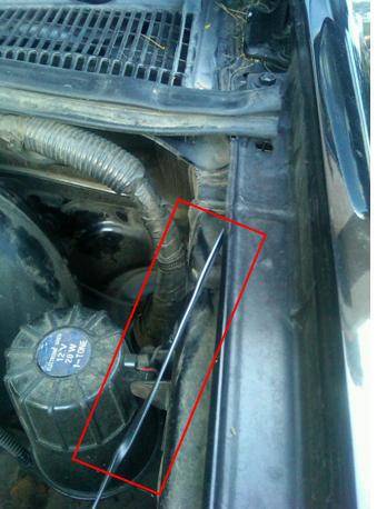

I used a different install approach than the ones already posted. I thought it was a little complicated to get the cables through the cab so I ran the wire behind the front panel through the door's rubber cover:

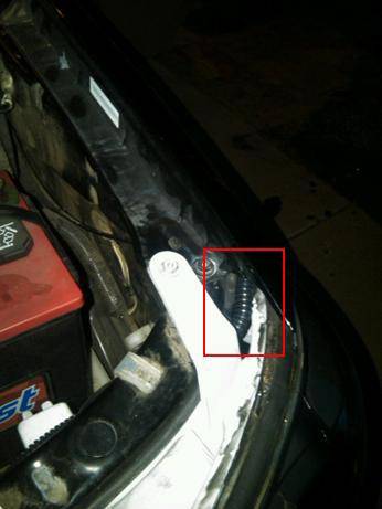

You can see from picture below how the wire is coming out. I know I need to wash the truck no need to remind me (see http://www.tacomaworld.com/forum/2nd...-question.html - how to clean engine compartment)

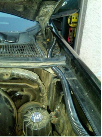

Since I live in AZ and it get pretty hot in the summer, I bought some wire felex tubing thing from walmart and covered the wire all the way.
At this point, all you need to do is unbolt the 3 bolts on the side panel: 1 by the wipers, 1 in the middle and 1 by the headlight. Pull on the panel and run the wire through the “void” area. It will run all the way to the front headlight.
