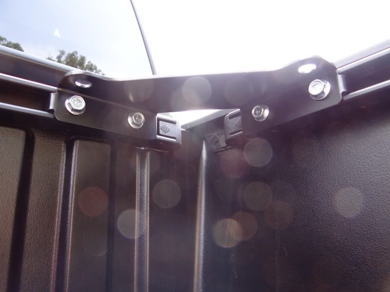

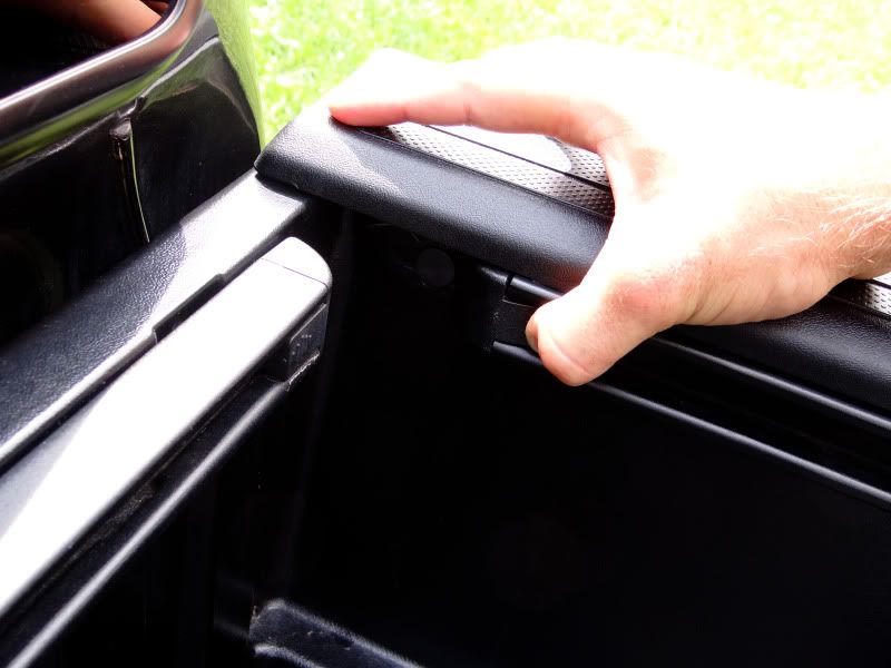

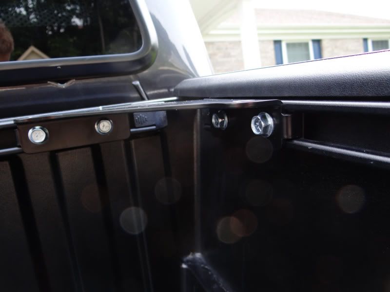

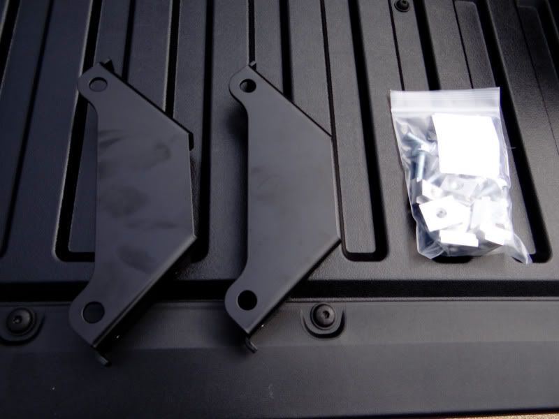

The installation is EXTREMELY simple. This is more of an informational guide with lots of picture to know what your getting when you decide to order the Hook-Ups.

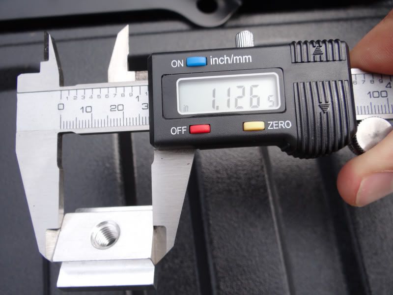

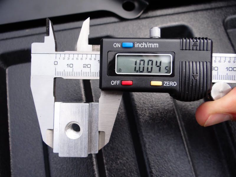

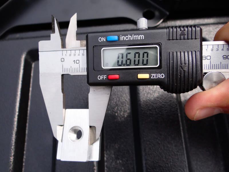

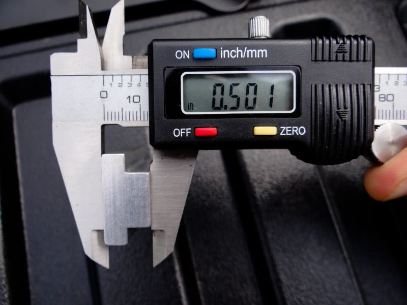

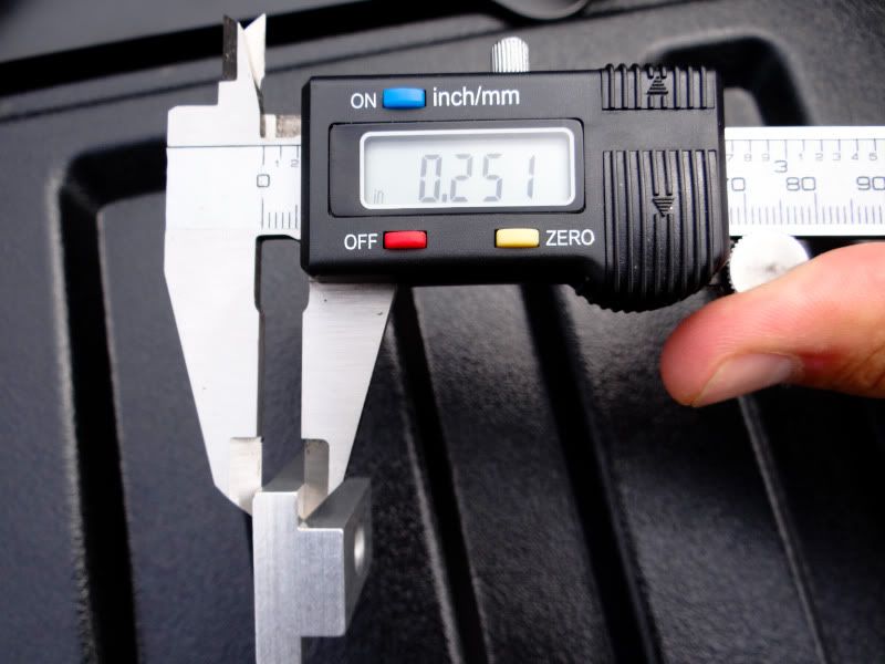

The brackets, bolts (1/2" head) and Aluminum Tee Nuts are all very high quality. Powder coat was well done (Although it would be nice to have a choice of color). Once tightened down, the brackets look stock.
Product Link: http://jpmetalfab.com/products.html
Kit Includes: (2) 10 GA. Powder Coated Stainless Steel Brackets,(8) Billet Aluminum Tee Nuts, (8) Bolts
Installation Time:10-20 Minutes
***I have not tested the Hook-Ups yet, but pulling on them they seem very secure. I will update post after first trip the the MX Track with a KX250F and CRF450R***
