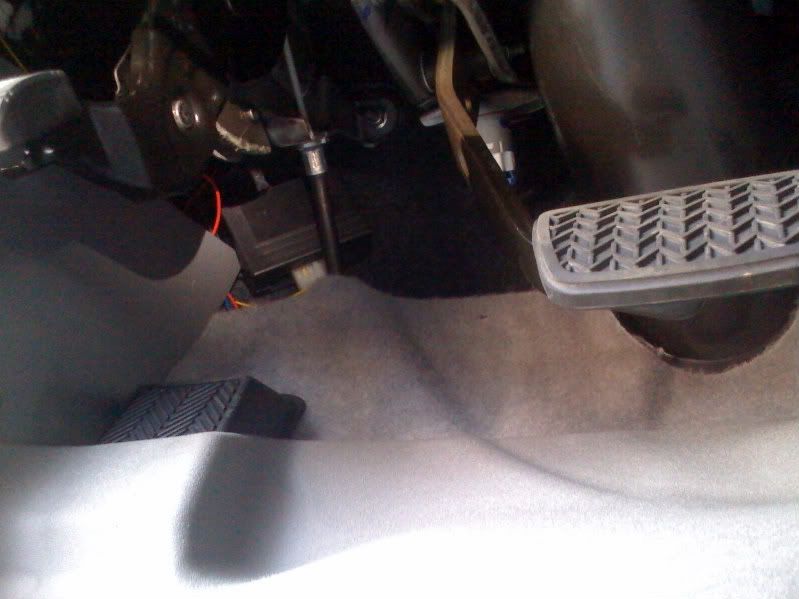

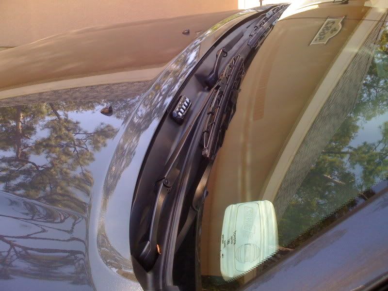

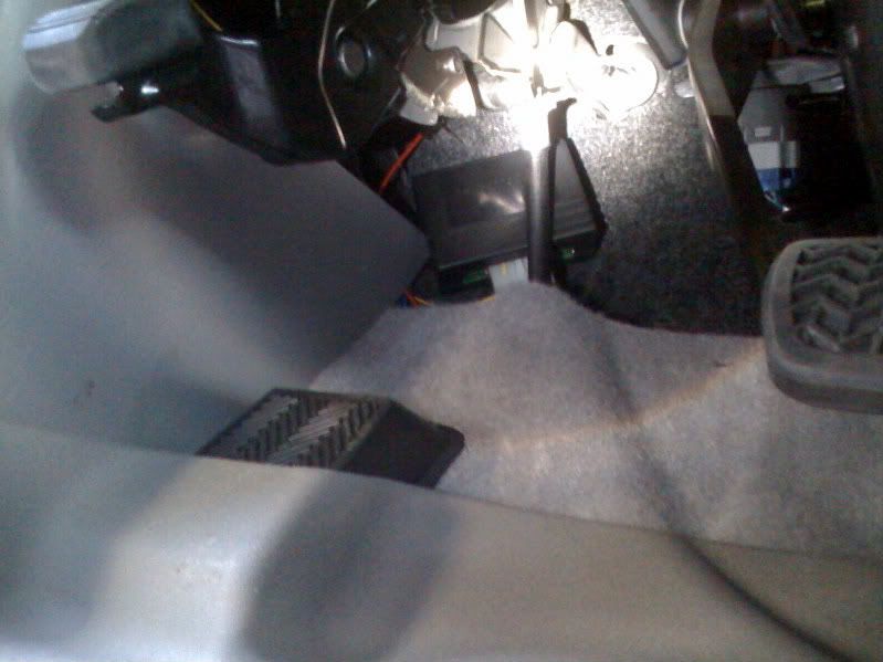

Here are some pictures of the wireless receiver installed:
It's a pretty clean install, most of the wires stay hidden behind the kick panel. The yellow wire is the antenna.

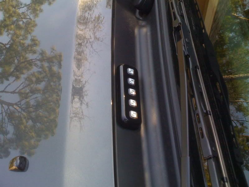

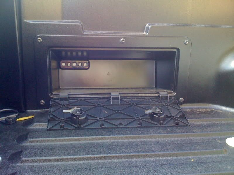

Here are a few possible locations for the keypad:
I just put some scotch tape temporarily on the back. The keypad looks like it will sit flush when installed using the double sided tape.

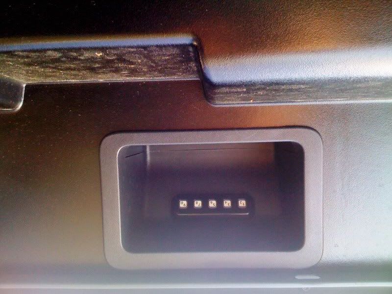

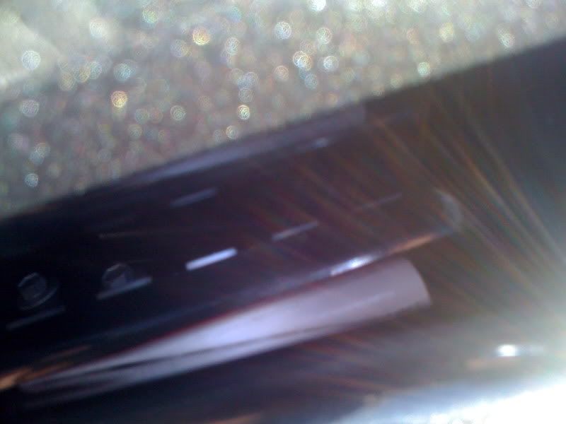

Backside of the hood:

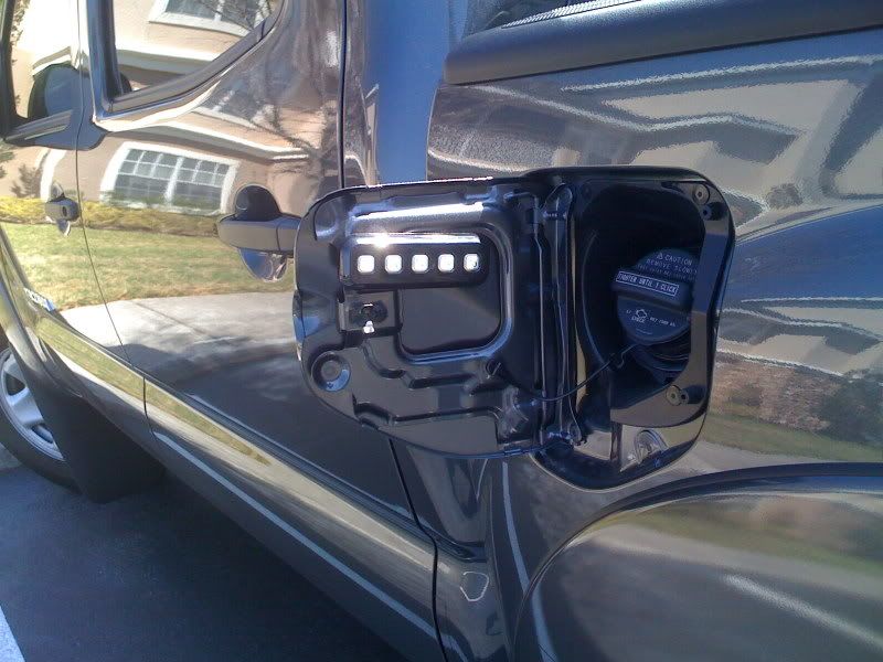

Inside gas cap, I didn't take the time to make it look good, but you get the idea:

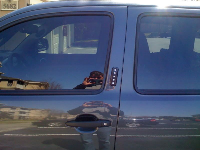

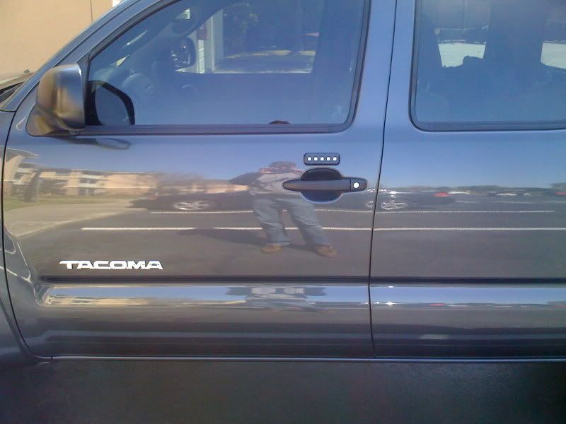

On the door, which I probably won't do:
A few more locations...

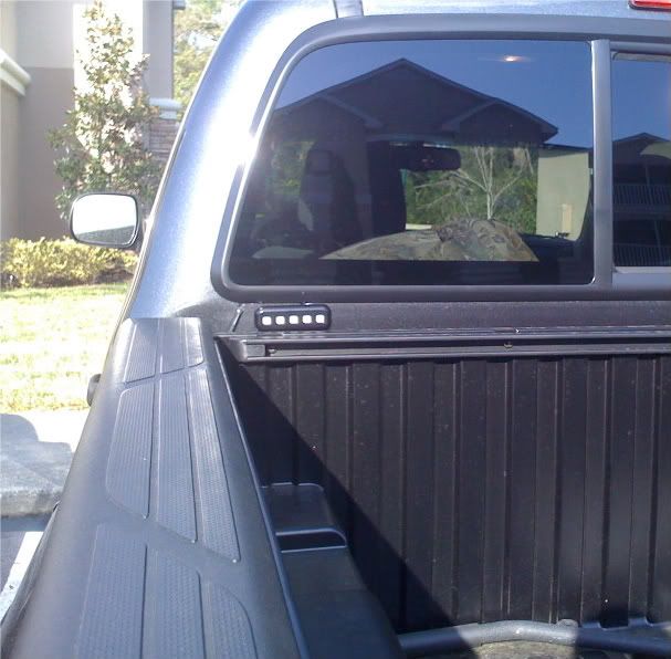

Behind the rear window:
In the bed compartments:

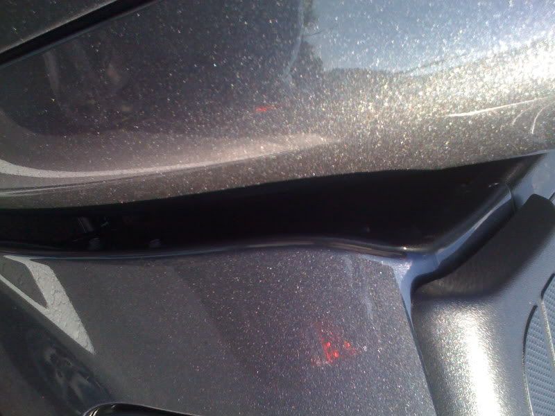

And very top secret, in between the cab and bed, you can't see the numbers so you gotta do it by feel, you really can't see anything:

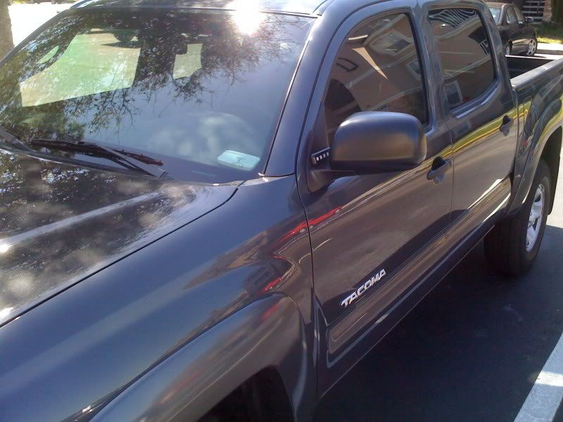

In plain sight on the mirror base, probably not smart, lol:

OK guys I added a few pics. Sorry if the quality isn't all that great, all I had available was my iPhone.

Nicely done. I'd mount it in one of the bed cubbies over the wheelwells.

Anywhere in the bed is out for me because I'm getting a fold-a-cover that I intend to keep locked.
I am still trying to figure out the best place to mount it.

Added a few more pictures as well as a warning to those buying this...
