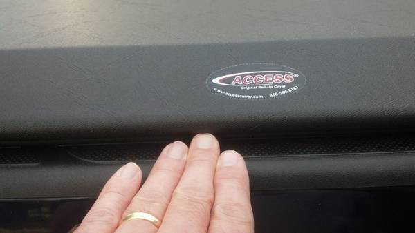

I have to say that overall I like it. The gap at the tailgate is far to small to slide even a childs fingers into. It reaches over the tailgate and has a vinyl flap that closes the gap. It does not matter which order I close the tailgate and cover. It's not 100% water tight, I took it through a touchless car wash and got a bit of water in it. I may improve upon the weatherstripping.

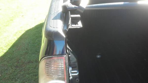

Also, you do lose 4-5" of bed width at the top of the bed since you remove the side rails and put spacers in it and then the tonneau cover. You do retain full use of your tie downs although I wonder about the sturdiness of it since you have spacers between the rails and the bed of the truck.

Here are a couple of pictures of the cover.

I assume it consumes the entirety of the bedrails, so you can't put the tiedowns/cleats in them?

Nope, you remove the bedrail, and fasten the cover rails between the bedrails and the side of the truck. You use longer screws and spacers that are provided. The end result is the bedrails are each moved in an inch or so but you retain full use of them. I can't remember off the top of my head whether or not the rear bedrail is blocked though.
