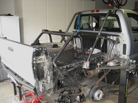

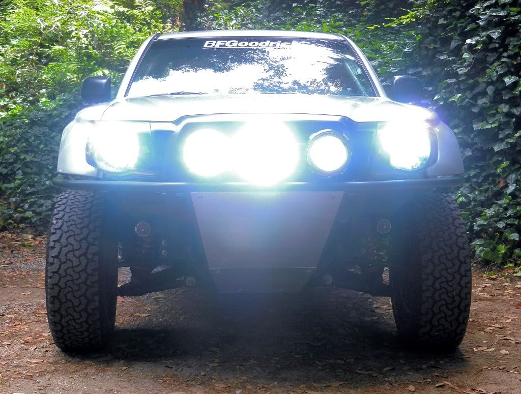

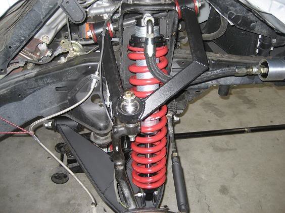

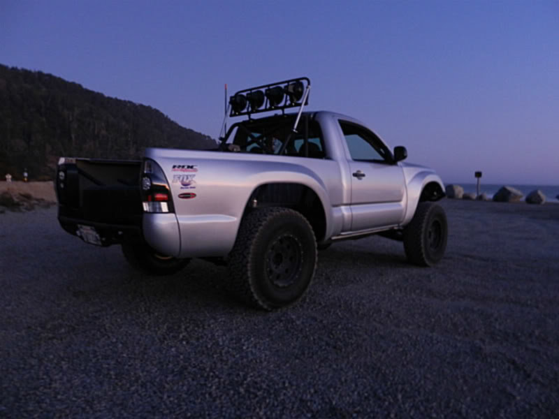

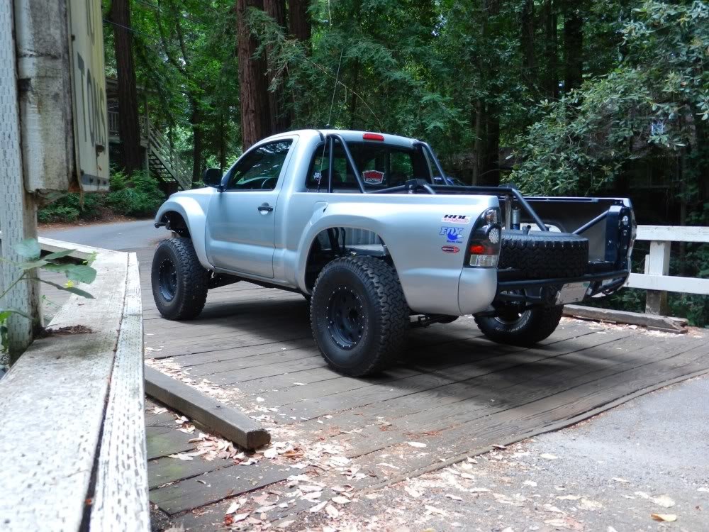

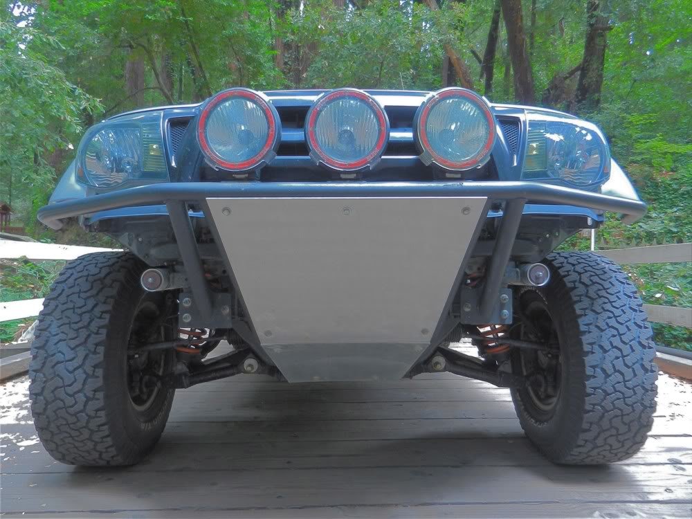

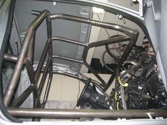

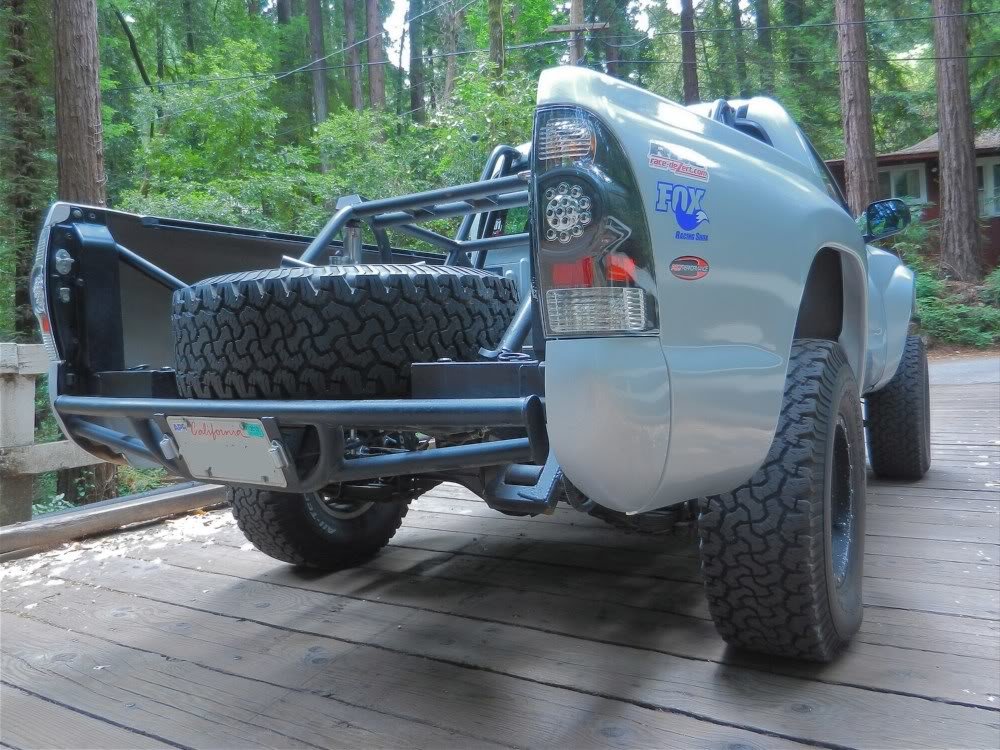

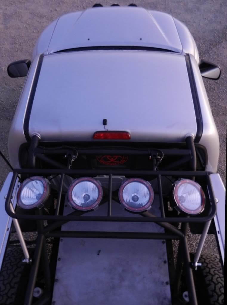

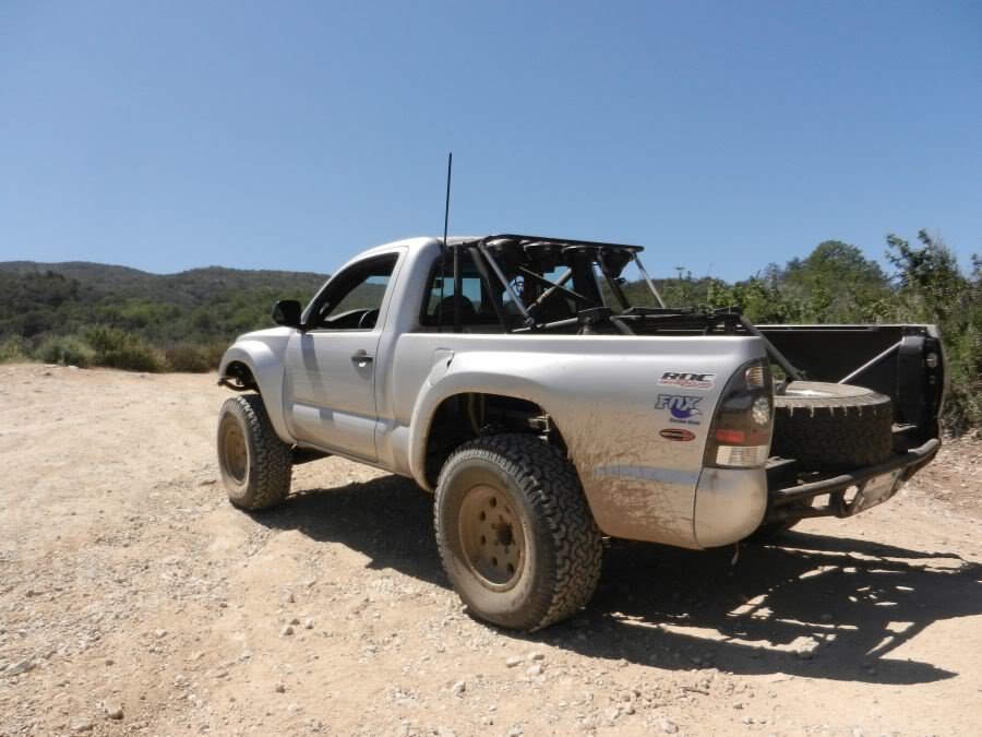

    Some of you may recognize this truck. The original owner completed ALL fabrication work so far.
    It took him a little over 3 years to complete. I now own it and I will continue the build.
    2005 Tacoma Prerunner 2.7L Regular Cab manual
    Suspension and Fabrication:
    • Custom bed cage that ties from rear bumper to in-front of cab
    • Custom cab cage 1.75" .120 DOM
    • Custom Lower Control Arms
    • Custom Upper Control Arms
    • Custom sub-frame
    • Custom front bumper with skid
    • Custom rear bumper
    • Frame is C-notched in the rear, boxed and plated
    • bed plate (for storage)
    • reinforced alignment tabs
    • strapped front & rear
    • 2.5 " FOX coilovers up front and 2.5" FOX 2 tube bypasses out back
    • 2.5 " FOA bumpstops front and rear
    • Deaver f67 leaf pack
    • Custom shackles
    • Custom spare tire mount (positioned for balance)
    • Beefed up engine mounts, cross-members, and other areas found to be weak.
    Aftermarket Parts:
    • Glassworks Fenders
    • Glassworks Bedsides
    • Corbeau racing seats
    • Jones racing 2 chamber exhaust dumped under cab
    • 3 7" HID driving lights 6000k
    • Black LED tail lights
    • Rockford Fosgate door speakers
    • Rims: 16X8 AR Mojave 4 1/2" BS
    • Tires: BFG KOs 295/75/16 i.e. 34"
    • Optima Red Top
    Additions I've made so far:
    Additions on the way:
    • SDHQ Battery box (ordered)
    • 2 5 gallon Gas Jugs and mounts (in progress)
    Wish-List:
    • 4.0 V6 w/TRD Supercharger
    • Engine cage
    Note: I have permission from the original owner/fabricator to post his pictures of his work on this thread.
