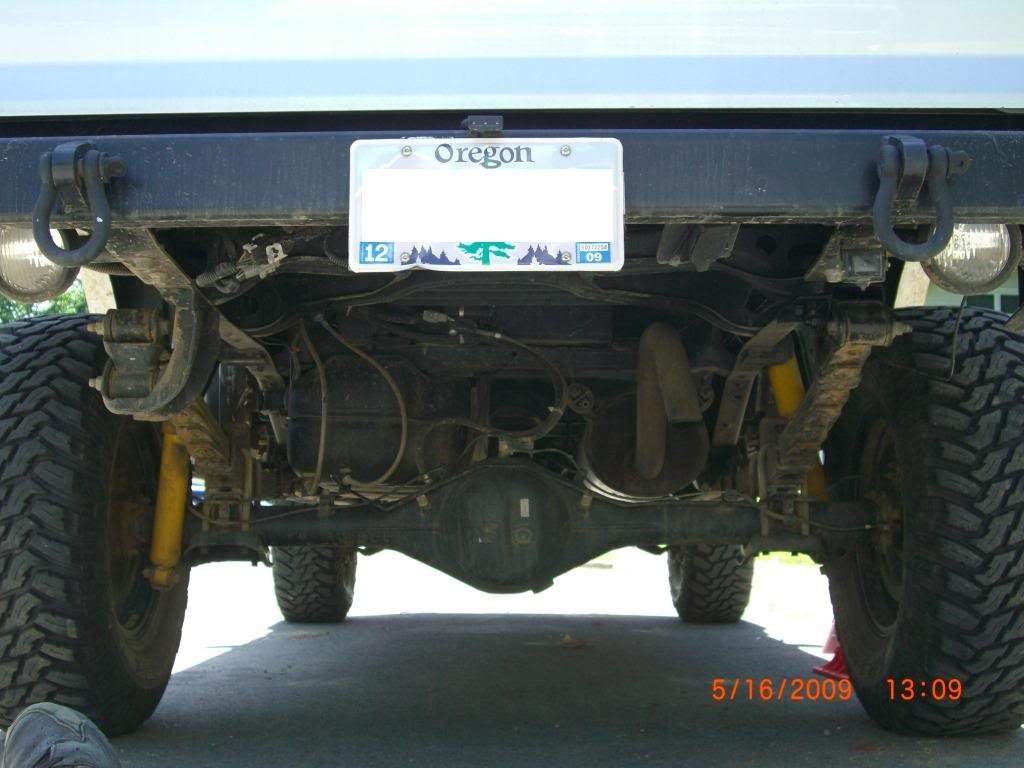

    Edit - ATO has a pretty good side-by-side pic of before & after flipping the shackle:
