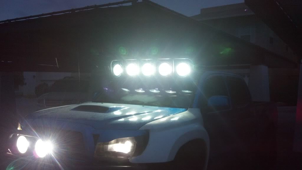

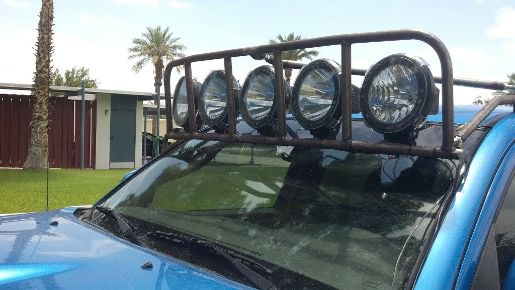

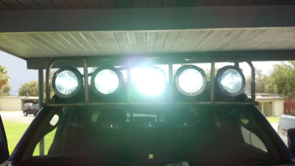

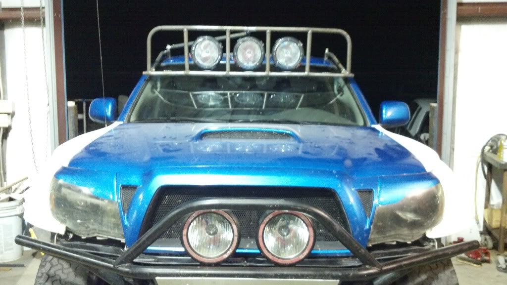

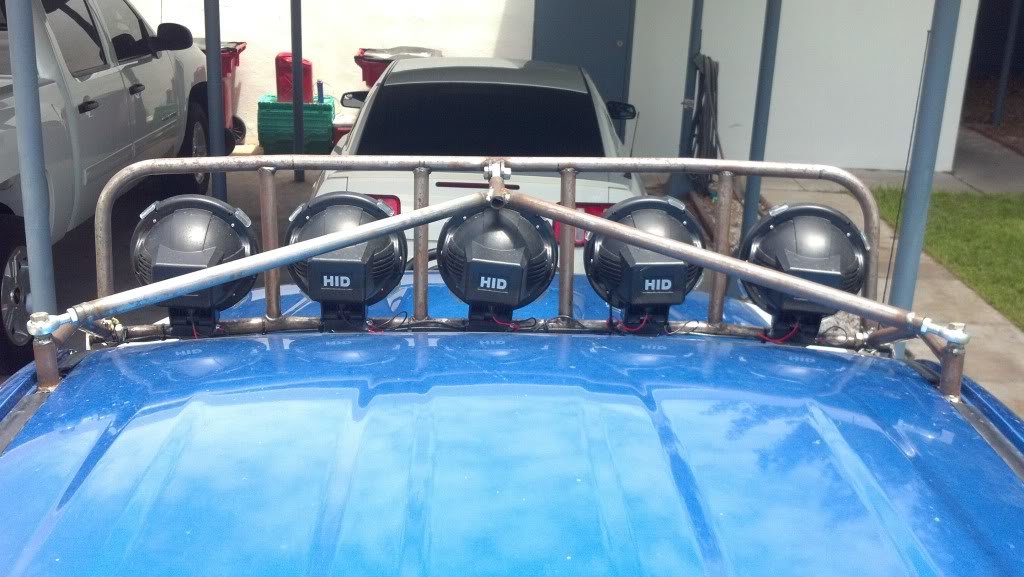

    Hey guys just want to share with u the light rack that was just fabricated by my friends shop.
    1in .120 wall mild steel
    Fully adjustable through hiems joints
    (5) 55w hid. (3) spots (2) floods
    Going to be powercoated here soon.
    Was short 4 ins on the driver side cross member also have to weld in so bump tabs that wedge in the gap between the cab and windshield. Which will be done today hopefully.
    Lights wired and on. The 3 spots and 2 floods are wired to their own switch. Everything was wired properly to relays.

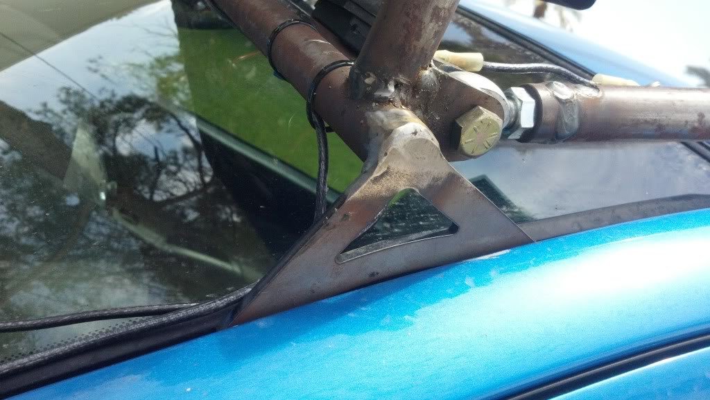

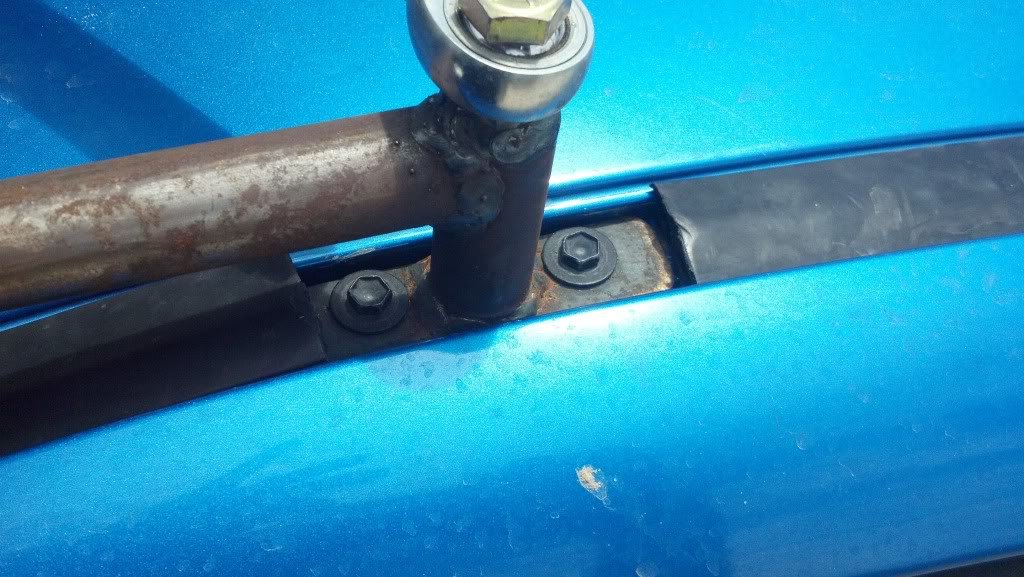

    Mounting for those who have asked.
    Factory threaded roof rack holes. 10mm
    Those feed into a wish bone to the center of the light rack with adjustable hiem
    Triangle gusset to apply relieve pressure off if the roof mounted bolts and it eliminates bouncing and wiggling

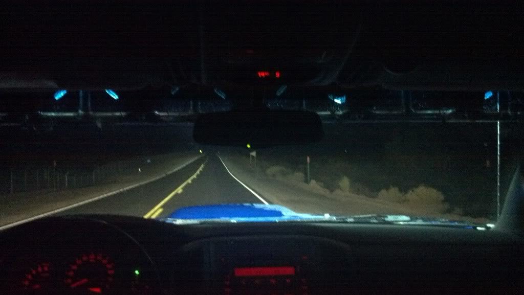

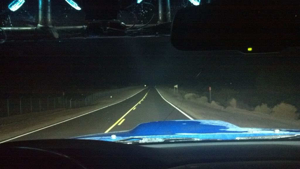

    Night view from cab
    Back seat
    Front seat
    Light output probably a good 3-4 football fields if not more ( bad judge of distance) but its way out there.

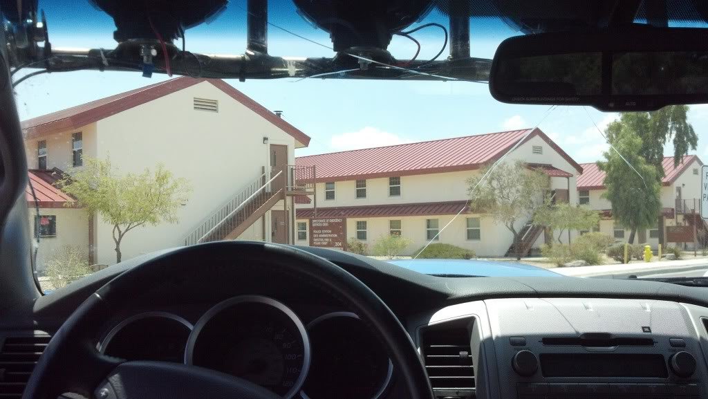

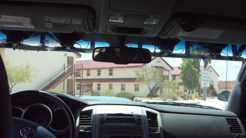

    Daytime view inside cab (backseat)
    Front seat headrest level
    For this interested in maybe purchasing one I can talk to the owner and see what the pricing would be. Maybe set up a group buy of like 5 a piece or something.

    Hows the view with it over the windshield like that?

    Not bad at all expect I can see the bolts lol but u can still see everything good

    hows the glare with the lights like that? thats the only reason why i put mine on the back of my cab

    Cool rack, I don't like things in the windshield frame of view though. Looks very well made.

    It wasnt that bad when i turned it on last night. Ill get some pictures up tonight of what it looks like from the cab
    I sent him a message today and he said he would put put together a price on them. this thing is super firm and unbolts with 4 bolts and 2 wires from the relay for easy removal.
    the view from the cab isnt that bad it like driving with the visor down IMO.

    You will be surprised how much steel flexes. I would bet money if you hit a high speed bump that is going to smack the windscreen.
    You might want to look into getting two more points of contact to the roof for that.
