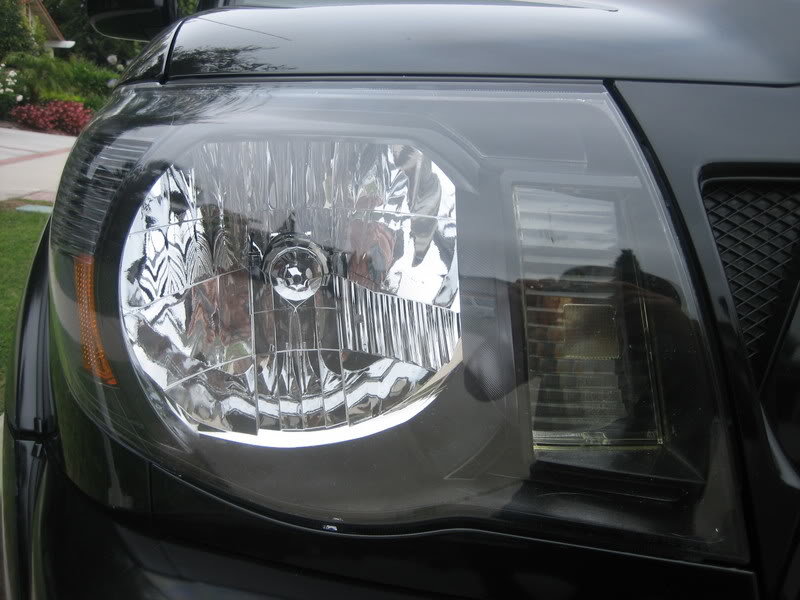

    Alright guys, heres some pictures of the finished headlights.

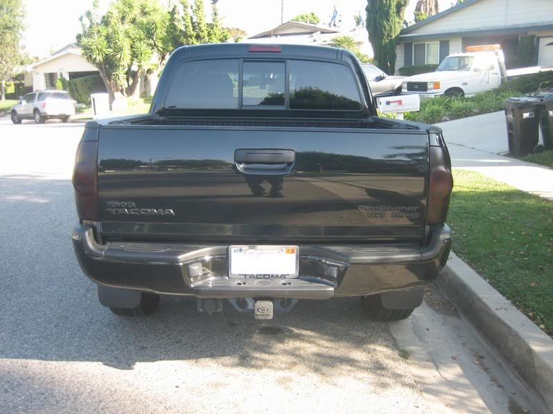

    UPDATE PIC 1/25/08 of black emblems and blacked out tail lights

    the lights look good, i'd love to do it i just dont trust myself enough. What chrome are you painting black? thats the only part i'm really unclear on.

    Headlights look good man, I am way to lazy to do mine. :D

    that front pic looks just like my truck, except i removed the amber reflector...but the black and the black T emblem look exactly the same

    Hey guys a shortcut on taking your emblems off is just use dental floss, but get the good stuff otherwise if you get the cheap stuff like me it will keep breaking on you. I learned this technique from a professional and it sure does save you time. Then you don't have to worry about breaking the emblem or chipping your paint.:D
    Spencer, your truck looks almost as hot as mine, lol. I highly recommend you to spray tinting your tail lights. Its extremely easy and cheap that looks awesome.
    I think that would look damn good on your black Tacoma, it looks pretty good on my silver Tacoma. If you want any more info on the spray tint, just give me a message and I'll hook you up! Its at modernperformance.com.:cool:

    hey thanks alot man, i actually just ordered some niteshades spray last night haha. i asked jhodge about it and was chatting with him last night, he actually told me you had the same tail light tint so i went and checked your pictures out. your truck is pretty sweet, im hoping the niteshades comes in before tuesday, im leavin for hawaii
