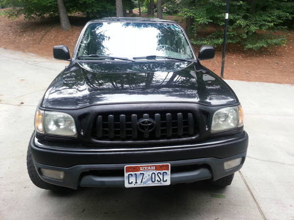

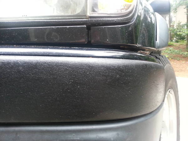

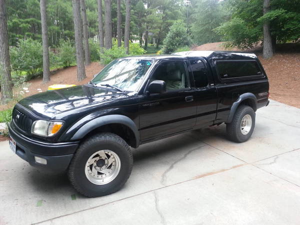

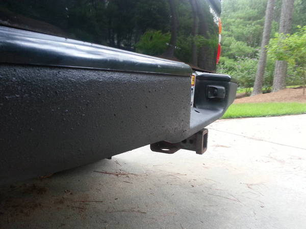

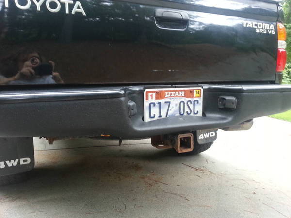

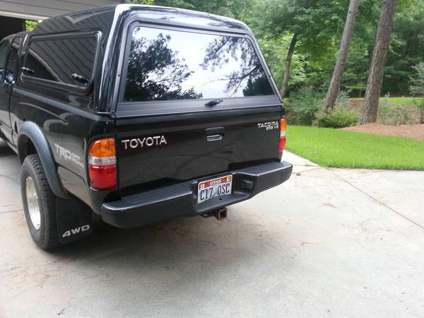

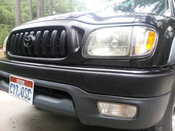

    Hey folks! Yesterday I bed lined my front and rear bumpers as well as my grill. Only chrome left on my truck now is the emblems, and those will be taken care of soon :D I used duplicolor bed armor, picked up a quart from autozone for about $40. I prefer painting on by hand rather than spray painting, just personal preference. I put about 3 coats on everything, and used about half of the can total. As far as prep work I didnt go too crazy, I just cleaned everything real well, sanded it down a bit, and then did a final clean with some lacquer thinner. The grill I took off to paint but the bumpers I left on. There's some minor imperfections, but overall I'm happy with how it turned out. Here's some pictures:
