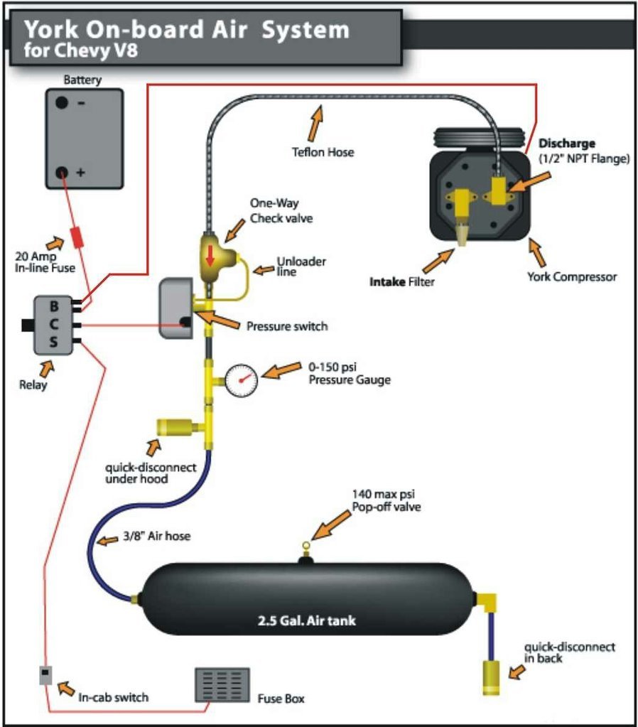

    Also found this diagram... little less confusing for some....(me)

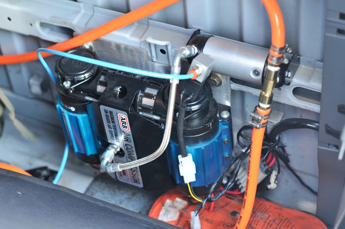

    Hey grimm, does yer pump ever get hot behind the seat? I was lookin n think if I pull the plastic under one seat it will fit in the storage location. Jus wonderin how warm it gets inside the cab??

    Heres where I ended up, still workin on the plumbing and wiring tho...

    Hey Talon, are you not afraid that it will get too hot in that spot? I remember when we were airing back up with your uncle Chris's compressors overheated and shut down after airing up 6 tires (had 2 to go on the Jeep). His is in the engine bay.
    I would think you could fab up a box under the bed. Then it would be protected from the elements and out of the cab.

    I had talked to mr grimm, he tested his for me (behind the seat) he ran it for 10 min n said it didnt get hot jus the air line out did... we'll see, im gonna keep a close eye on it... but u did give me an idea, jus build a box n lower it a few inches in the same location... hmm?? N ya im rockin the box for now, but not permanent
