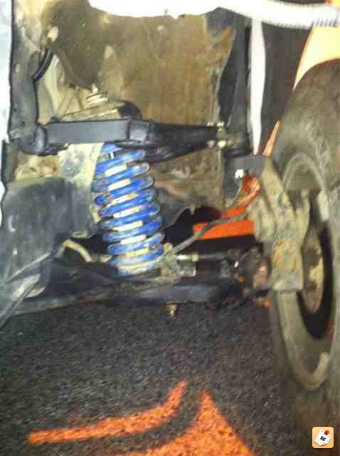

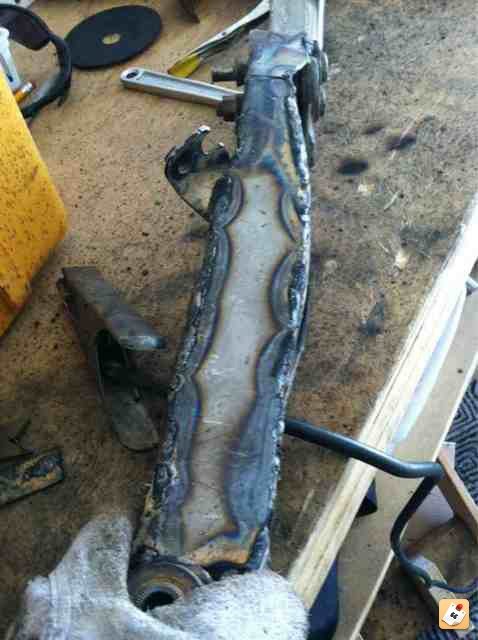

    Im posting this because i have a 1996 tacoma (5lug) and love being in the dirt. Not asking advice, if your like to give constructive advice, go for it, if not. Just look. I also want to show those who may not have the means to buy a $3000 lt kit, or just want to build their own stuff. This kit currenty cycles 13.5 inches of travel, strapped and bumped at 12 to save the BJs. Made out of 1/8 plate and 3/16 plate welded with a lincoln 110v welder. All built with $150 worth of material and a brain. Used a grinder and a cutoff wheel to make the plates. First set held for 2 months and is still going strong, im building a second set with what i learmed and bc i have coilovers now.

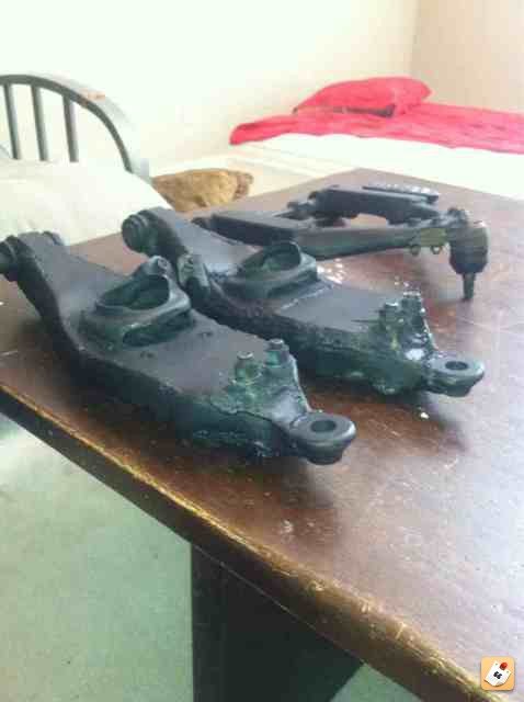

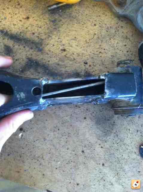

    asese8a3_5159b2c5e5af7fad14e111b3cce336a65314f844.jpg first kit, the lowers are 1/8th boxed, uppers are 1incj soldi rod boxed with 3/16s

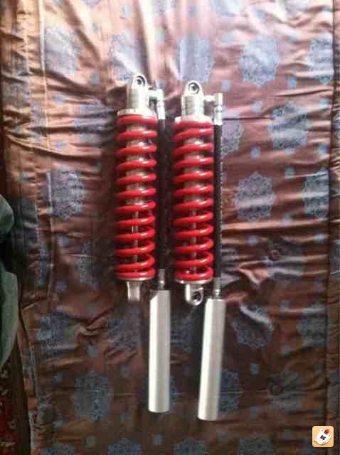

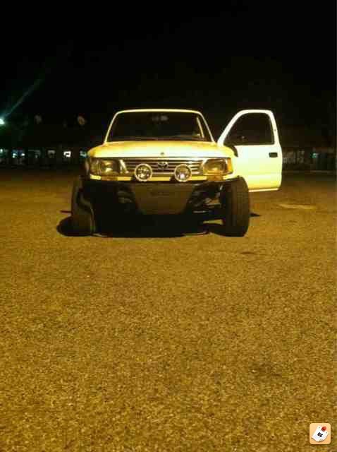

    9a7e5a8a_984f5a508fd62a84aceeea55084681ab18e80e01.jpg full droop

    This kit held really well for being my first ever fab job, i extended them using 3inch box still, just cut, extend, weld. The welds were crappy though and the design was flawed, so before i crashed my truck i decided to revamp the design, build all new lowers and buy coilovers

    crap bolted and welded together....
    interesting.... GL with it!

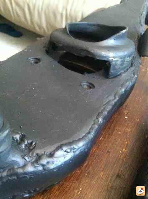

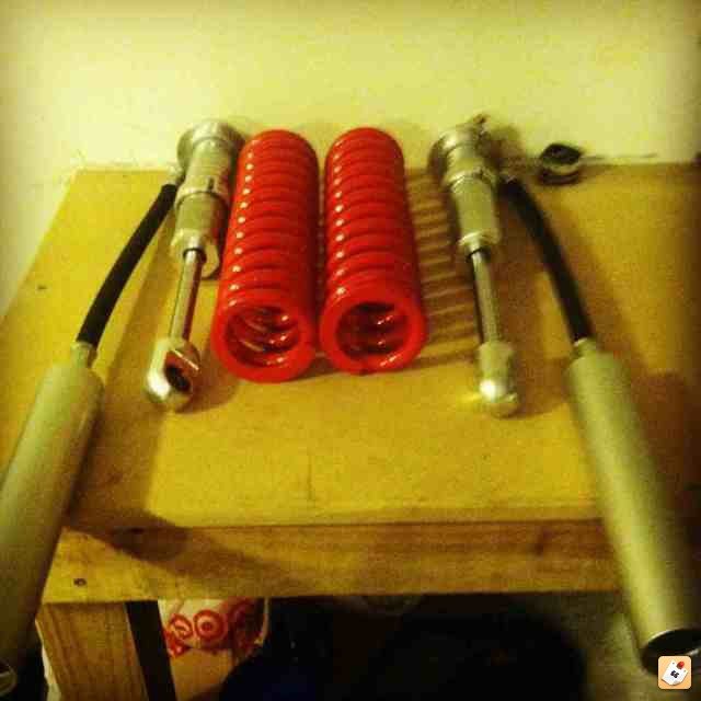

    su6a4u8y_f29d7b223f54088f0364e19217e00ccec7ddcdcb.jpg FOAs and viper coils (500lb)

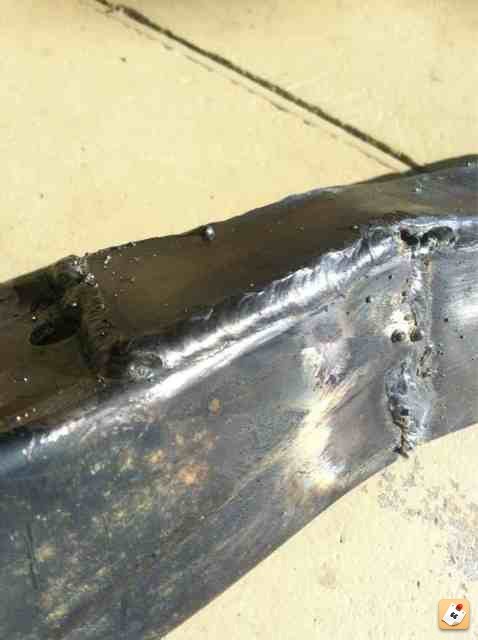

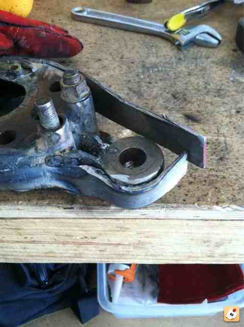

    yqa7ega4_d09b924e4f80e49a7e9427fb0c4fb77de65c0a90.jpg cut and extended in a more structurally sound area

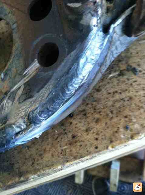

    u4yvubu6_21b3ccd14c4516a9bd06ccca201f220cd94d7c13.jpg weldings alot better
    2azetevu_bd495e2e07c4d3abbe306aedfa8b6a0220934395.jpg good penetration

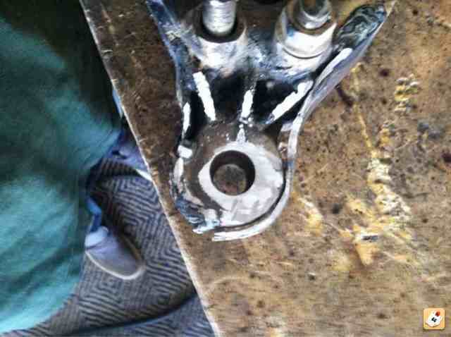

    re8e5uju_95edcd790f9a2cd773552a7fc98324352de7eb02.jpg this is the part that always breaks on these trucks, reinforcing it like this helps ALOT as long as you get the bracket hot

    Thanks man and yeah for sure ive been fabbing for about 6 months now,i never claimed it to be pretty haha but it works well for what i do and it will just get better. And the uppers are cut and extended with 1inch solid rod boxed in with 3/16 plate just for those who havnt seen the other thread

    vepa6ugy_da60aa54fd4653f319bea7ac5a26ac21df6135cc.jpg finished the bj bracket gusseting today, its not pretty but its strong. My last arm i only plated the sides and top and it held, so this will be able to put up with bigger tires and a 130lb increase in spring rate.
