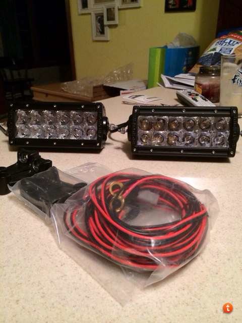

    I Purchased a set of 6" Rigid e series lights from S4RSSS (thank you!) and had installed today.
    I really want to thank Louis and Justin for fitting me in last minute and making the install a success!
    Louis is the man to call if you need help with any upgrades on your truck!
    Lifts, wheels/tires, lighting, remote starters, or anything performance related. Very attentive to the details and is a wealth of knowledge when it comes to performance and upgrades.
    (203) 512-4088
    Justin is THE best tint installer I have met and highly recommend him. I have used many installers and he is by far the best. Great guy to know and has lots of good contacts in the auto world.
    (203) 648-0116
    Solar Shield
    Both of these guys have shops in the Danbury, CT area, so if you are near the area, I highly recommend these guys. Tell them you heard about them from TW.

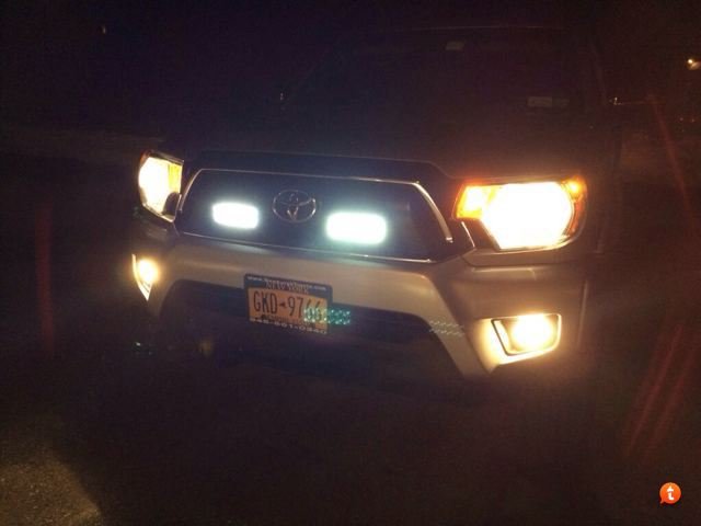

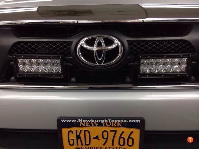

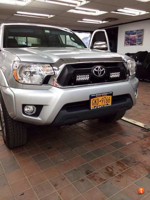

    I choose to install my light in stock grill for now until I upgrade. Came out very nice! I will be adding a support below mounting point for addition strength. I couldn't wait so this is how it looks so far.
    The lights are great! Very bright! Spot version, so the light path is very tight.

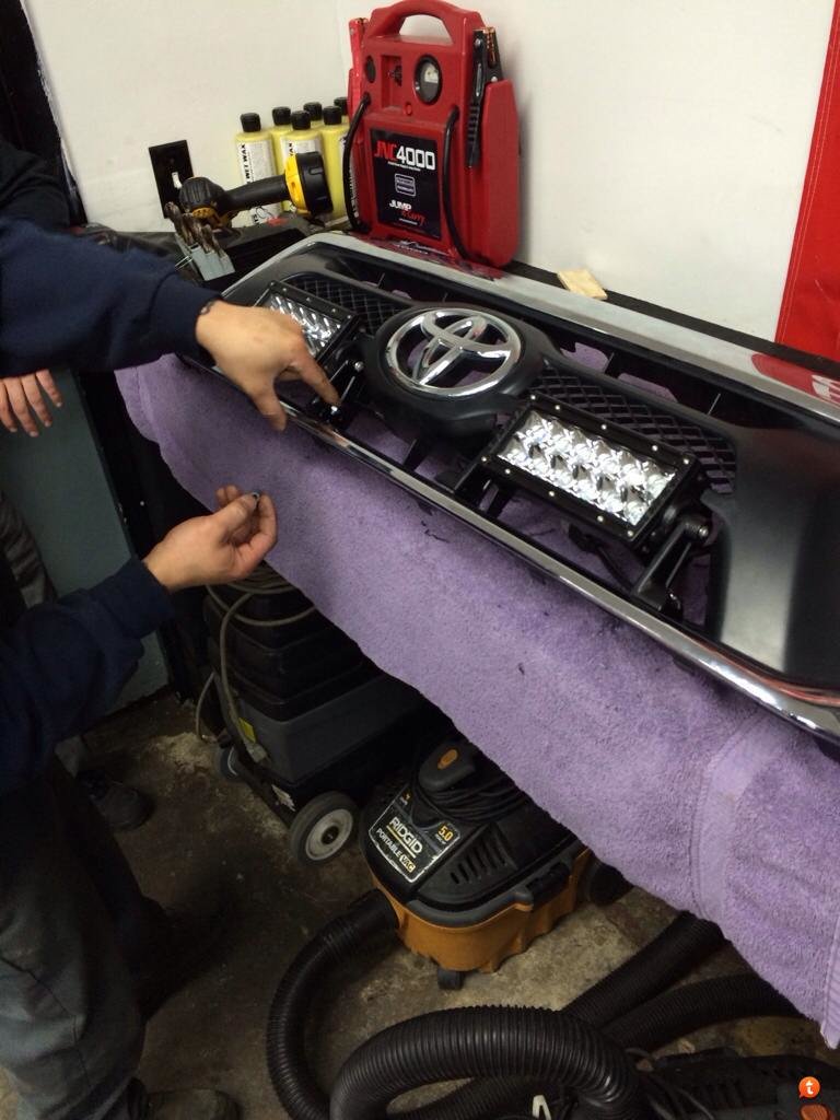

    Looks sweet, Do you have pics showing mounting. Thinking of doing the same.

    nice mounting position haven't seen ant like that before

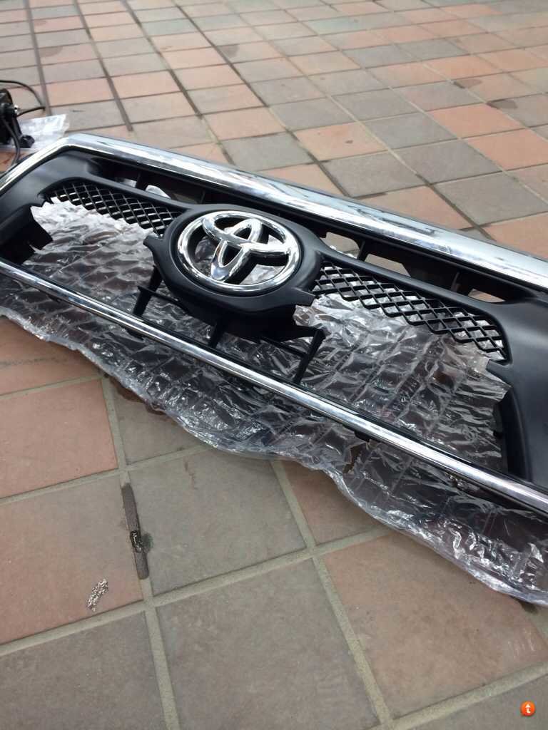

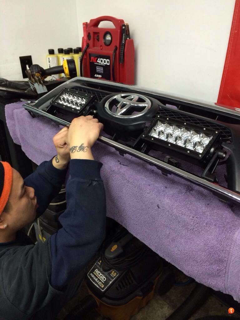

    Thanks! We mounted brackets to base of grill. drilled 4 pilot holes for brackets and used 4 bolts with nuts to secure. Don't crank down too hard as plastic may crack. I also suggest adding an aluminum bar underneath plastic to help keep lights secured to plastic grill.
    Holes in the grill were cut using a sawzall and a handheld mini hackzall for precision cutting. We used a black sharpie to trace out placement of light as needed. Took about 2.5 hours total from start to finish.
    Here is the only other pic I have of mounting in progress. upara6e5_8ca42b06d8cffa4c34ed98ba4606c8c1d827a7c1.jpgenateta2_33e8bbe5aab33dfd23e93986cbdb97cf53572dd4.jpg
