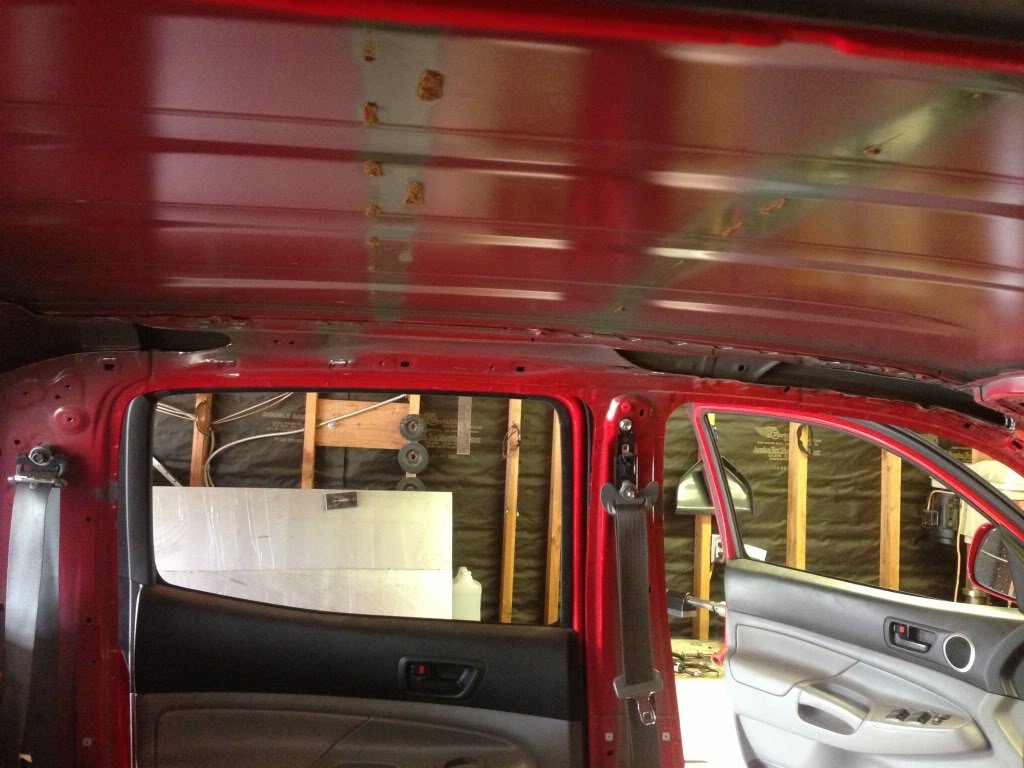

    Got it all stripped down so I can start figuring out where to put all the tubes.

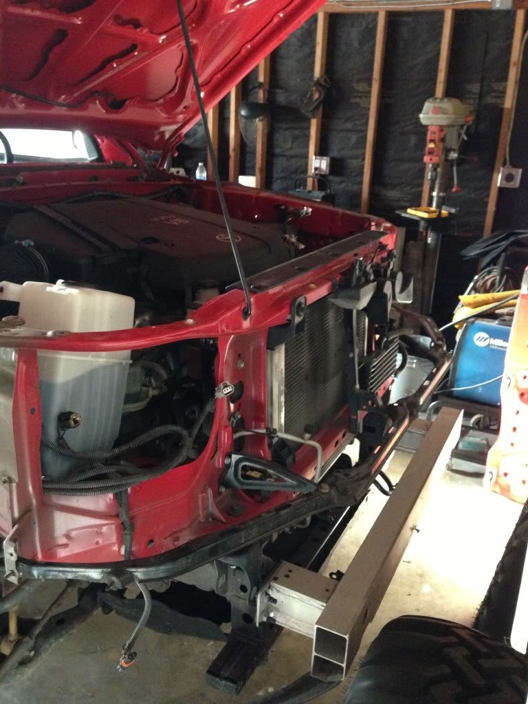

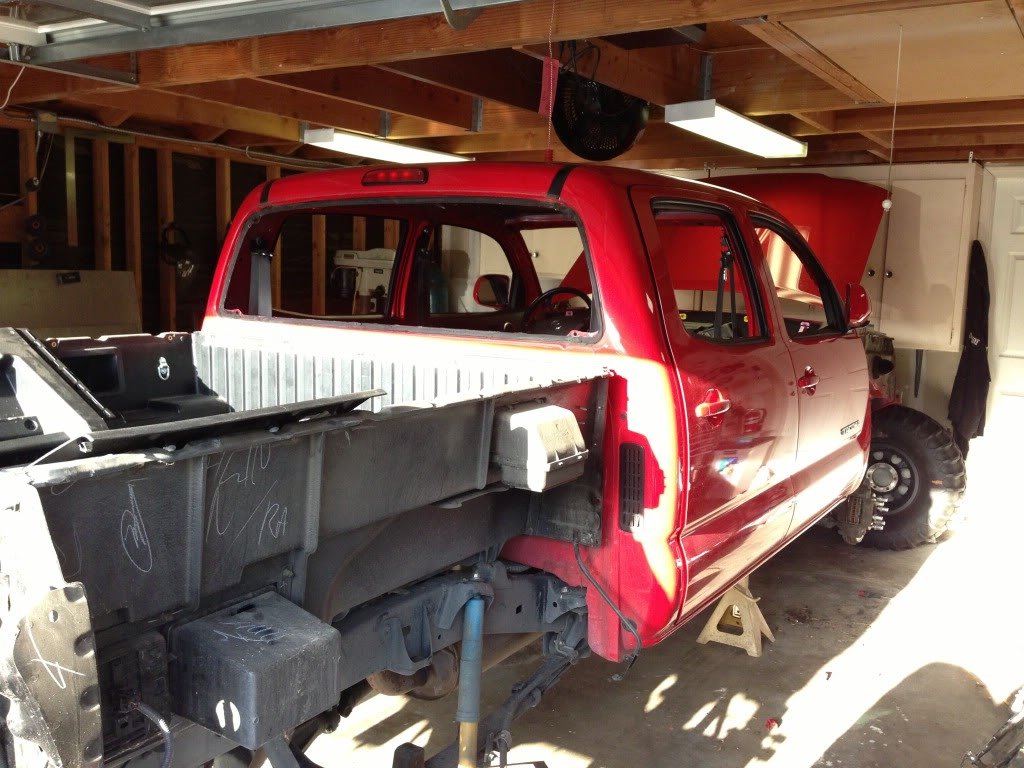

    Got the fenders off the front and rear too
    96ECC27C-85C6-4E2B-9B74-D9CEDEF30D13-373_61541466ea52c7d3f270d47ca6506fa4754afcbb.jpg
    B8E941F1-F103-4F5C-BEF9-82A3D478C130-373_18ac5d50c3c256ccfd2c4969cf5685dabbd36a2a.jpg

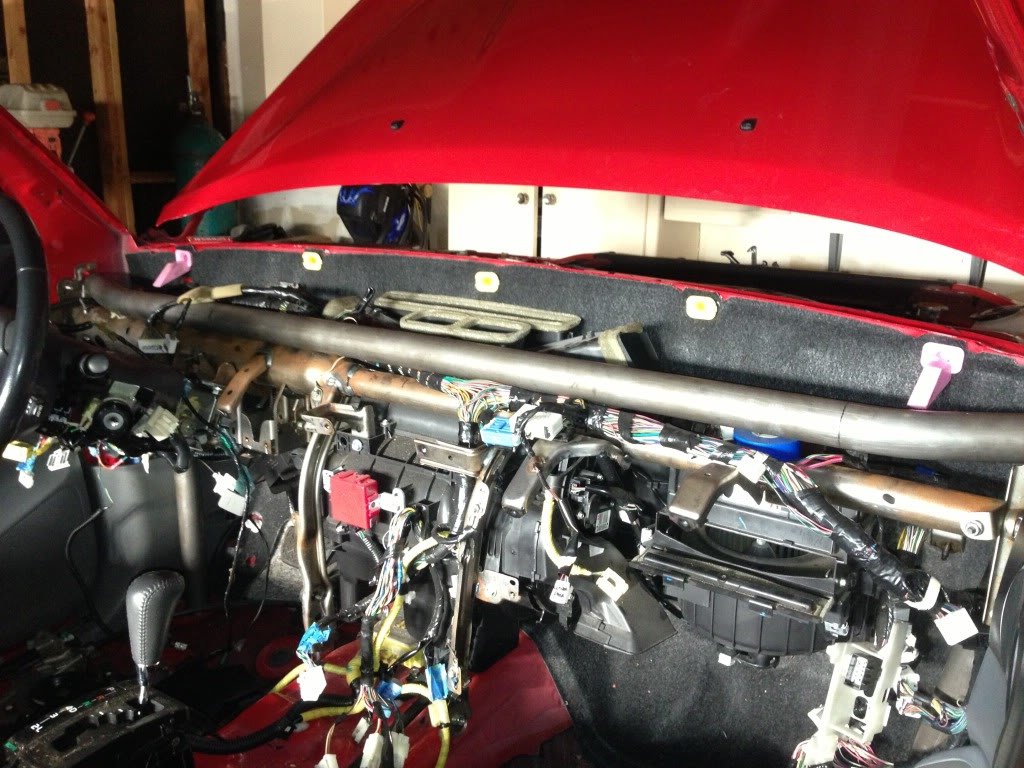

    Dash bar got bet up and put in place
    1111AFC9-3C8A-451E-8621-D5E8E465DB1A-433_1e090c2ee342528f2d1c78bef0ee14c89ecab86e.jpg

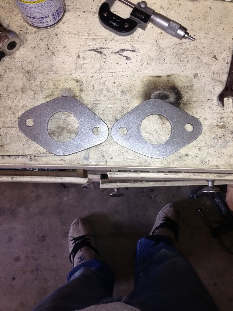

    Plates made for where the a pillar goes thru the front body mount

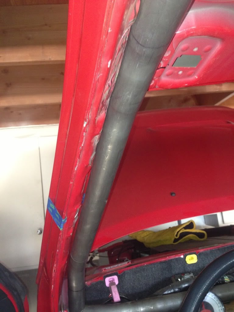

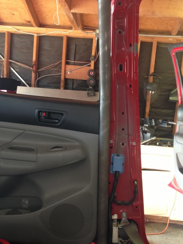

    34012821-0F15-412B-893F-1A79D98980CF-433_3fe020b8f227d96624cc423007fbff7387768691.jpg

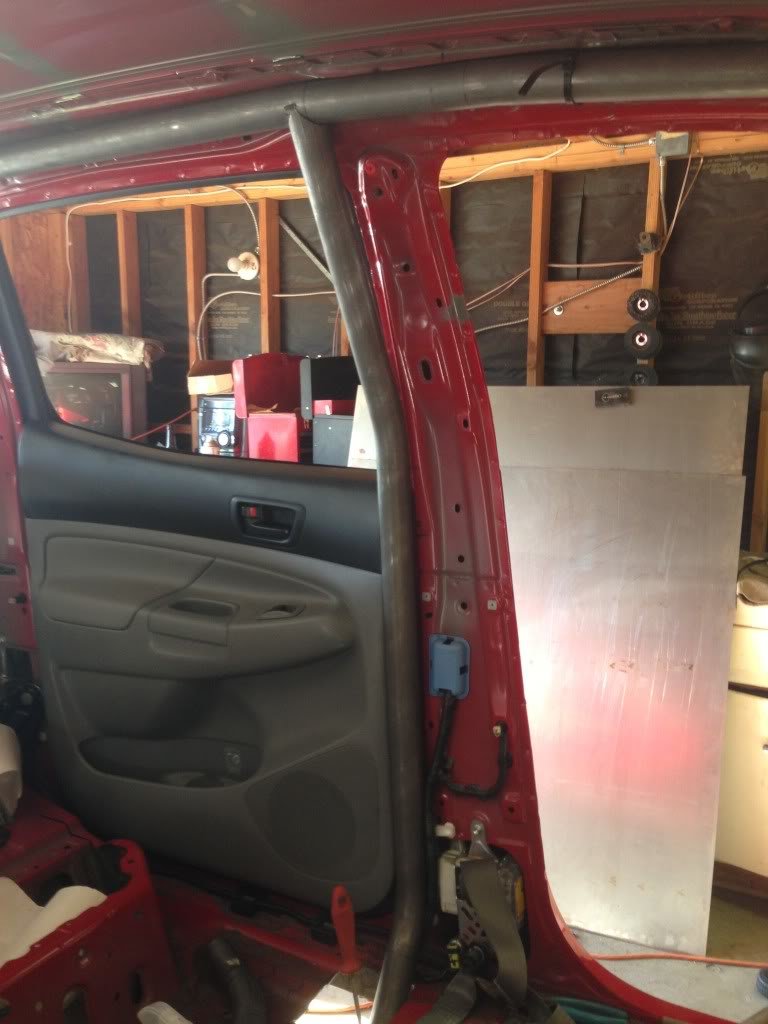

    A pillar is nice and tight. Pic makes it looked sleeved but its actually 1 piece from the dash bar back
    1178E8BE-DEE2-458E-9223-3FC74F8FB81F-127_2ef5b4b0880cc7d4685e143fbbc6f6b35a4098e2.jpg

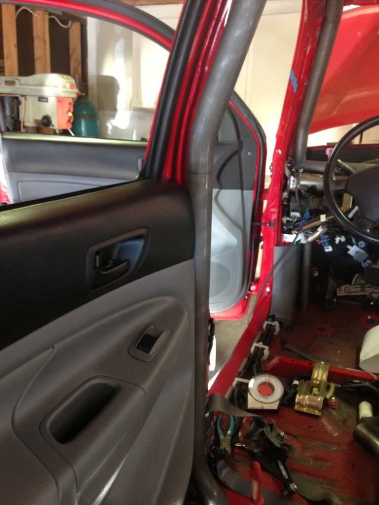

    B pillar tucked in

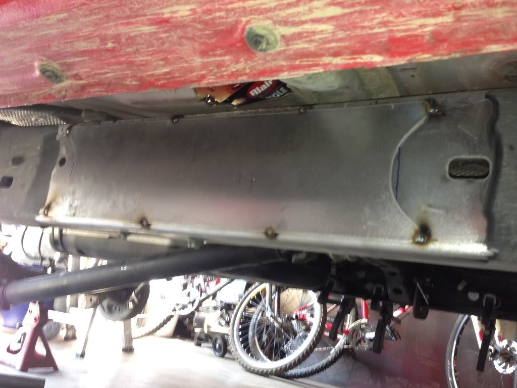

    Frame plating for the b pillar and link mounts. The carrier bearing crossmember also ties in to this plate too. There are no extra holes in the plate for more weld surface because it will be done on the back side using the factory holes in the frame

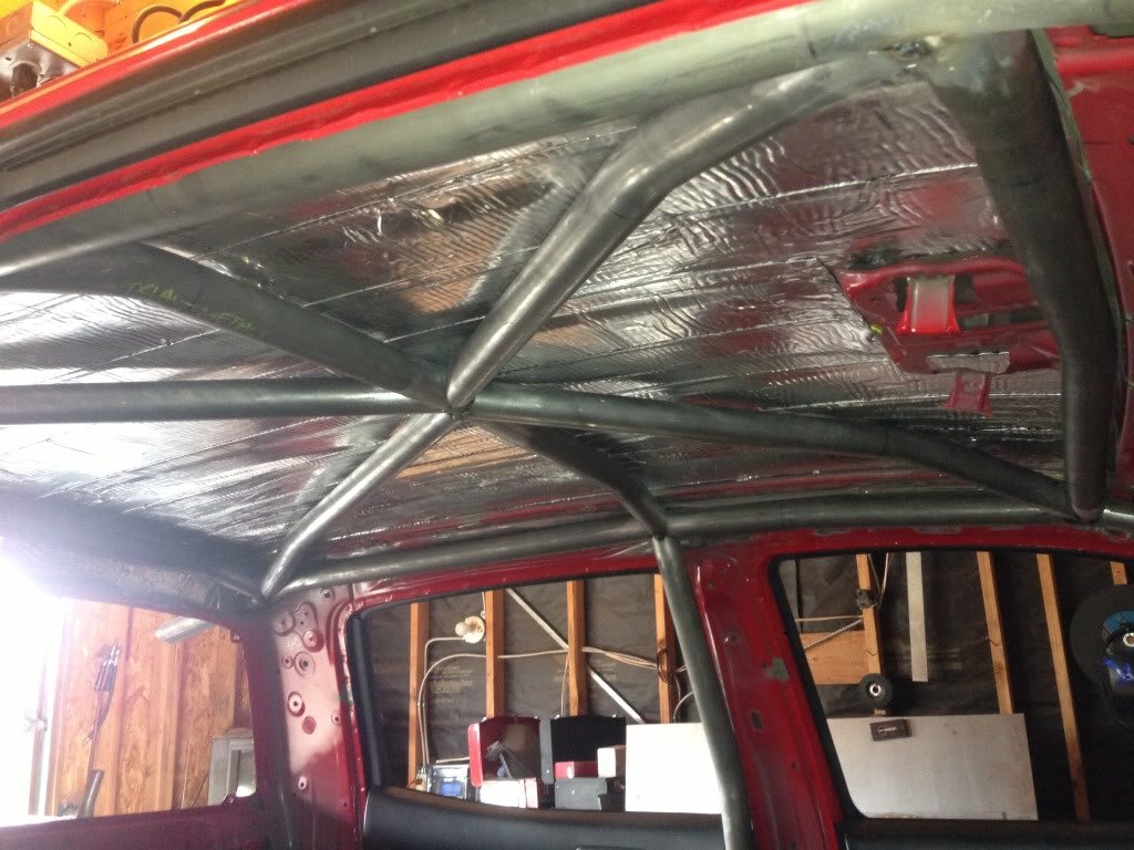

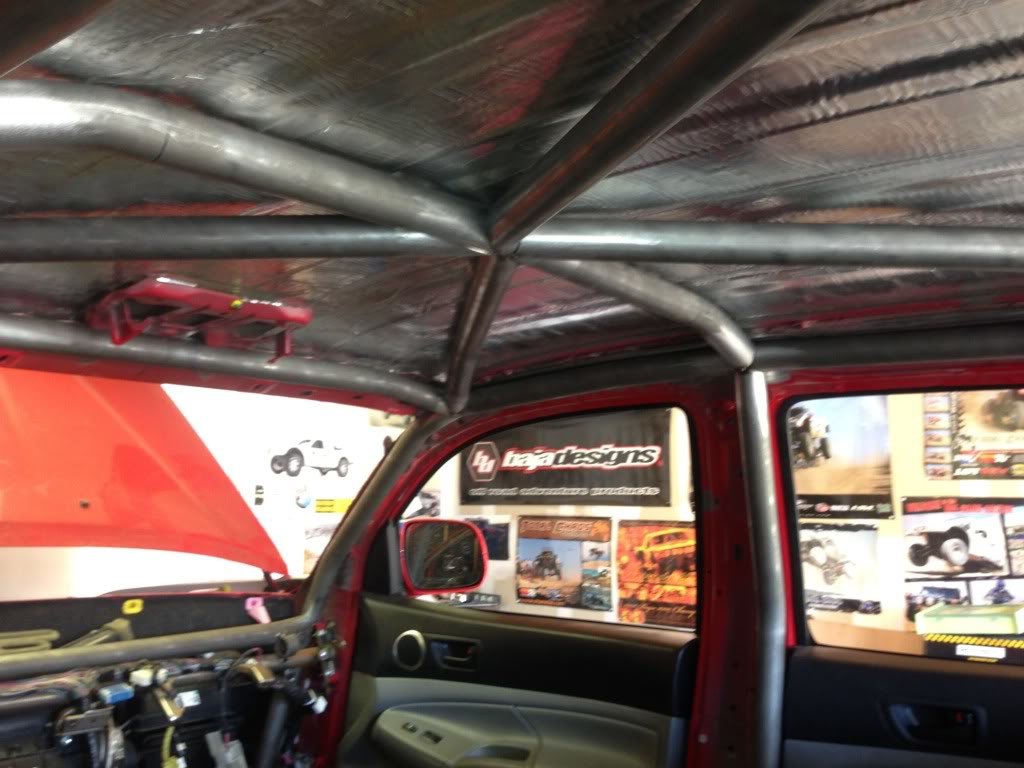

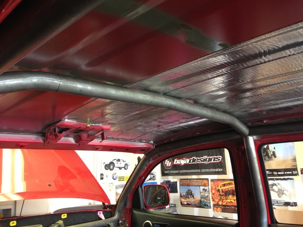

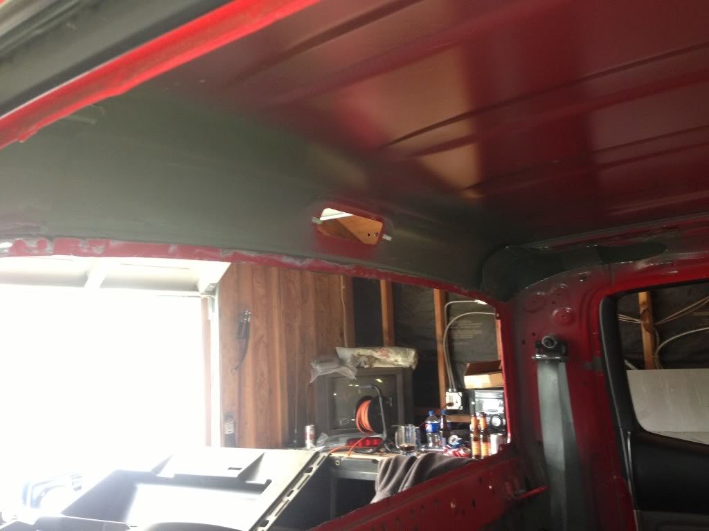

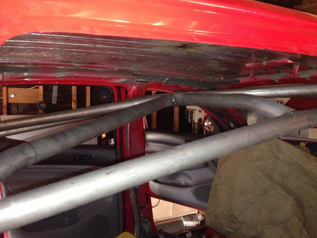

    Roof bar in. Got it nice and tight all the way across. These cabs are a pain to cage because they are so rounded. Also started to do some sound insulation.
    41D5E7FA-9FD1-41C0-801E-D858C045D34C-100_06e2b56a8307e5feceda186b4668e62df9ccf54e.jpg
    More roof tubes
    C93943A6-0303-47FC-B93B-67AC5E526274-126_816a9eb55106b9b68a7181b5c36b702cdc747639.jpg
    713C5BF2-1965-4732-8A90-95F79A965D4E-126_8dbe26445c8baf1f558347fde7fac86e5b175a83.jpg

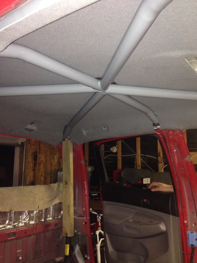

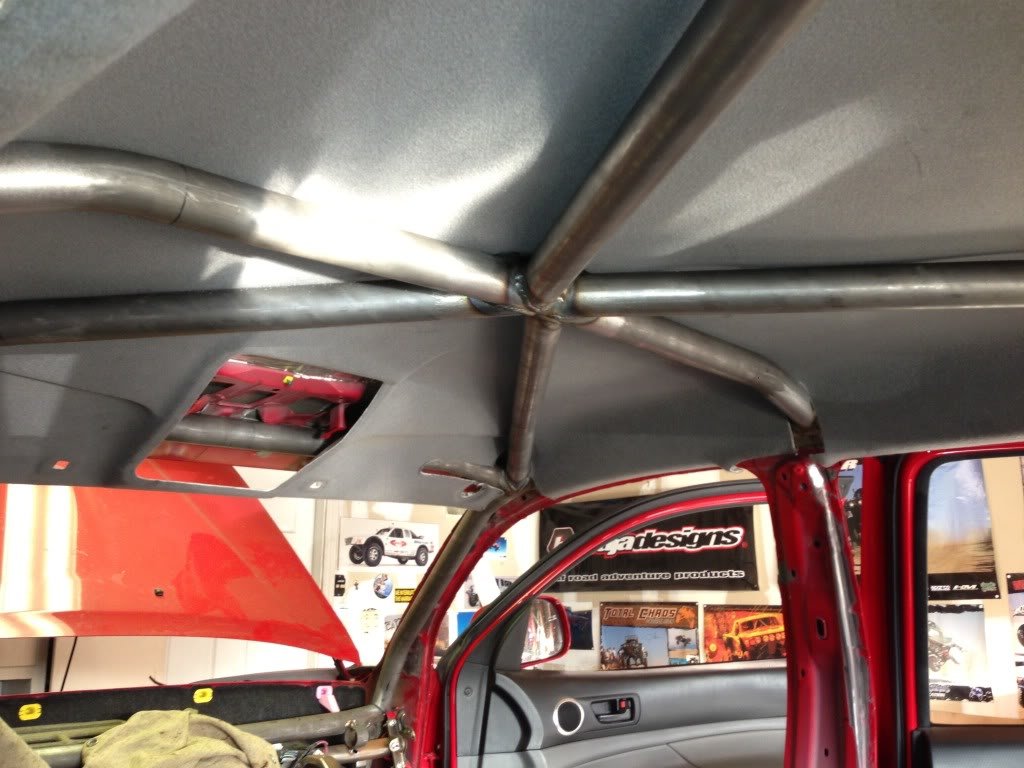

    Started fitting the headliner back in
    371DD806-51B8-46F8-BCE7-6510FC65E074-706_3700c3f581117dc4ea9a0d63644cbd15c6bad3d7.jpg
    CF566CB0-9C28-4BFD-8BE7-D5BD85266362-846_47ab6c59013b800bbcd4ef5011ca1da7be992270.jpg

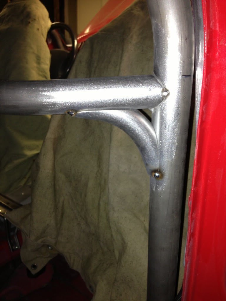

    B pillar harness bar gusset

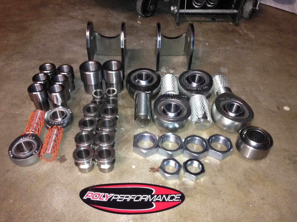

    Box full of goodies came in from the good guys at poly performance!
    6060D38E-0C10-4327-A374-46D2FF49875C-172_8e96763fafe179f7395b0dbb1226bb770b188437.jpg

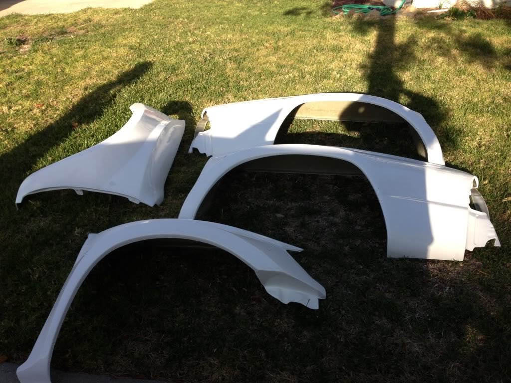

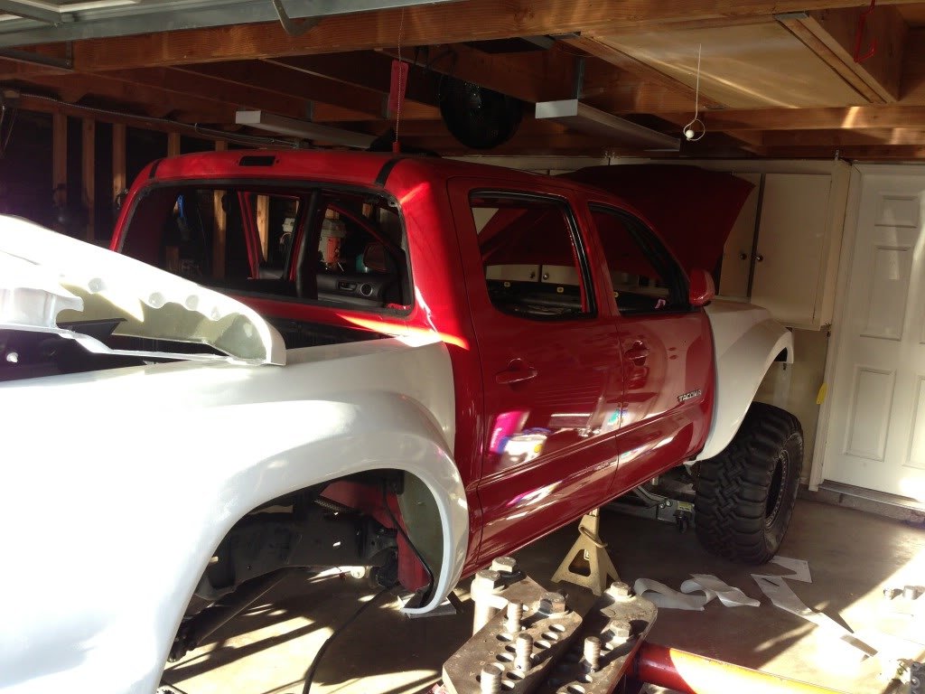

    Also got the glassworks fenders from my buddy at off road depot. Had zero issue getting them and only took a week.
    E541109D-E65C-4E0D-BDE8-72FE10B9C952-140_ef0f5434d9c2d10d035dc74840f2727961e7c4d0.jpg
    2879A8E7-4111-40B1-AF32-826A1505240C-140_f93fd5ce430ae5d25bc2594c515c64b57e55e4bd.jpg
