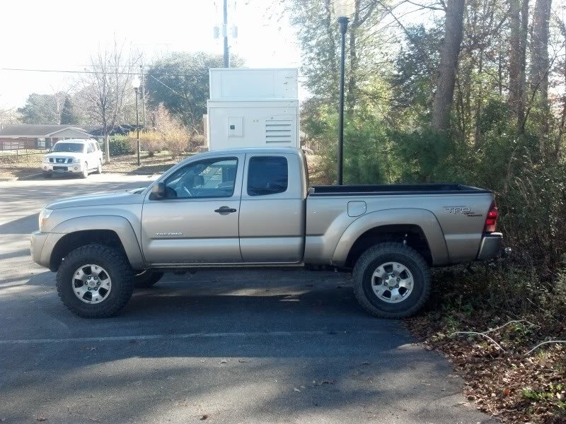

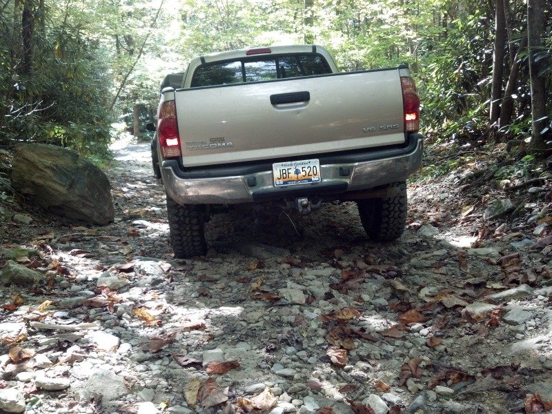

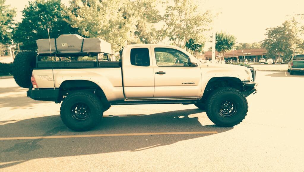

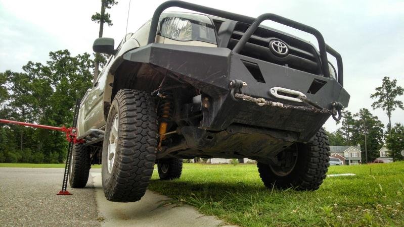

    Current pics, or at least fairly current:
    06SW4XWYFZcIGWHej2X5T_KLk5LtZUIwrNhQBswu_4cbfd10b279fee11a1487ff02a62be8af0ce7738.jpg
    37s
    a10b49441d81c0370cfe9359b8a4be01_4c5fd4ac0b9c9a85aa18ecc31d4a6488685d11fc.jpg6cfd19618ea54ebc2bd9d09efc894043_d4b876a6cd43ac1ac2068e63f65ee9edc145fbdb.jpg
    33s
    Older

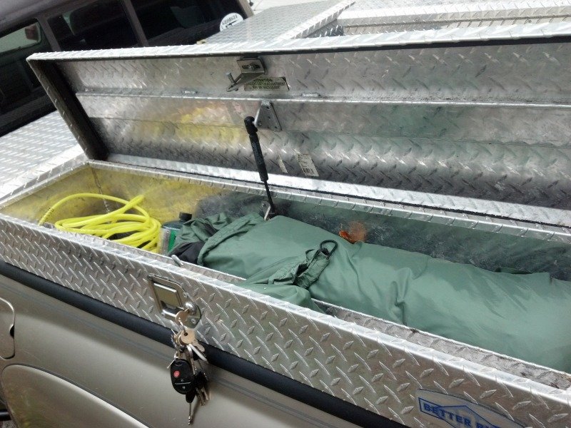

    Storage:
    Cross bed box
    Side boxed

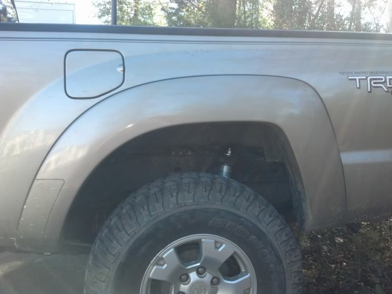

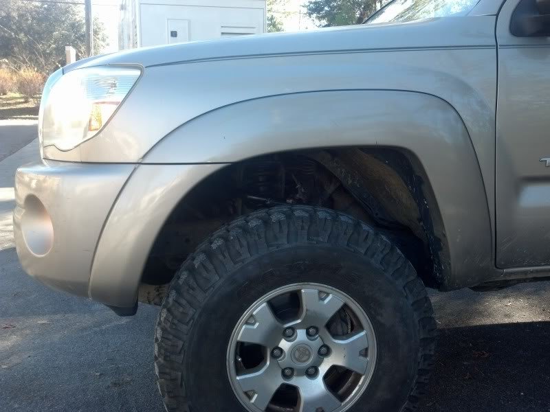

    To that end I started looking at storage options. At the same time I knew I would be carryingsome real weight so I ordered a set of OME 886 coils/struts , and Allpro Expo leaf pack with Fox shocks for therear. I made a mistake here and letsomeone else install it. DON’T DOTHAT. They fucked up half of theinstall, and it was a complete waste of money. At the same time I picked up this gem off of Craigslist inColumbia. I picked it up for $300 andbrought it home (2hr drive) ratchet strapped into the bed of my truck.
    Picture after lift (looked taller in person I swear) :

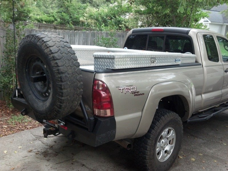

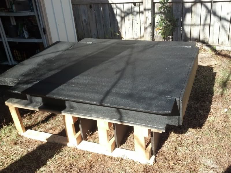

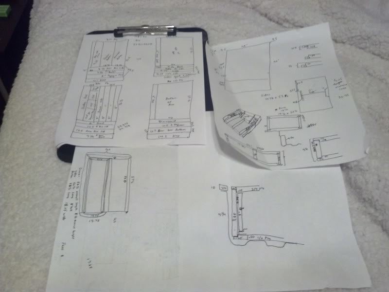

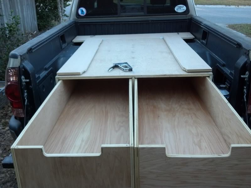

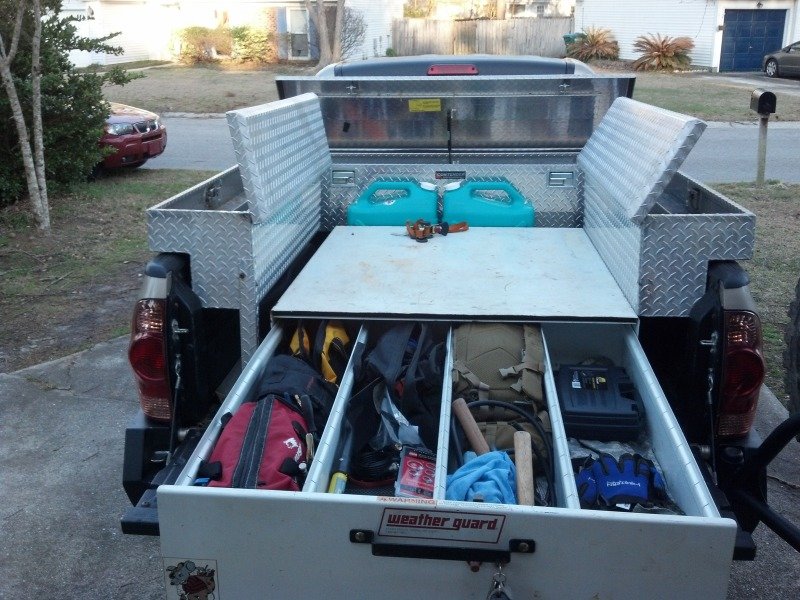

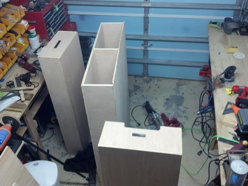

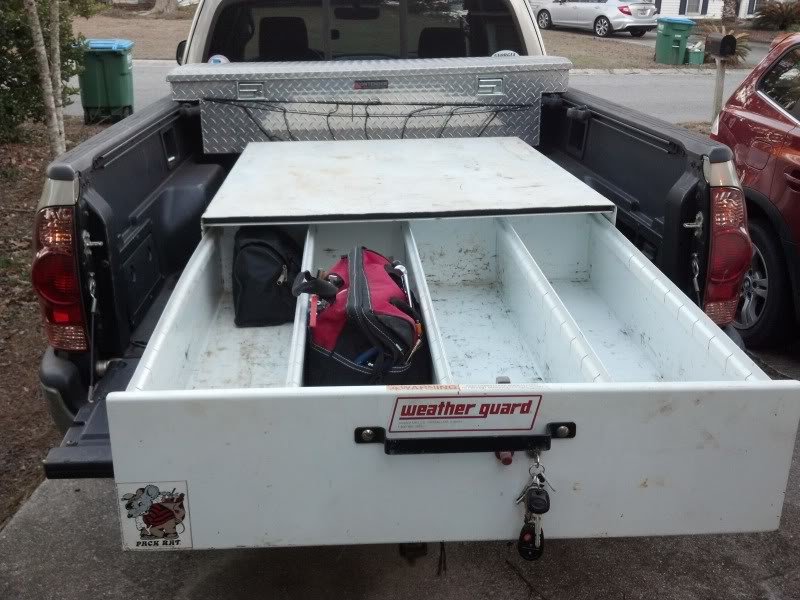

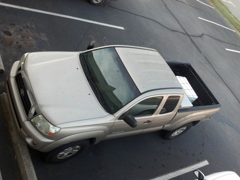

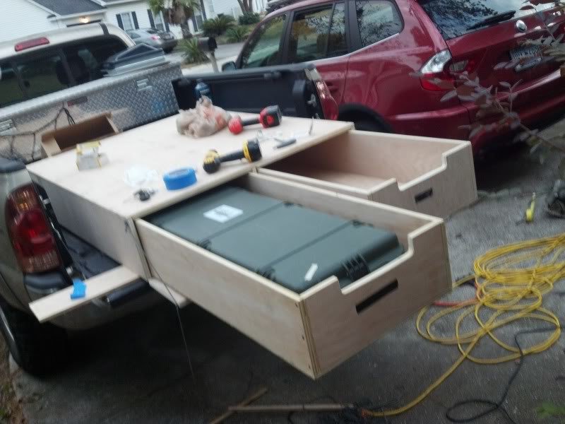

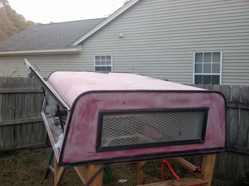

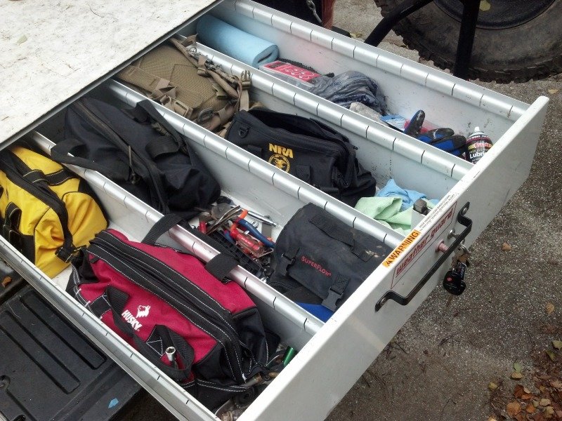

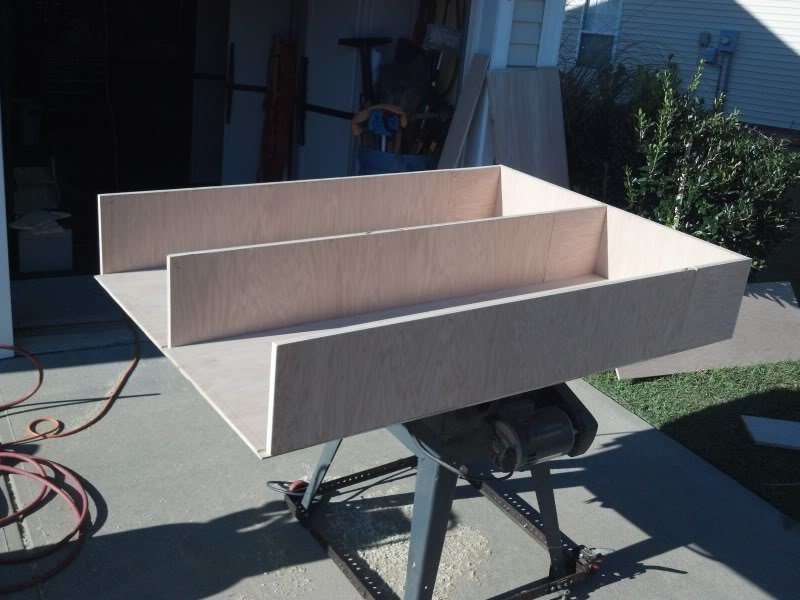

    At the same time I decided I need a drawer system to keepthings in the bed of my truck. Beingthat I wasn’t going to spend $2-3k on a truck vault and I consider myselfmildly handy I decided to build my own. Laid everything out on paper one night and started building the next day:
    A trip to Lowes and a couple hundred bucks worth of lumberlater I had this:
    IMG_20131103_145720_929_zpsd7c54a40_0e3442d7829ef9dceb00f445b9029bb5981c8445.jpgIMG_20131105_205436_004_zps44b23bbf_08c4c4b10d0344b7c9bf3ff52c15b1b2af114972.jpg

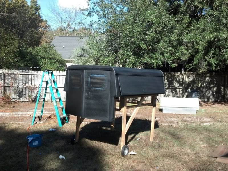

    Prepped the cap to spray while I was at it and order Upol's Raptor liner to coat both with
    Wasn't real happy with how either can out. Maybe it was the product, the gun or my technique but it all came out with stripes:
    IMG_20131116_121313_437_zpsd1509bcf_170ff1c295ba4e06f64e72476d8b5bf67ef799ab.jpgIMG_20131116_121255_061_zps0850c12d_7cef5d6507c157a55cc74c1003d13ee2812130d1.jpg
    There were two bigger problems though. One, the cap required that I take off my tailgate. I realized during the project that I love my tailgate. I use it as a workbench constantly and that simple wouldn't do. Worse that that the plywood I used for the box was NOT exterior grade, despite what Lowes told me, and it started to delaminate in just a few weeks. I didn't get pics of the delamination but I did of the drawers molding. So the box got shoved into my backyard, $400+ down the drain and the cap got sold. I was back to square 1 on storage.
    Moldy drawer after just 2 weeks:IMG_20131222_173040_563_zps957b769e_a34bcba85118066ad8371b14a2465b291808b398.jpg.
    So I got back on Craigslist and found THIS. No mIMG_20140310_183342_384_zpsd60414e4_2d8cd712549864b813e24d2d7e7b03857d4ac18e.jpgore water problems here $250 score:
    Then these:
    Loading up for a trip to NC
  8. Jul 13, 2014 at 7:16 AM

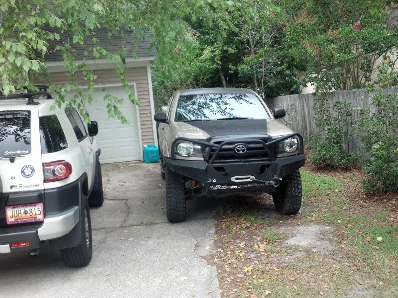

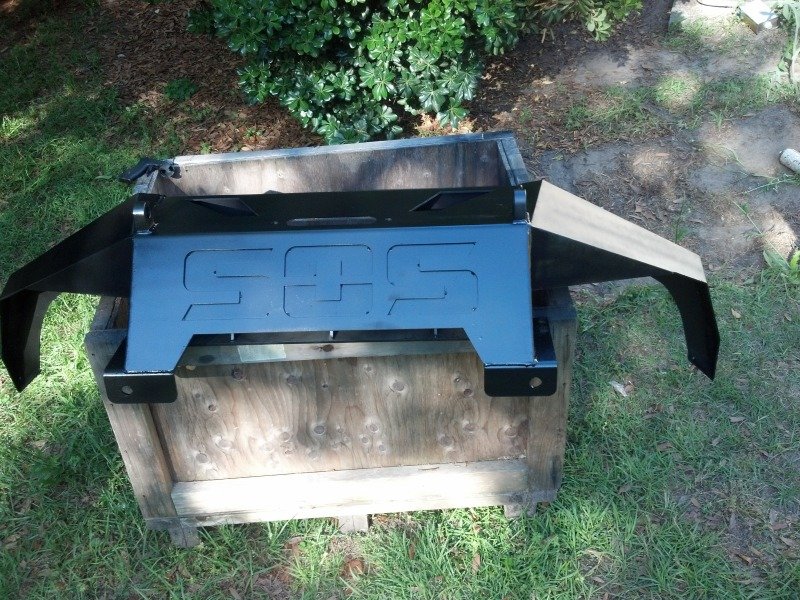

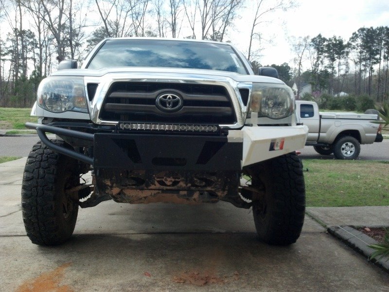

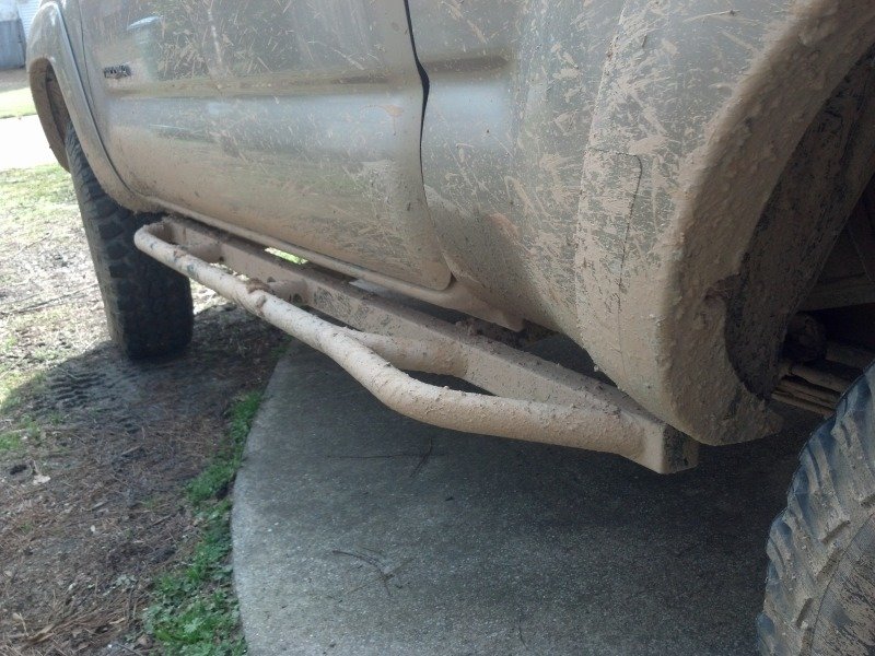

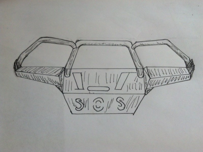

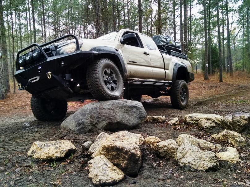

    Helped Eddy design a front bumper:
    Then got one of my own:
    along with this:
    Finally got the winch installed after a major PITA of relocating the contactor:
    Now I'm back to square one on storage. I need to add a rack, I have an RTT on order. And the drawer has to go as it weighs 383 EMPTY and I'm losing 2" of lift in the rear with it. The side boxes wont work with the rack. So ALL the stuff has to find a new home:
    So that's were I am now. How do I carry all the stuff I need, plus the rack and RTT without adding too much weight. and keeping the water out.
    I have ideas, but I'm open to suggestions. More to follow.

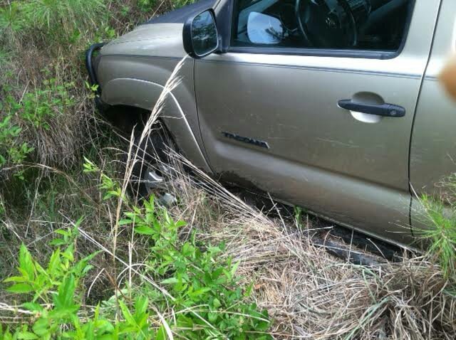

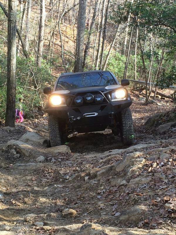

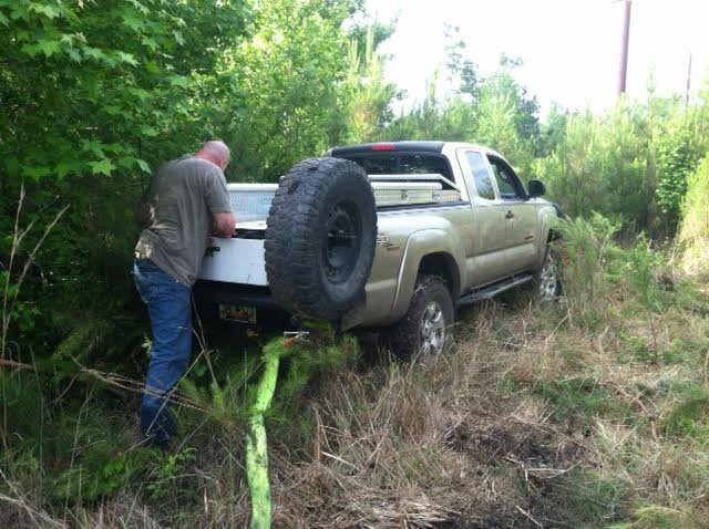

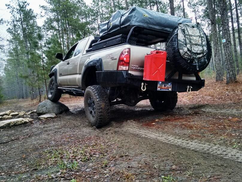

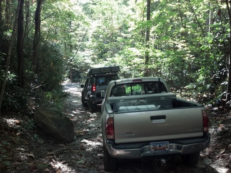

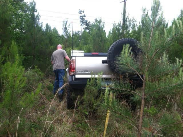

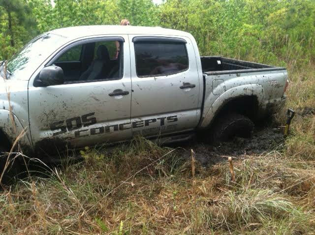

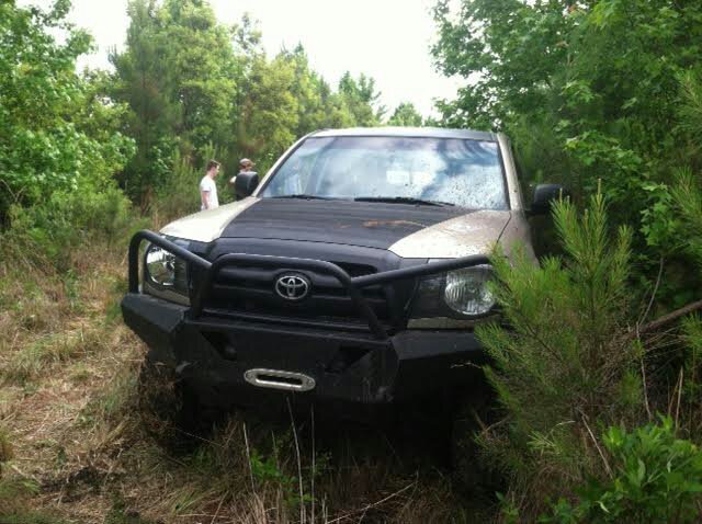

    Random pics including a stuck moment. 2eny9adu_9c28b3a7c0c50a44fb574b68ed2c2afc2772fb47.jpgbuvy6aju_25d1b82986a85d76731c5464cca83d23bab99432.jpgeda7y8ev_454e3a3a3747bc5d7a8baaa7a4d119c724b78e84.jpg8y9apagu_b9916c2c9eaa87fb48e243deb42e8bc53fbf1d1a.jpg5y3a4e2a_aa8173b4ebba90d3c2b16b5091f66b07d2378645.jpgy8a9e7eh_87d74e5b325e2f83a6aafada2c0ae9b11108b400.jpgva2y8ehe_d3b741f43d9c0b5d2676d91b212f7d94988945ea.jpg

    :popcorn: Only thing i can think of to make the spray on liner have those stripes is the way you sprayed it, going from left to right made it sit like shingles on top of each other :confused:

    Probably right. It was so sunny I could barely see my overlap with the glare
